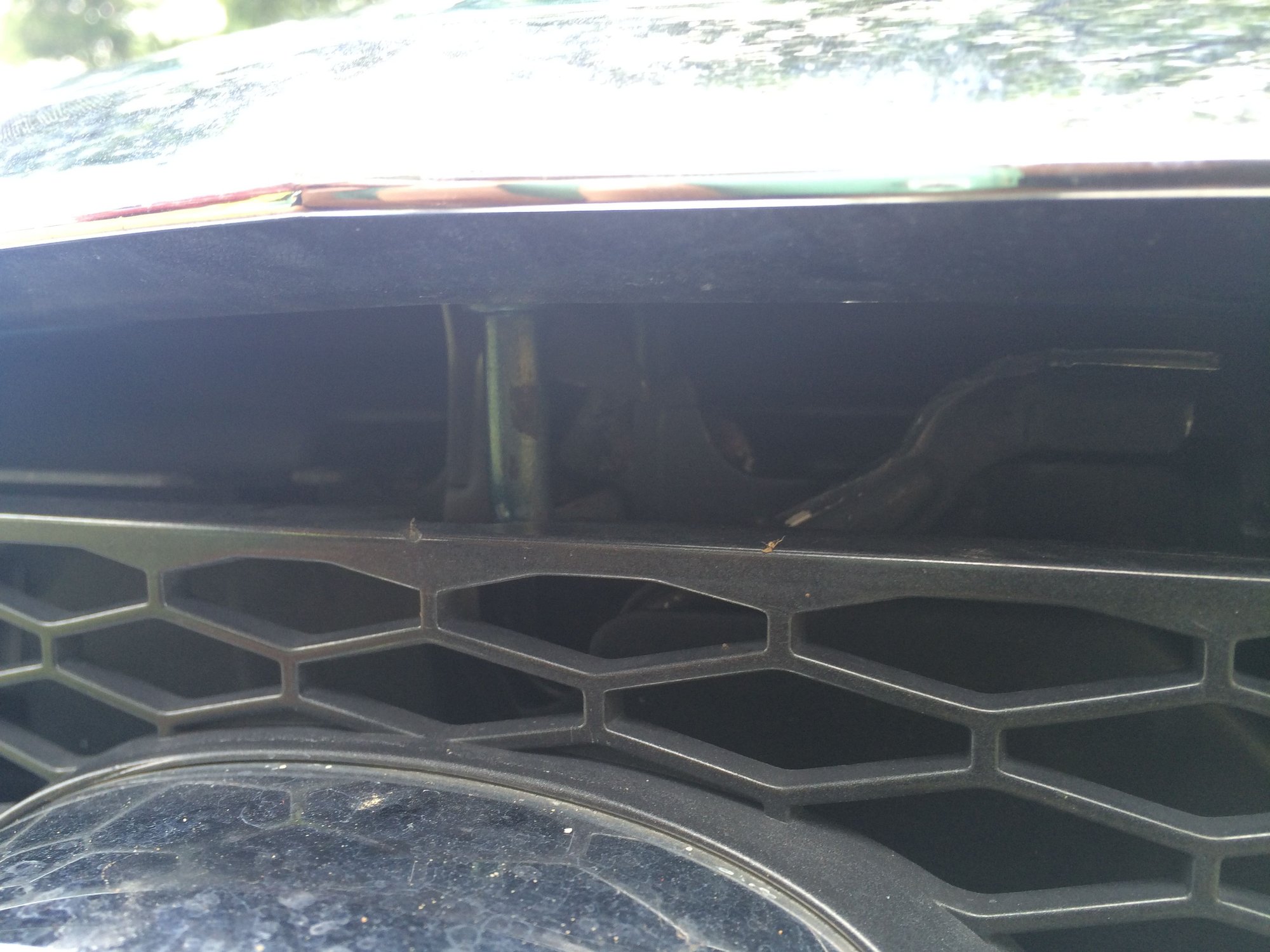

@justnspace I didn't hit anything and had no work down on it. I opened it yesterday to refill some windshield washer fluid and the hinges didn't want to lock. I hope these pics help.

Look down at the latch, and you should see the wire portion of the hood cable, with a little ball on the end. There's probably a 1" area of cable from the end to an arm on the latch. Use a screwdriver to pry the arm to your left as you face the car until it touches the ball. It shouldn't take a lot of effort. If this works try working some penetrant or lube into the latch. This is what I see most of the time.
Old Oct 7, 2015 | 11:02 AM
Posts: 48,310
the latch looks a little bent forward to me is it not???
i second the pentrating lube (PB blaster) NOT WD-40

I was able to fix it! thanks for the help.
It does look a bit bent but the main problem was fixed. Ill get it checked later. Even though the latch is working now, should I still put the PB blaster?
