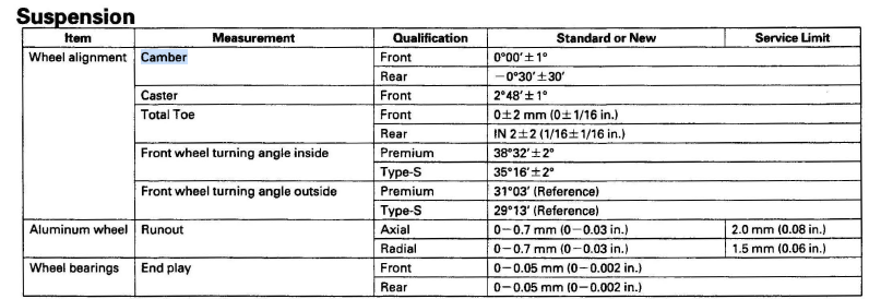

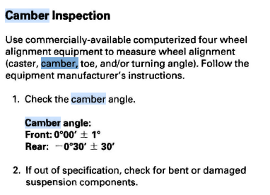

From the manual:
Your car looks great.

Originally Posted by Jon M
From the manual:
i didnt ask for somthing out of the manual or camber inspection. I asked if a - 2 degree camber will be good to clear the fenders
