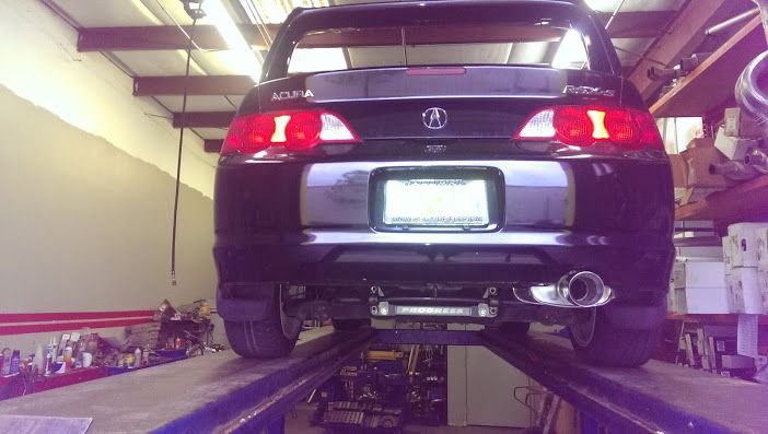

If it was me, I want the best bang for the buck. With that, I'd do straight pipes as the others mentioned. If you want shiny, look into an ATLP exhaust.
I just did a custom exhaust for my RSX and saved hundreds of dollars with the same performance if not better than the shiny ones
Here is my custom 2.5" catback exhaust I just put on my RSX (Flowmaster HP2 as resonator and Dynomax super turbo muffler in the rear)
