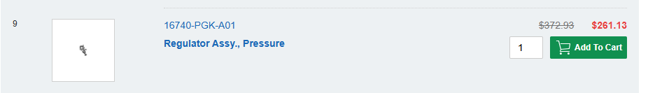

Old Apr 27, 2025 | 07:11 AM
Posts: 6,871
Likes: 2,202
Originally Posted by RTH
Yes, it says 2001+TL in the ad below, but the details from the original listing claimed it worked for 2000+TLs. It did thread in just fine.
The OEM fitment indicates compatibility with the 2000 TL for 16740-PGK-A01, though, the price is shameful.
