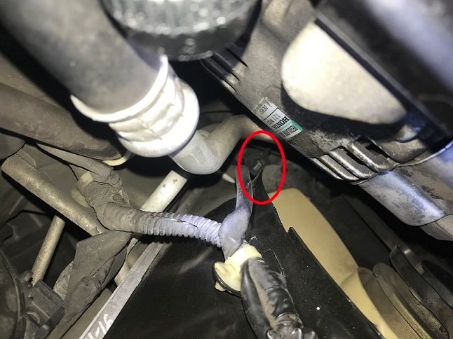

Well don't think it's the fan, but Zeta is on the scent!! Here's my '01 with the fan connection and bundles. Can't see over enough to tell on yours. However, like Zeta said, it you look down along the fan shroud, you should see the small connector that, I believe, goes to the AC clutch. So does your AC work?
Top of fan
Note small connector circled in red

Going to check the ac, but first this is the inside of the connector
Inside of connector

Nope ac doesn't work and got a scan tool - P1486 - cooling system malfunction

It's the A/C Compressor connector. It won't fix your overheating problem, but you won't have A/C without it.

After reviewing the photo kindly provided and spending an hour with a flashlight I figured it out. The mechanic broke the other end of the connector and that's why I could find it anywhere, found a random green wire tucked away. So this car won't have ac without someone fixing the connector. Overheating issue I realize the gauge doesn't work and no data in the Obd2 read out so they definitely screwed something up. Thanks everyone for helping me out with this mystery.
