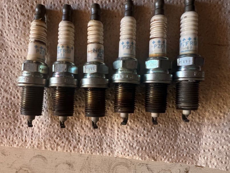

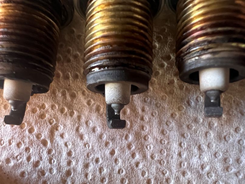

Some may have seen my recent thread about misfires. While the new coil took care of it, I noted the 2 plugs I took out (#5-6) looked a bit toasted and said I would replace them soon.
Well today was the day. No real drama here. Did have to move the PS hose over a bit to get to one of them. Plugs do look past their prime. Checking over the records I got from the previous owner (a close relative), I could only find a reference to spark plugs changed way back in 2009 and approx 120K-ish miles ago. Considering they were in there this long, I was surprised they didn't look too terrible and still sparked OK. After checking the FSM, the replacement interval is 105K miles.
Got my replacements from Rockauto (more about this at the end). Checked the gaps, right on spec at .040" Installed with no anti-seize (NGK says no, while FSM says yes). Torqued the plugs, popped on the coils, remount the PS hose, and she purrs like a kitten.
Some pics for your enjoyment.
Cyl #6- the one with the misfire
All 6 plugs in order (1,2,3,4,5,6) from left to right
Closeup of 3
