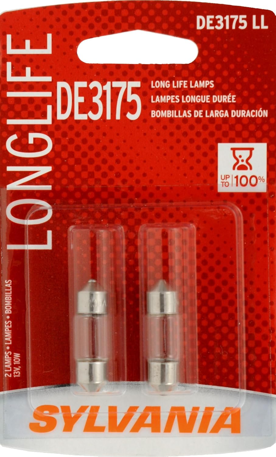

I found the replacement bulb code online (DE3175) and bought the Sylvania brand, but it doesn't fit properly. It's a bit short and a small bump shifts the bulb off the contacts so it almost never works.

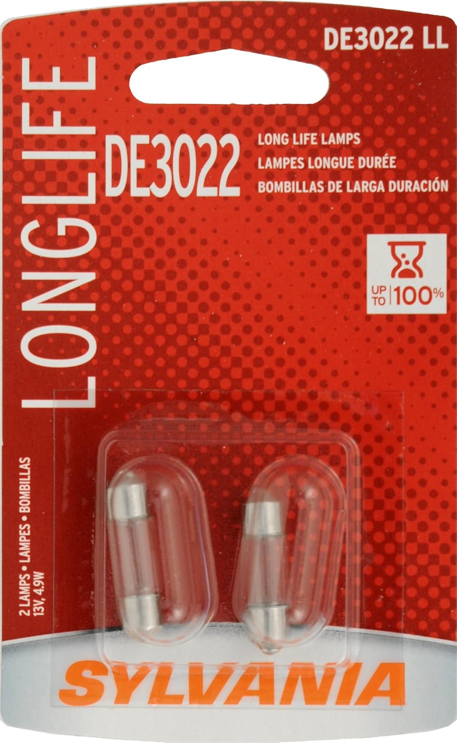

I found another one that looks similar but looks longer and might fit (DE3022), have any of you tried this or had similar problem?

There are a couple of sizes with those bulbs I think both of those are 29mm where's the dome light is 32mm
