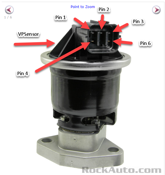

There’s a second part to the diagnostic test where you connect battery voltage to a couple of pins on the EGR valve. My understanding is…This forces the EGR valve to be open at idle which would allow airflow through the EGR passage and would cause a rough idle; if, indeed, the passage was unobstructed, and there was adequate airflow.
if it’s obstructed, the egr valve will have no effect and idle will be normal.

The EGR vale does have ability to provide feedback on it's position (how open vs how closed it is). if it fails to report back this information then there would be another error P1498.
Domenic, theres another test (other than resetting the PCM and decelerating from 55 mph to observe the EGR doing it's job; it's in the part below; did you give that a shot?
everything I am reading so far continues to point to the EGR passage being obstructed in some way.

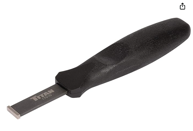

Not telling you to do this for your EGR valve but the best gasket scraper I have had is this one.
Amazon Amazon
One method of removing old gaskets are to let it soak in wd-40 and then use a appropriate hammer to tap on it. What I mean by appropriate is the metal of the hammer has to be softer than the metal that the gasket material is stuck on; this is VERY important as a denser metal will deform the mating surface. I,e if the gasket is stuck to steel you can use copper, brass, or aluminum but not steel. You can also use a hard plastic hammer. Of course, I am referring to the head of the hammer not the handle. After using the hammer (if needed) you can carefully use a scrapper or razor blade. Do not dig into the metal surface.

Dom, did you try the troubleshooting above in post 46 where you force the EGR open? That will tell you if your port is clogged still...clogged port: no rough idle at start with egr forced open, unclogged--> rough at idle with egr forced open.
regarding post 46
Thank you! Do I need a special tool? What would that tool be? Sorry for my ignorance....

hi, there are a few ways you can do it...if you don't want to buy tools, use a jumper wire or the appropriate tool would be an automotive circuit tester.

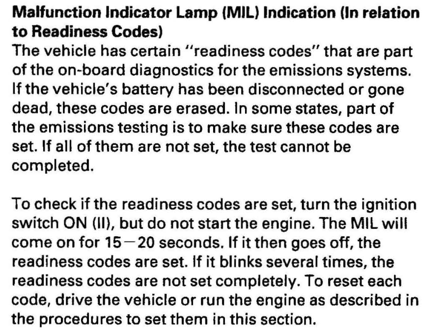

I think he is referring to the Smog Check Station? They willcheck the PCM for smog readiness.

5hank you! I will purchase the auto circuit tester and diagnose as you instruvted. Easy instructions, even for me.

Whitetiger5, When you say they will test the PCM for smog readiness, what does that mean? Do you know what they are looking for and how the check is done? My understanding is once the code is cleared there is no permanent storage of codes. I am confused on how they find a problem if the codes are gone.

If that port is still clogged, I need to get my hands on one of these!!

Hi Jon, I was referring to the feature where the PCM needs to operate first in certain conditions before it can confirm that it is "ready." Typically happens when the battery is disconnected for long periods of time, or whenever DTC's are cleared.
Precautions to prevent someone from resetting the PCM just before the get the car smogged.
It doesn't say there was a P0401, but more so that it hasn't been operated enough to confirm that there isn't a problem so don't test yet.

Something like?
Dom...my apologies. I was thinking of the wrong name. Test Probe is what you are looking for. it's close to the top item. allows you to connect one set of connections to the battery, and the other set to the component you are testing, with safety (the test probe has internals to protect against high current/shorting where a plain old jumper wire does not).
They can get pricey, but honestly I can count on my hand how many times I've needed to use one so the item on the top there is a great choice.

Thank you. If I read the instructions correctly, I will need to connect test probe to positive to one of the power supply pins. And do the same for negative to other power supply pin?
