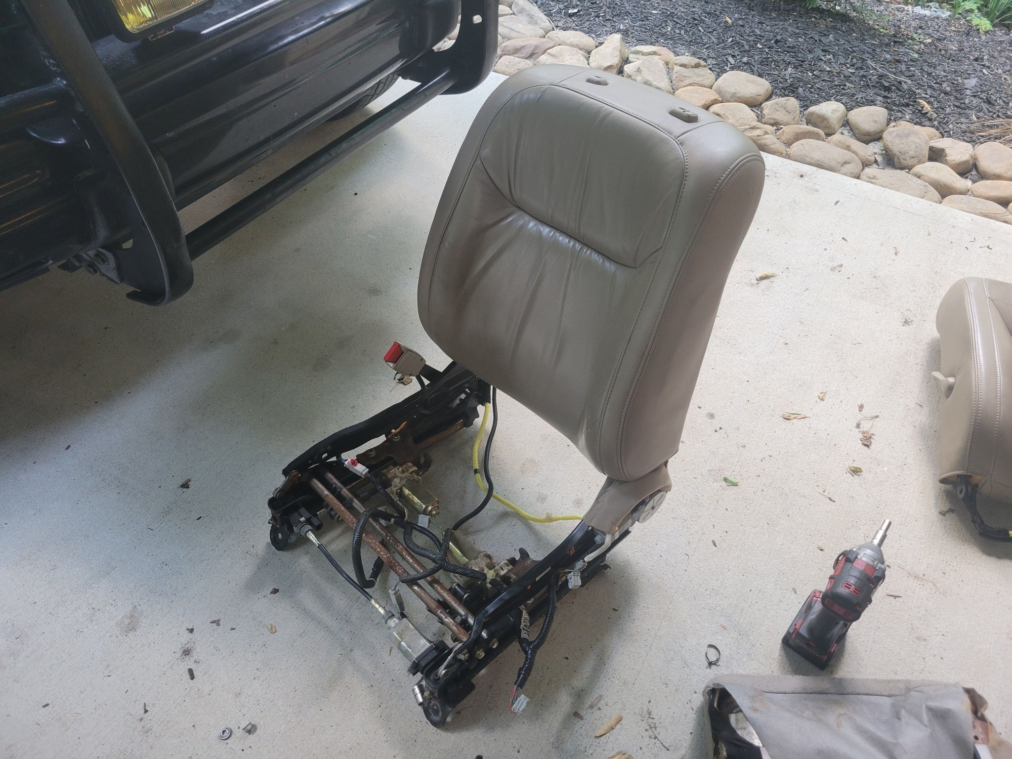

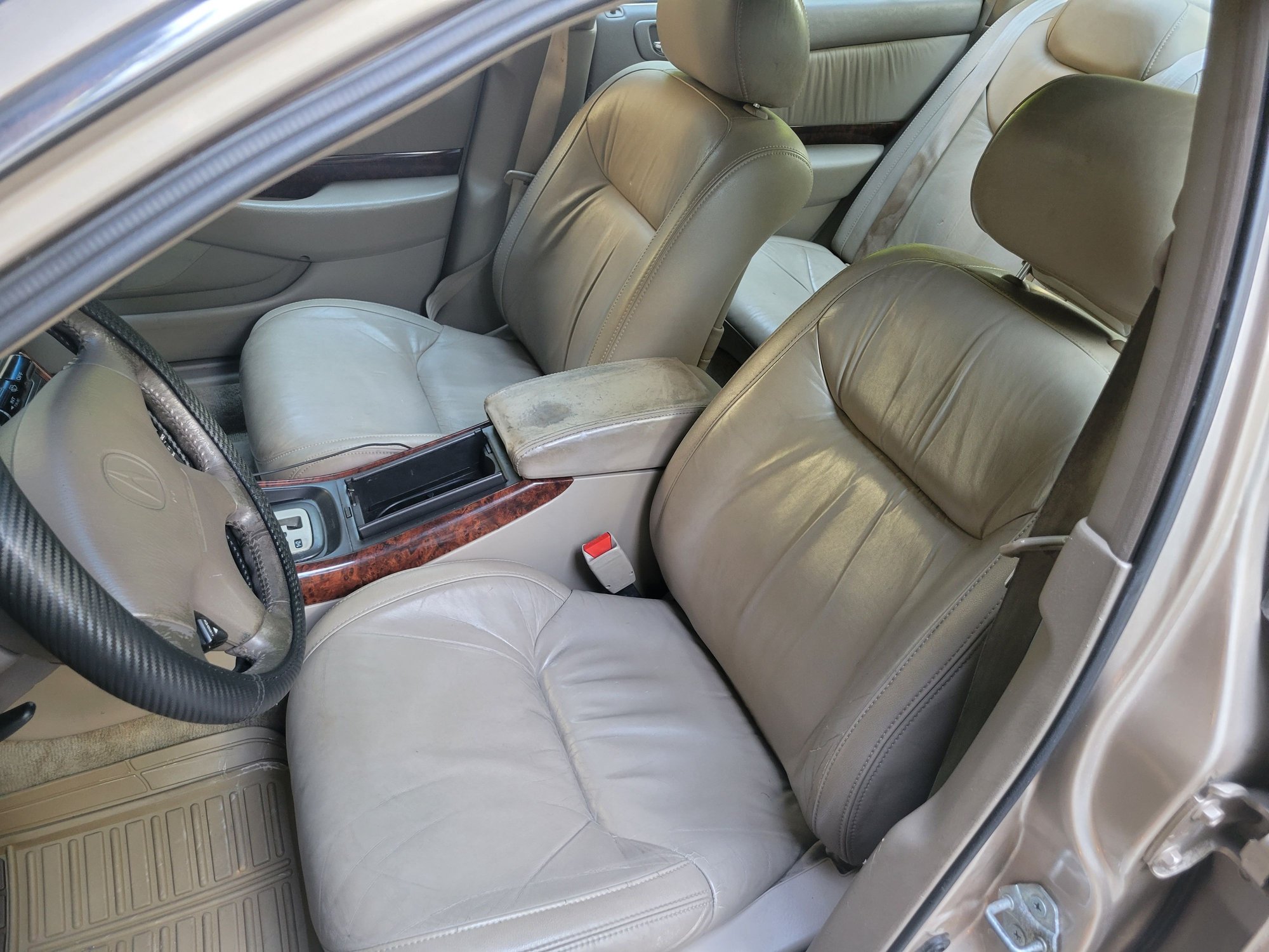

1. Here's what my seat looks like to start. Mine is a 2000, but the seat I sourced is from a 2003. As a result, the main harness plug is different.

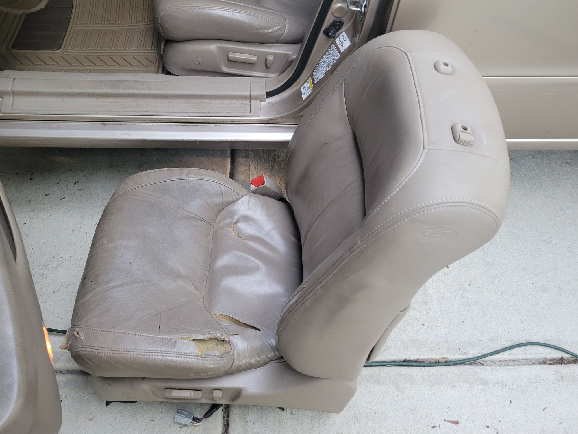

2. Here is a look at what you are after. The upper and lower seat cushions are identical, including the wiring in each. You will have two connectors in the upper, two connectors in the lower.

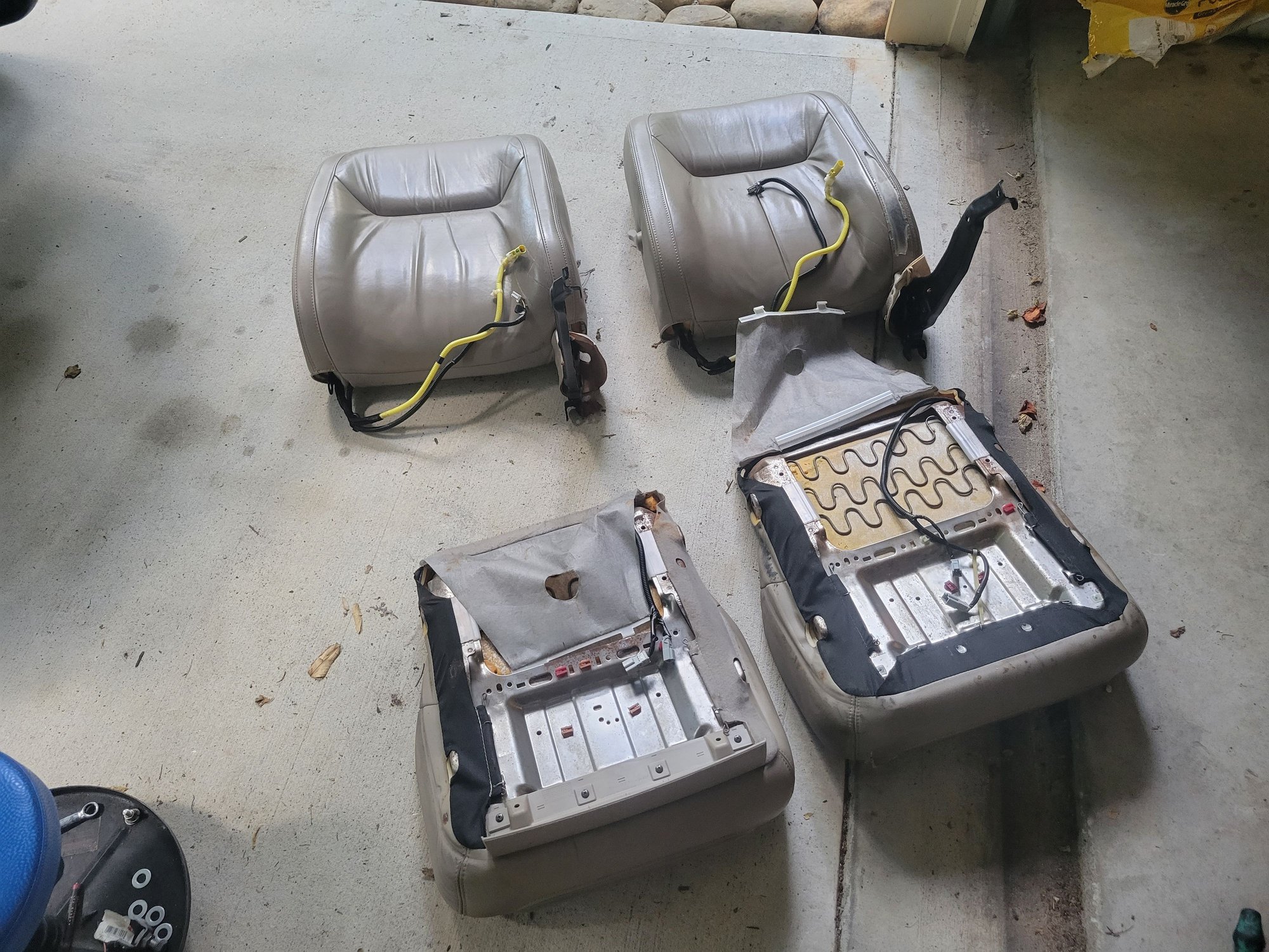

3. To do this swap, you will keep your original base, but replace the upper and lower cushions and their associated wiring. It's completely plug-and-play. There are two full seats at the start, one that will donate a base and one that will donate cushions. I will call them BASE DONOR and CUSHION DONOR to differentiate.
a) Start by removing all of the plastic on both seats by taking out all of the phillips head screws. Then remove the lower cushion on both. The lower cushion is held on by 4 14mm bolts on either side of the base. Unplug any wires that prevent the cushion from being removed. (not pictured, it's easy)
b) Remove the upper of both seats. On the inner side (side closest to the center console), there is a motor for moving the backrest. Remove the 3 screws that secure it and remove the motor (phillips or 8mm, either works). Below that is a long 14mm bolt. Remove it. Further down is a 12mm bolt that will need to be removed. On the outer side (side closest to the door), there is one 12mm nut. Remove it. Unplug any wires that prevent the cushion from being removed. (pictured below)

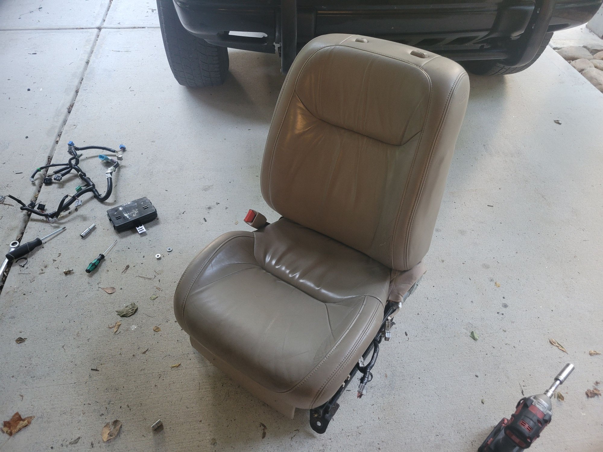

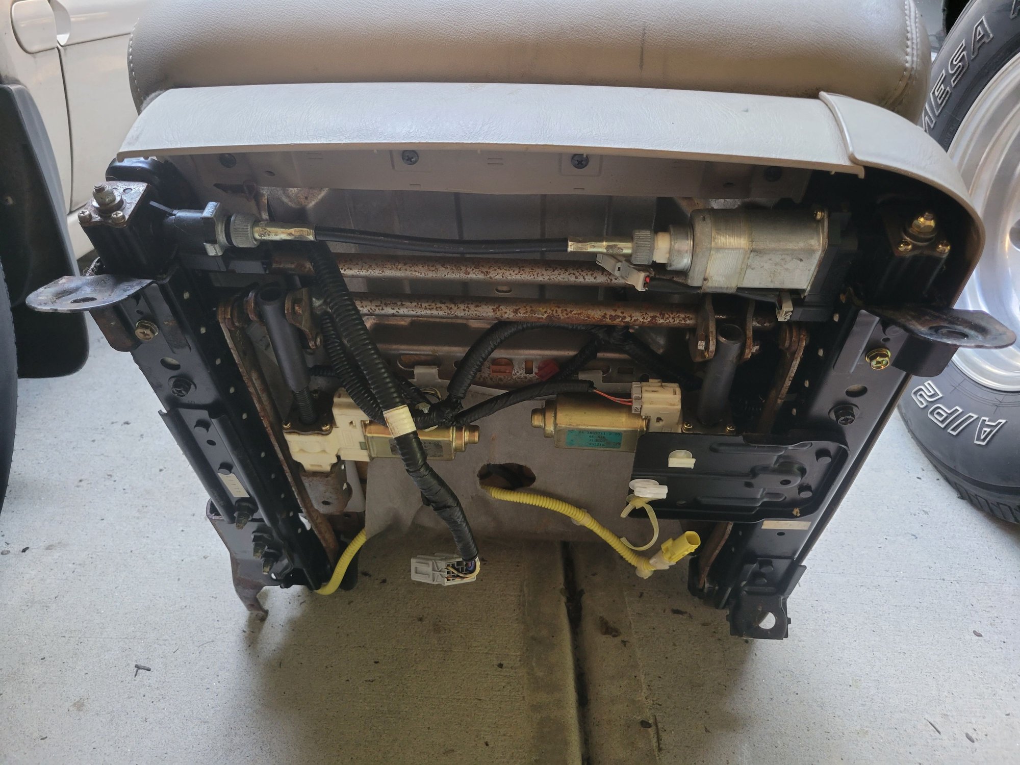

4. Each base should look like this. Keep the wiring harnesses in each respective seat. The upper cushion and lower cushion from the cushion donor should each have two plugs.

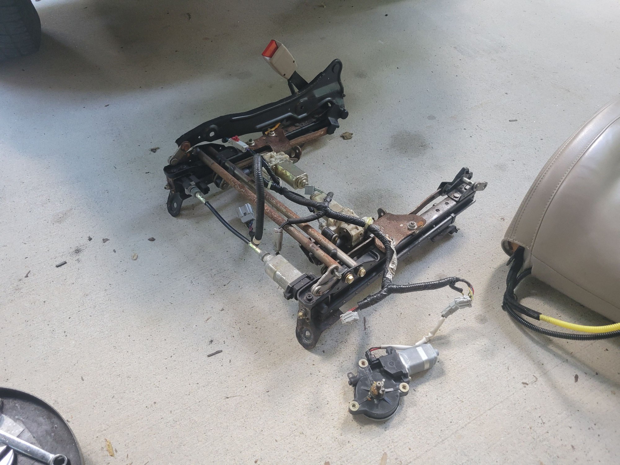

5. At this point, you can swap any part from the cushion donor to the base donor. The following can be swapped and will be compatible for either seat type: headrest, plastic covers, seat control panel with switches, seat buckle, lower and upper cushion. You cannot swap the forward-backward motors on the seat rails, but you can swap the back adjustment motor. You cannot swap the memory module between seats. Start by attaching the upper seat cushion to the base donor. Secure it with the long 14mm bolt, the 12mm bolt, and the 12mm nut. Reattach the back rest motor.

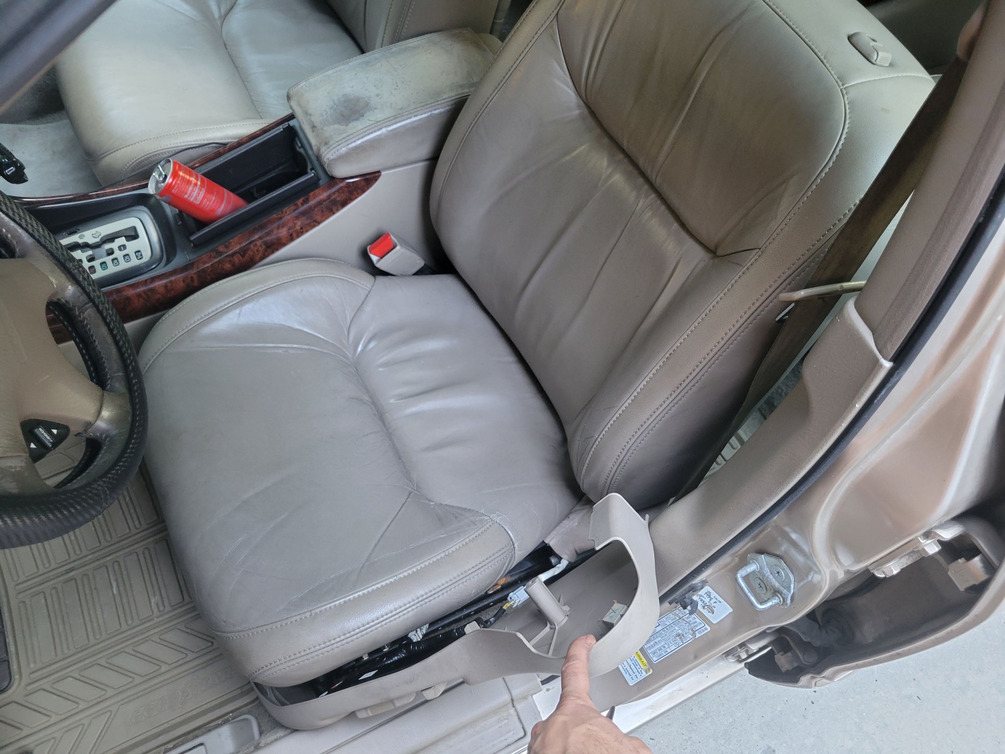

8. Reattach all of the plastic panels. Wait to put the headrest in until the seat is in the car. Underneath, make sure all of the cables are held out of the way of the seat rails. This can be done with zip ties or by bundling the wires under the cloth cover (as pictured). You will have two connectors hanging out, one yellow one for the airbag and one larger one for the main harness (blue connector for newer TL, gray connector for older TL).
