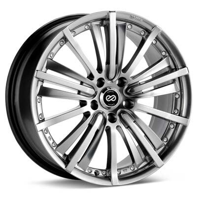

I came across a set of wheels that I actually want to buy. Finally!!
Now I am unsure if the rim would fit.
This is the rim
The specs
Offset: 40mm
Backspacing: 6.33"
Bolt Pattern: 5-120
This is specs for a BMW 3 series
Everything looks similar for the Acura RL
I looked at Gus rims and his offset is 35mm with the same bolt pattern.
Is there something I am missing?

What does the manufacturer say? You cannot tell from these specs alone. As you know, it is the unknown area behind the spokes that counts.
Get a fitment guarantee
Don't forget to get the hubcentric rings that take it from BMW size down to 64.1 mm

RL's have massive 4 piston calipers making rim choices dificult for one piece rims. One piece rims with "big lips" usually have the spokes pushed to far back that hit the caliper.
I dont think they are ugly, but I think Blazing likes them multispoke wheels.

Regardless of what car the wheels may be designed for, you need to pay attention, as you know, to that unknown area behind the spokes shown in yellow.
Knowing the backspacing is not enough information. Backspace is the distance from a wheel's mounting surface to the back edge of the wheel (usually measured in inches) and like offset (usually measured in millimeters) that does not give you the spacing available for the calipers.

Got the wheels redrilled to the 5X120 bolt patter
I found my solution for finding wheels for this car now lol

How were the lug seats handled also? or did you switch to different lug nuts? Curious to know since I have never done this. I have seen special washers that convert from 5x120 to 5x114, but they are typically designed for acorn (60 degree cone) to acorn seats.

Well im not sure how they redrill them. I remember when I picked up the wheel the whole was wider with a black lug inserted which measured the 5x120.
I am running no spacers and they bolt up right onto the car. For anyone in the tristate area the name of the shop is RPM in queens. They charge 30$ a wheel and take a few hours to do them. I got info from this shop from Ron Jon wheels and this is the shop they use. The offset is probably lower than the RL stock wheels because they stick out a tiny bit more than stock.
175 each?
Umm visit the black market and you can pick up an entire set for 200$.
I am using the same lugnuts.
