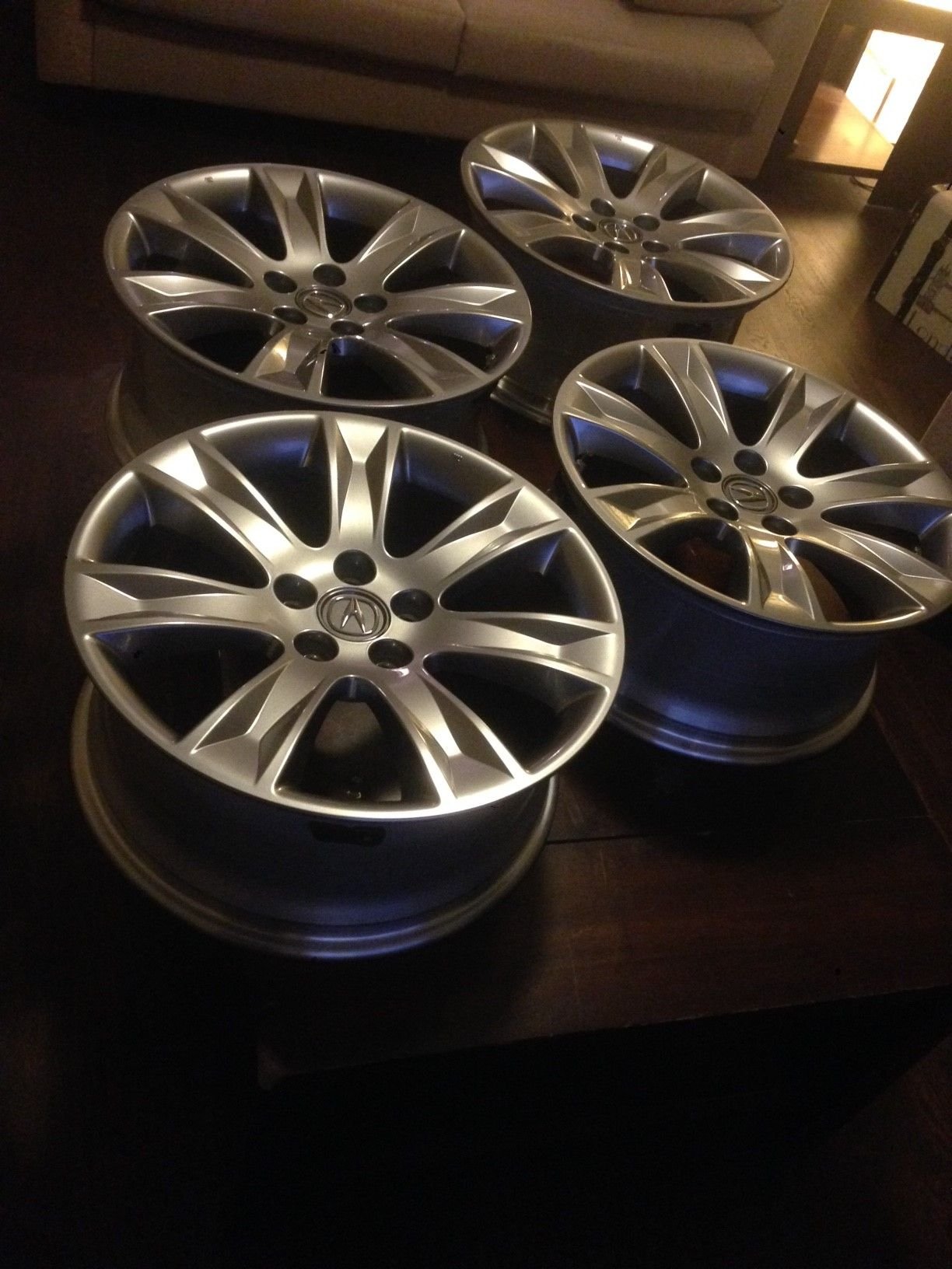

Been getting a few pm's about my wheel fitment and also the roof rack so I figure I'll make a slow build thread for my RL. This is my daily so I'm going for a clean, simple, modest look.
Picked up a set of Acura MDX Advance wheels (19x8.5 +45 and I'm running 245/40/19). I got a deal on these from craigslist. Guy was selling them after buying a new MDX and he had dealer install aftermarket wheels he bought, so these had 0 miles on them . These do not clear front calipers and I ran a 8mm spacer to fix that. You probably could run a 7mm but it would be really close. Also have a 12mm spacer in the back. Car sitting on oem shocks (non a-spec) with H&R springs. *FWIW: These wheels cannot use the RL wheel lug nuts, so I bought a set of MDX lug nut from Acura. Now that I'm running spacers, I also change out the wheel studs out for extended ones. Before changing to extended studs the front wheel with the 8mm spacer was only getting about 5 complete turns if I remember correctly. Thanks to JDMCRX for sourcing these studs (m14x1.5 x 55mm)

Did you have to cone out the inner side of the brake rotor stud holes like JDMCRX mentioned over in the TL thread?
I'm having my shop do basically the same wheel job as you did (with 10mm spacers all around) next Tuesday and am wondering if that is actually going to be a problem.
Yes you do have to drill them out, only a little bit though. It shouldnt be a problem for the shop to do.
