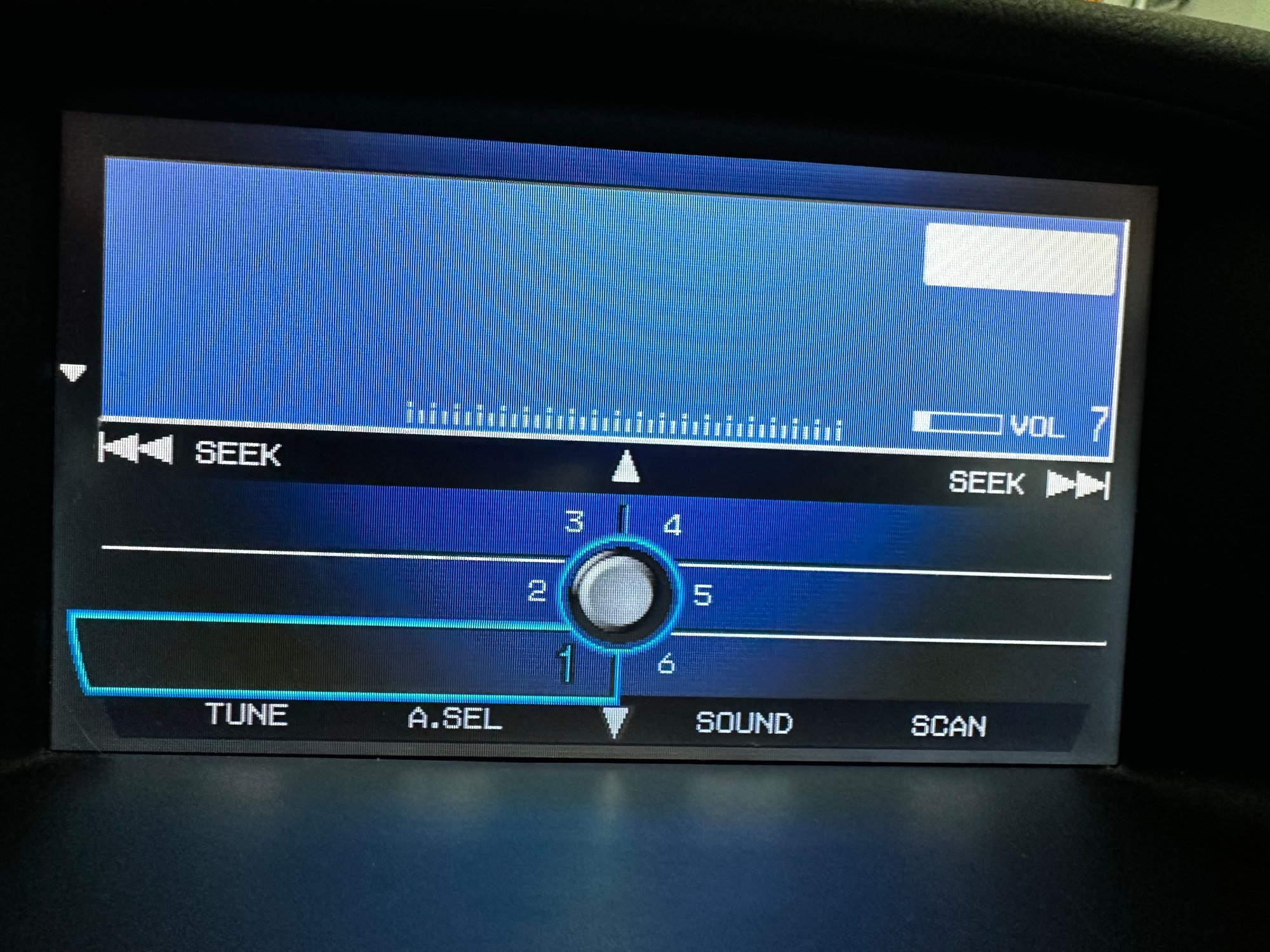

Just wanted to post an update. I found a radio for a 2010 and installed it. It was relatively easy to install and looks nice. Most everything functions as anticipated with a couple of notable exceptions.
  • The top display is garbled, which is a known issue. I’ll get a new one once I’m convinced everything else is working
  • I didn’t get the 2010 HFL module so BT audio streaming doesn’t work. I was pretty sure this would be the case, but thought it was worth a shot

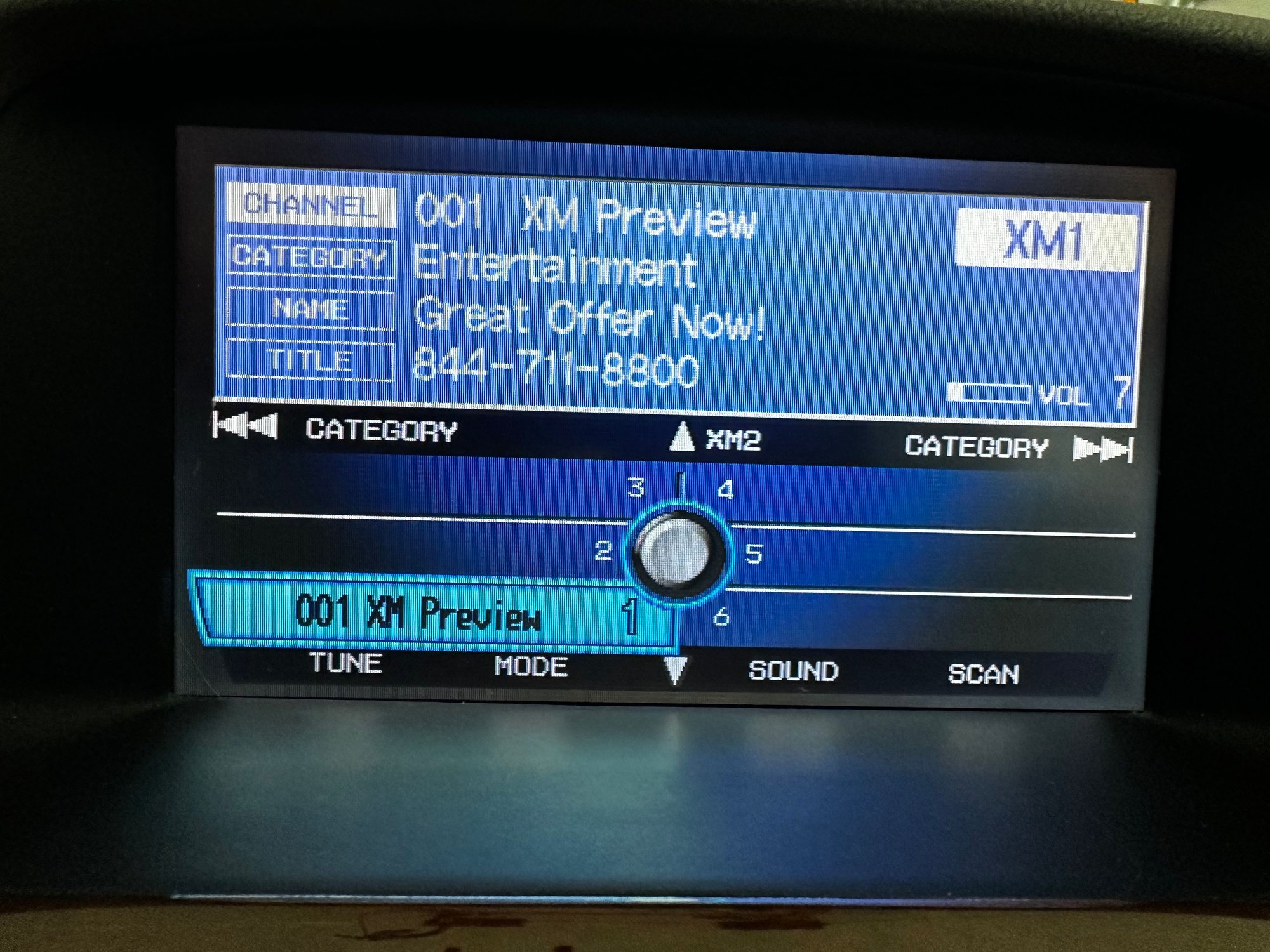

  • The biggest issue is on the main display when the radio is displayed. For some reason the frequency and present numbers don’t show up but the rest does. Interestingly the display works fine for XM. One odd thing is that there is a small triangle pointing downwards on the left side of the screen. I am at a loss on this one. Anyone have any ideas?
This is a picture of the new 2010 stereo installed. Everything works, but the frequency and preset labels don’t appear.
This is a picture of the new 2010 stereo installed and viewing XM. The display and preset labels work
