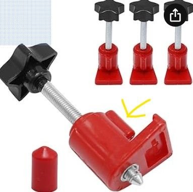

Was hoping there was one for the j35 since the cams are side by sideish...I just like having a visual guarantee that nothing's moving when working with timing belts...I think, without seeing inside the cover(aside from at the junkyard) the general application version being sold by Walmart and Amazon will likely work.
Saihisday Timing Locking Tool Kit Cam Lock Tool Camshaft Sprocket Clamp Kit Camshaft Gear Holder Dual Cam Clamp https://a.co/d/fba2ztr

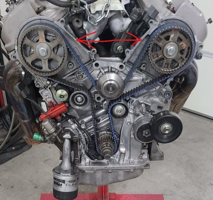

IF the bar (yellow) measures long enough to span the distance (red; second picture) with the TB removed, maybe; however, it may come up short.
kudos to @619rcr for his J35 pic above.

These may work individually if you can find a suitable place to securely attach them as the tooth (yellow) inserts / slides onto the cam gear groove, maybe?
