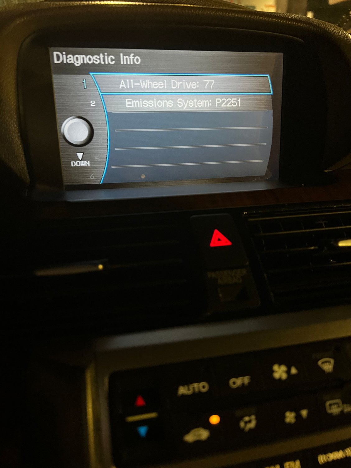

Got a check engine light P2251 and SH-AWD 77. When P2251and SH-AWD 77 comes on, it disabled the awd, turn off the engine then back on to clear it except the P2251. Based on the research its the oxygen sensor top rear engine. Inspected the wiring and no visible cut/open. Ordered part 36531-RCA-A02 for $210 includes shipping and taxes.

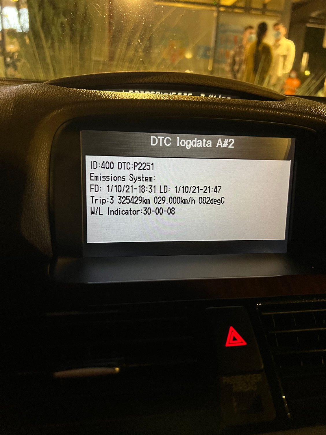

The code will be on ur navi messages.

The part arrived yesterday and i just installed it today and cleared the codes. If anyone of u will do this task, its a pain to removed the connector. U need to remove the connecter where it was attach to the engine first by using a flat head poking it side ways. Since the connector has been there for yrs u need the flat head to push the connector to unattach it.
not seeing any codes on the navi.
The SHAWD code went away, but the Check Emissions light is still there after taking a drive. Will give it more time.
