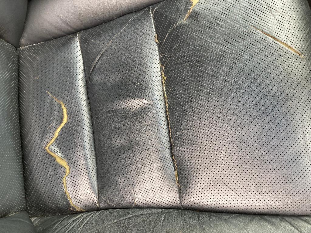

Hi, I have a silver 2005 KB1 imported from Japan. The leather on the bottom seat covers is quite brittle so much that my thumb went through one when I was leaning over getting something.
Have seen then 3 main replacement seat cover makers on EBay (Richmond, US Auto Seat Cover and US Auto Nation and was wondering if anyone had any recommendations, reviews or comparisons. Also enquired to The Seat Shop but they don't do the RL.
The seats in mine are Black leather and I was going to order a pair of the bottom covers. The seats are pretty mint apart from the tears but was wondering about fitment/color match etc of the different makes.
Going to invest in a Hog Ring crimp set.
Cheers
Andy

Everything is elementary simple, unscrew the seat, set the middle position, disconnect the connector with the ignition off and take out the entire seat, remove the plastic covers with the switches, disconnect and take out the cushin assembly. Disassemble the cushin separating the cover and change it with crimp set.
I think the quality of execution may differ from the same manufacturer, so read the review before buying the cover

Sad how the side panels stay so solid and plush and all that perforated leather deteriorates like crazy...mine looks about the same...how much were yours in USD?
