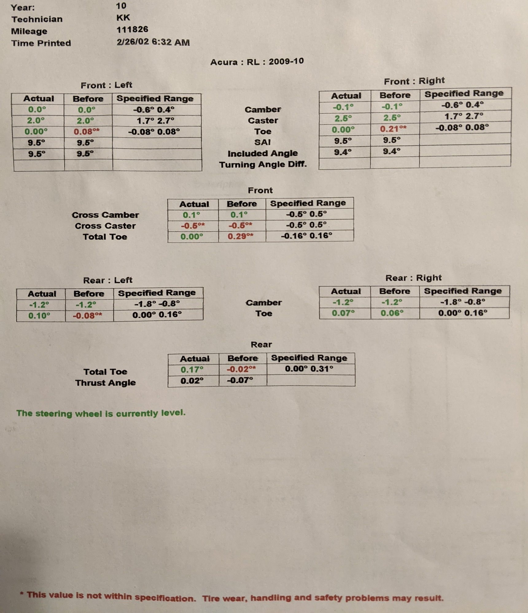

Few days ago I got an alignment done because I hit a curb at around 25 or more MPH and steering wheel became 1/4 of an inch off center to the left. The front left wheel did get some medium damage in the form of deep marks/scratches. Tire is fine, but I think left wheel some how got pushed back a bit. The tech said, he didn't see any damaged parts and the print out looks good. My take on this is that after hitting the curb, a control arm or another part could of just slightly bend. While waiting for the wheel repair shop to fix the wheel, I took some photos and videos of the left side. One thing I did notice the bushing that is on lower arm which has fork going through it, has some rip. Could of been from the damage or just age. I think to compensate the wheel setback, tech could of shifted the subframe. 1) In other words, if lower arm is slightly bent but not visible to naked eye, could that cause wheel setback? 2) OR maybe it is the lower fork that bent?
Link to the short video where I saw the rip at 30 sec mark or maybe it is by design: https://photos.app.goo.gl/xmY628YvgeUwyHuG6
Here is the alignment specs.

Guy who did the alignment said "I didn't see any bent components(at least not visually)". So my posted image is the print out of that. While the wheel was off, I took few videos of components, but there is nothing obvious that would indicate bent components. Here is a longer video: https://photos.app.goo.gl/bGxFQvpBdxV966nW9 In the first posted video link, at 30 second mark, lower control arm/lower fork bushing has a tear in it(can be see under the bolt), but not a lot.
I guess another repair shop/collision body shop should be able to tell.

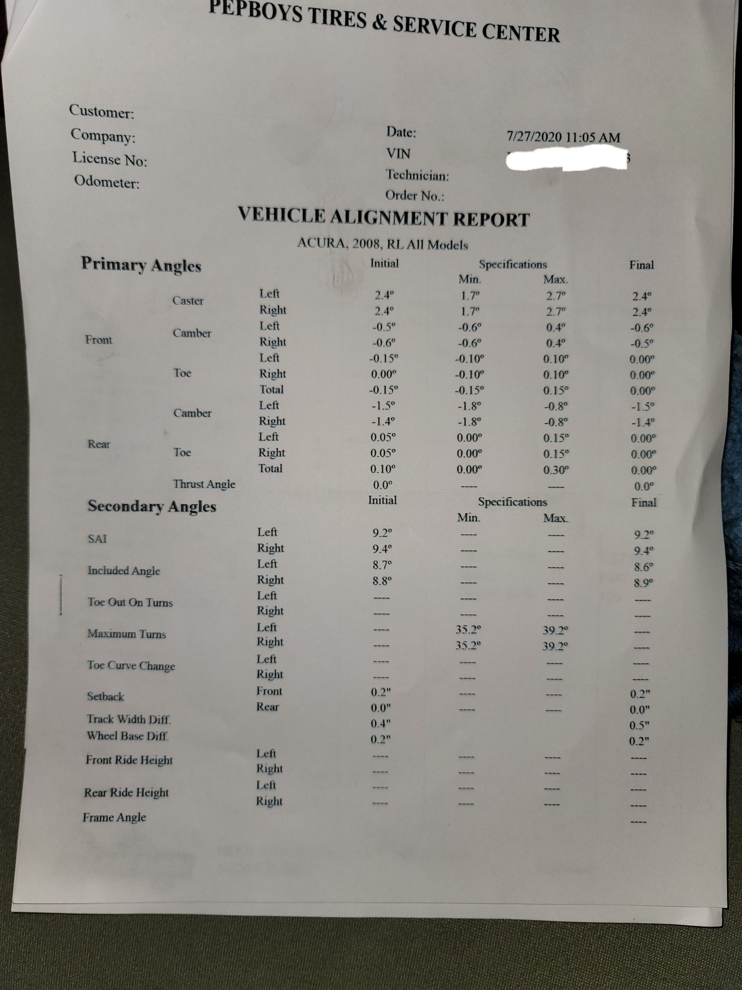

I went to another alignment shop and showed the guy, a print out of the recent alignment. He said that by looking at the sheet, left front wheel is setback and he will need to examine the vehicle to see if something is bent and/or subframe got shifted a bit. Pretty much only available time/date was Wednesday next week.
Anyone that did an alignment previously on 2nd gen RL, could you please provide the print out of it? I just want to see if most or all alignment shops do have Acura's factory "specified range" numbers.

Caster specs on your car seem to be at 2.4 for both which is good, but I wonder why 2009 shop manual from Acura shows caster to be at 2.10 and not more than 0.30 difference between both sides. Unless 2008 model has some different alignment specs
