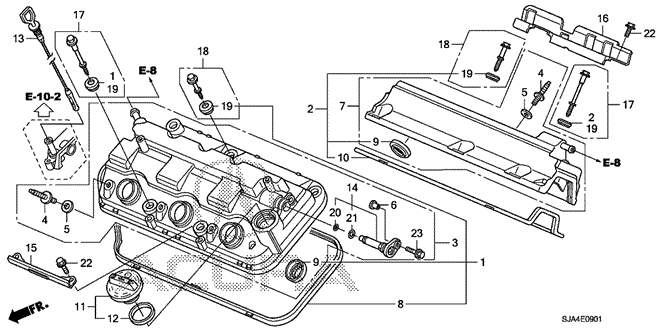

Originally Posted by projektvertx
Any way you can post the part map you’re referring?
Well this is a map:
What i bought was 16 & 17. Did install them yet. Still unsure.
The description I gave above is for anyone who knows the car from below by heart, or if anyone raises one, maybe they can tell me what or which that bolt that I describe above is.

I was taking another look at this diagram, the bolt sold to me at the dealer, and washer, seem to have another part going through them - if that's possible, number 15 above, called : "Bolt, Breathing".
Anyone knows the function of that? Breathing what? and could this leak engine oil?

I believe bolt #15 is the drain plug for the engine's coolant. It looks similar to a bleeder on a brake caliper.

I’m gonna second what looks like coolant drain point for the block. I don’t know he 3.7 design but based on seeing other vehicles that’s what that looks like. Shouldn’t leak oil from that point directly. Are you sure is isn’t coming down from the valve covers and stopping there?

Found this photo on an MDX forum, but all J-series V6s are similar in design. This view is from behind the passenger wheel looking up. The down arrow points to bolt #15 (yours might not be copper in color). Is that the same bolt you're looking at on your vehicle? If that leaks, it would leak coolant, not oil.

But I don't know if its even that breather anymore since the picture posted by ctyper does not look like what i saw.
That bolt is sticking out to the right side. remember, I'm standing below the car, a bit behind the oil pan, on the passenger side, facing forward and looking up. The bolt was above screwed in from the right side. I did not pay attention if it was going into the oil pan, or the engine bay, but if engine bay, it's not too high up above the pan. The oil runs down in a couple of lines on the side of the pan until below it. And it's not much.

Its #8 and #10 on the above..the gaskets that is. #3 and #7 are actual covers...theyre called cylinder head covers but same thing
Thanks!
