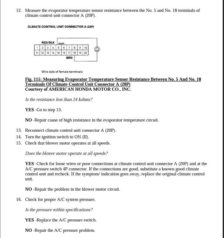

Replace the dryer if you haven't already.
Check the the pressure switch first then the Expansion Valve. Clean the filter if it have one. Assuming you have enough freon.
