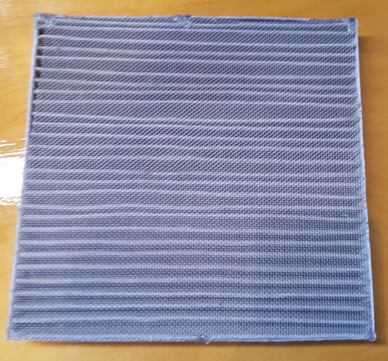

Well, here's what I decided to try. Ignoring my crooked cut, just some aluminum screen material attached to the filter with a glue gun. Should work fine, we'll see.

you should put that in the cowl (the aluminum mesh) where the fresh air intake is. That is typically where they make entry into the car...
That was my initial plan. I ended up going this route because the intake is too hard to access, and I basically don't have enough time with the car to tear everything apart, and figure out a way to secure the mesh to the intake.
