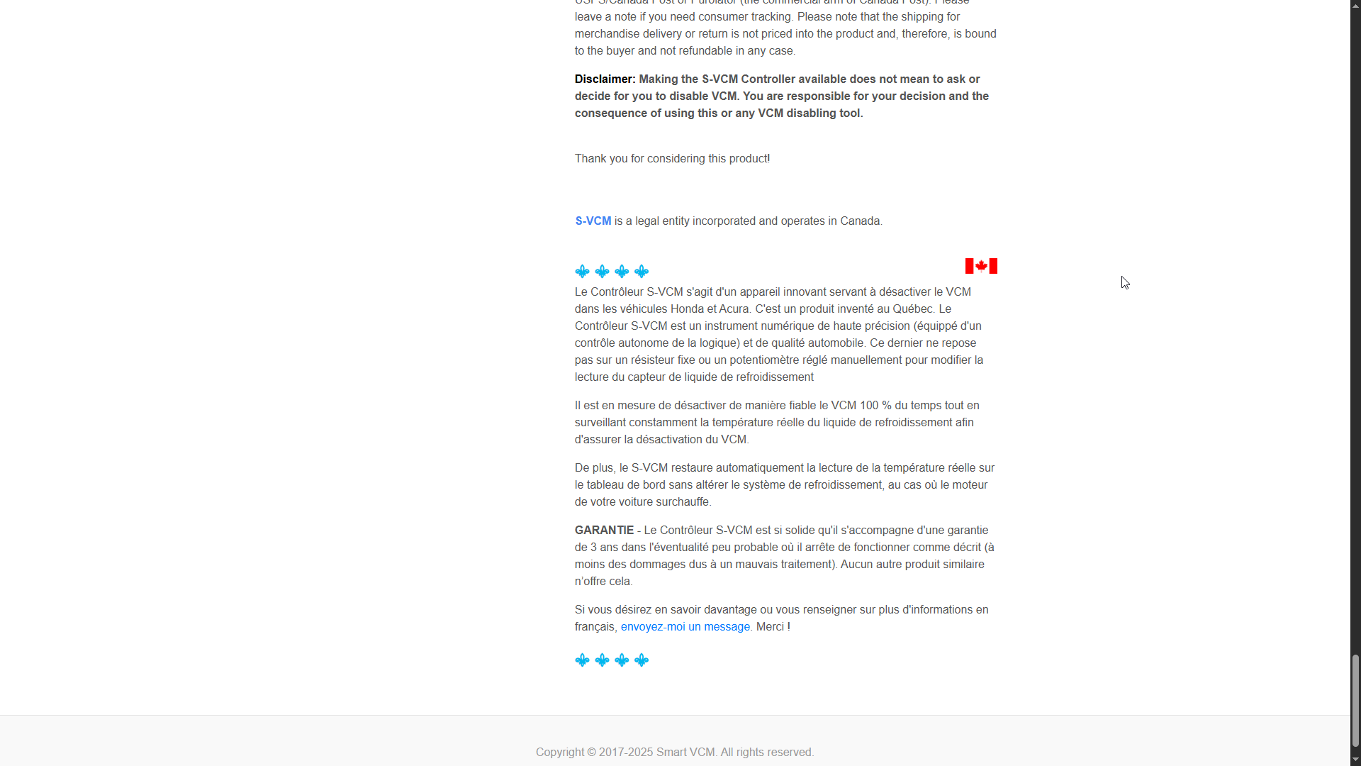

@altair47 Is this the muzzle you referring to? https://www.svcmcontroller.com/
Does anyone know if there's a Canadian dealer?

Send them a message through the website
