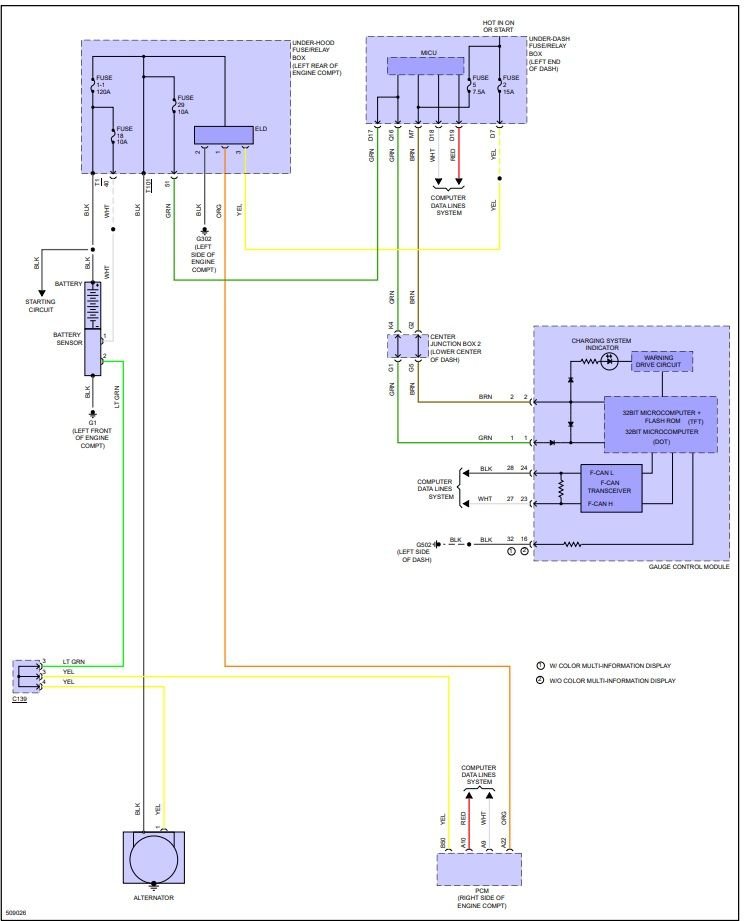

This is the most primitive charging system there can be. On my 2009 TL, the alternator is controlled by a LIN bus and has four pins, but here there's just one constant positive control pin. How could they not immediately identify the culprit in this case?
