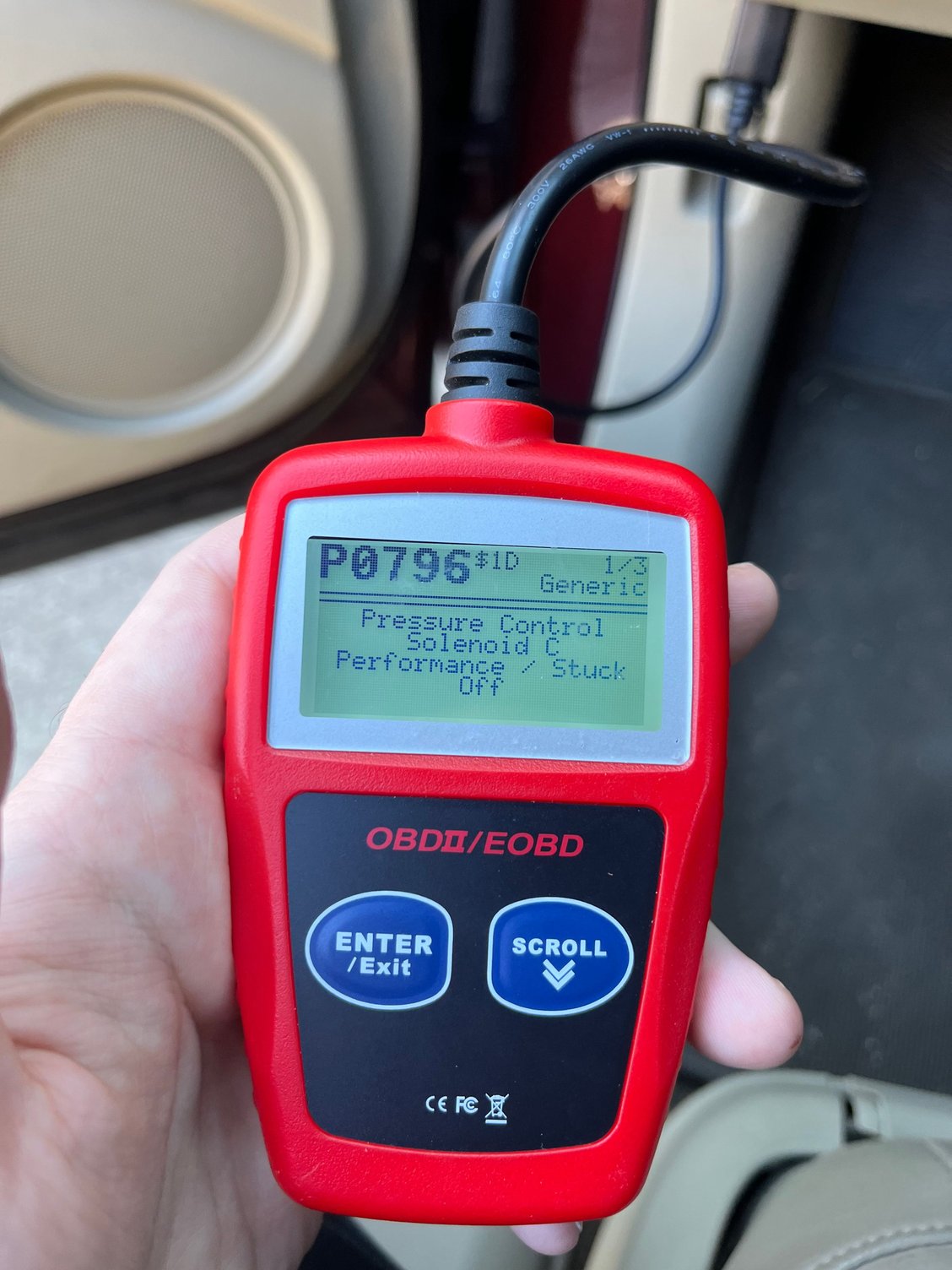

Hello. I am having a transmission problem and want to replace the control solenoid C as that is what my device is saying I’m having problems with. The issue for me however, is that I can’t find a control solenoid for sale. I’ve been looking but I keep either getting shift solenoids or VVT solenoids. Does anyone know where I can find what I need?

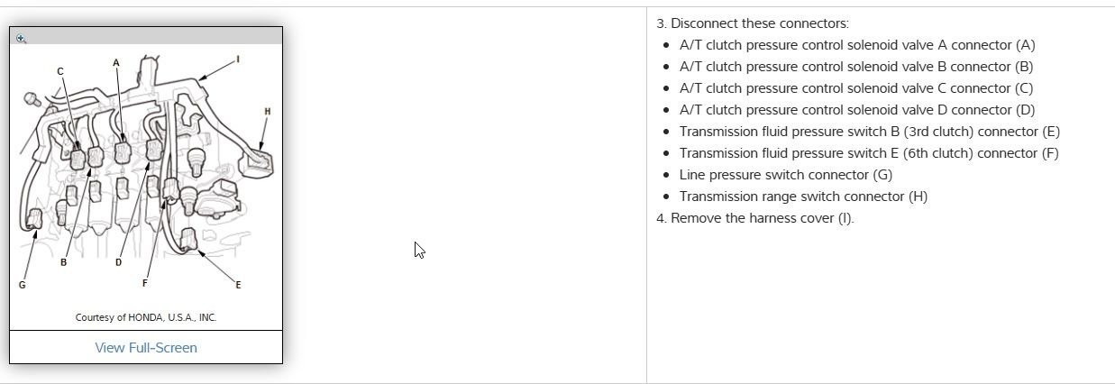

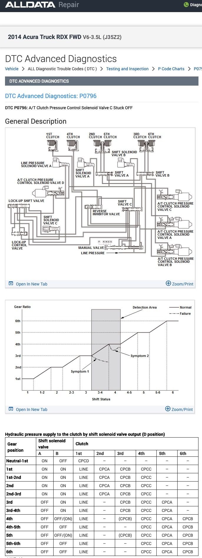

The clutch pressure solenoid C is mounted in the secondary valve body and cannot be replaced separately.

I ended up swapping out the control solenoid which was located right under the alternator. So far the car runs well and I have yet to have any problems with it in the past few months. I took a 4 hour trip and got my car inspected and everything has seemed fine. Just a warning to those who try this, you have to remove the alternator to properly reach the solenoid.
