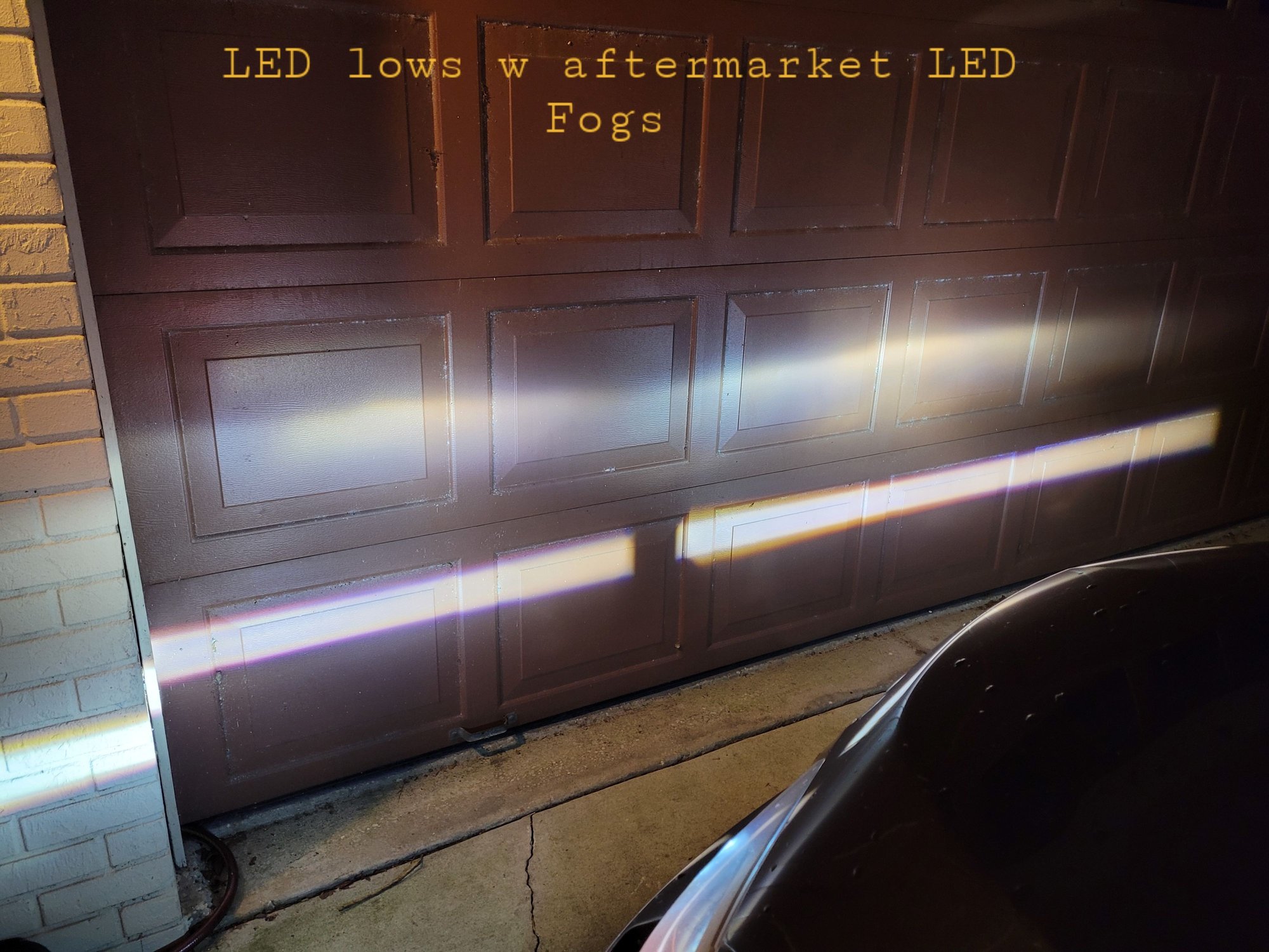

I added aftermarket LED Fog lights and made a world of difference. Much like you fine folks, I believed only being able to see 20' down the roadway in a dimly lit fashion didn't provide safe driving conditions. I also have TechMaxx Adjustable LED's in the High and Low beam sockets. Total package together fixed all of my lighting problems.

So thankfully, Acura has the main part of the harness in place. The switch, I ordered the factory headlight/fog light switch (plug and play), the connector from the factory harness to the individual fog lights, the new (aftermarket) fog light bezels, and then the fog lights of your choice.
Hard......No, there are YouTube videos out there for the bumper removal and removing the steering wheel housing bezel. I believe in total it cost me about $200. Total time, it may have taken me 2 ½ hrs.
