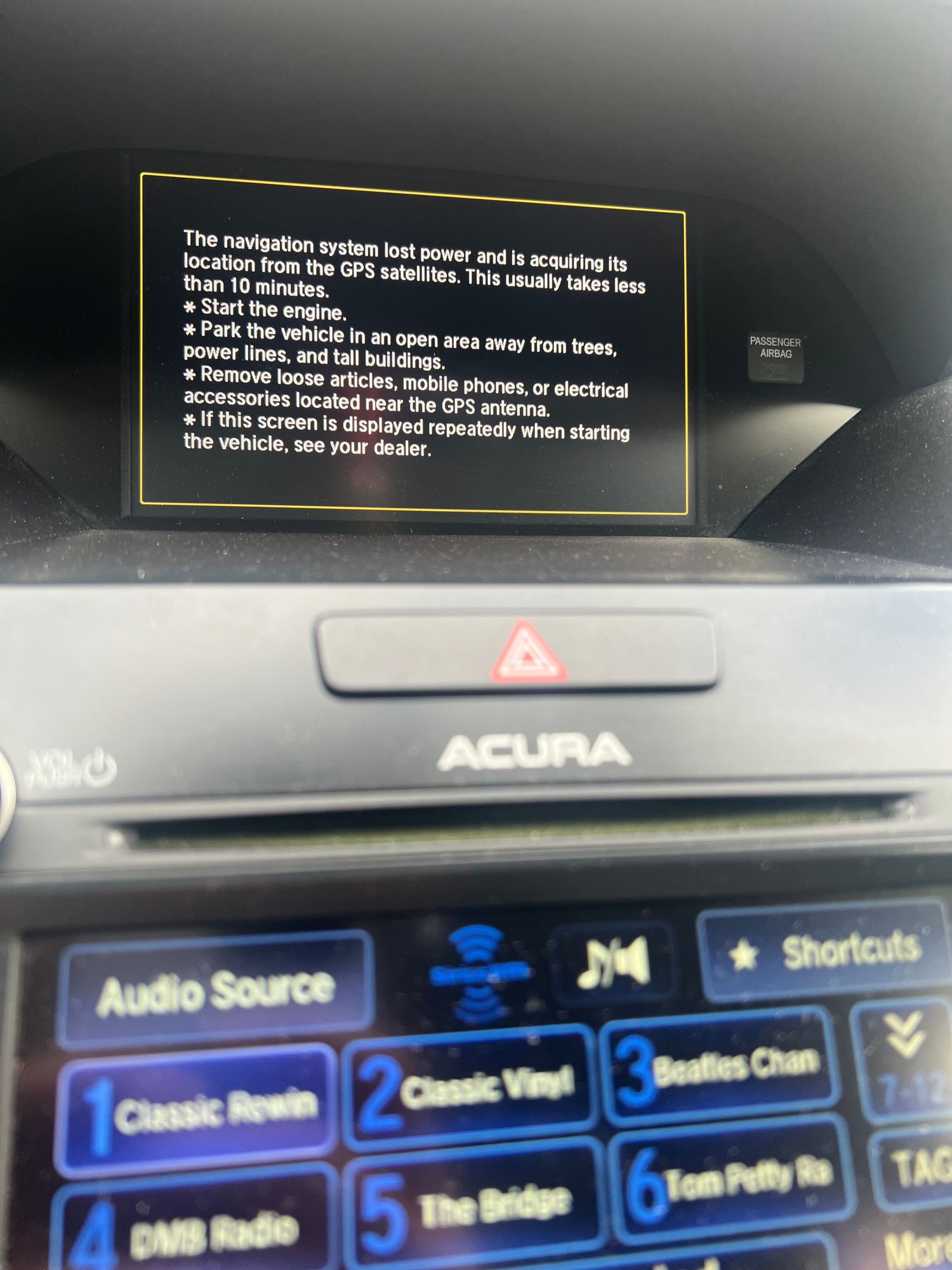

How to unplug infotainment system?
Originally Posted by Gadgetjq
Yes, you 'can' add Apple Carplay and Android Auto to your 2nd Gen RDX. You can also add cameras all around the car and (my fave) phone screen mirroring. All you need is a module from NavTool and a heap of patience. Oh, the patience isn't for the install, it's for NavTool tech support. Lets just say when it comes to answering questions the support staff (of one) is a great engineer.
I've posted a video of my installation that includes a few tips and a demo of the system. Links for parts and other info is in the description below the video:

[QUOTE=Gadgetjq;16699719]
Originally Posted by DaBlues5
Any aftermarket installers that you could reccomend?[/QUOTE
Aftermarket installers are pretty localized unless you have a Best Buy nearby. Try Googling auto radio installers near me. First watch the video (link above). Installation is really simple.
Hi I know this is an older thread but I saw that you installed your own CarPlay by navtool in your RDX. I had mine (2018 RDX tech) installed by a stereo shop and it’s been fine since 2022 until my battery died in Nov. It was the original battery so I was not too upset. AAA installed a new battery for me but now I can’t access the menu, settings, phone, info etc the buttons on the dash surrounding the big enter button no longer work,except for the long press on the back button which is the doorway into CarPlay. There’s just this paragraph displayed unless I connect and activate CarPlay. I can’t change the settings on my screens or access door lock config or even Bluetooth to pair a new phone. No menu or settings are accessible when they previously were prior to the battery replacement. Any ideas on how to fix this? I’ve tried the simultaneous holding of menu settings and back as well as the power/vol button that online searches recommended. I made my own thread about this but I saw your thread here and figured I’d ask you.
Old Dec 18, 2025 | 11:59 AM
Gadgetjq's Avatar
Inveterate Tinkerer
Joined: Nov 2016
Posts: 293
Likes: 122
From: Surprise, Az
I doubt the Navtool module has anything to do with this issue.
Try posting your problem in the RDX 2nd Gen Problems & Fixes section ( https://acurazine.com/forums/2g-rdx-problems-fixes-409/ )
There might be some sort of hokey pokey press 3 buttons simultaneously while chanting "fix now, fix now" that will unscramble your issue.
Meanwhile, follow the instruction on your screen. Be sure your car is outdoors with as unobstructed a view as possible to get maximum satellite links. Once the GPS connects your problem might go away on its own.
Old Dec 18, 2025 | 12:10 PM
ballerina617's Avatar
2018 RDX Tech package
Joined: Jun 2014
Posts: 23
Thanks for replying. I have tried what the paragraph suggests. Nothing happened. I believe the internal gps is no longer connected since the CarPlay was installed because I couldn’t use the Acura nav. after CarPlay install. The map wasn’t showing where I was if I tried. I’ll try to post it to problems and fixes. I did a thread post to this 2ndgen nav forum. One suggestion I saw was to fully disconnect the battery and then touch the terminal cables to each other for a minute or two and I’m not sure about what touching black and red to each other would do and idk if I want to try that. I tried a 3 button press and a long press on power/vol, neither worked. Thanks again.

Old Dec 18, 2025 | 01:51 PM
Gadgetjq's Avatar
Inveterate Tinkerer
Joined: Nov 2016
Posts: 293
Likes: 122
From: Surprise, Az
Touching the cables together is an old school way to drain any capacitor charges from the car and completely reset the system. Whether it's really necessary for modern cars I don't know but it wouldn't hurt anything. Be sure to disconnect the negative post first then positive. You only have to touch them for a few seconds then reconnect (positive first).
Do you have the security code for your radio? My '17 requires one after a battery disconnect. You should have it with the car's paperwork or you can download it from Acura's website.
Old Dec 18, 2025 | 05:14 PM
Joined: Jun 2014
Posts: 23
I disconnected the battery and reconnected but didn’t touch the cables together. I was afraid and wasn’t sure about any capacitor that the added Navtool or remote start might have. Someone on the subreddit r/Acura just told me they should be fine as long as I haven’t installed anything like a subwoofer with amplifier which I haven’t. I’ll try this tomorrow maybe since it’s dark out now. Old house and my RDX doesn’t fit in the garage. Another frustrating thing added to this issue and the terrible, grainy backup camera picture I get at night.
edit to add: I don’t have the radio code but the screen said to hold down the power button for the code to automatically populate and it did.

Old Dec 21, 2025 | 09:05 AM
Joined: Jun 2014
Posts: 23
Navtool replied
So I had also posted my screen issue on the subreddit r/Acura and Navtool replied. Basically they explained that the shop who installed my CarPlay module must have neglected to reconnect my gps antenna and that it was running on memory but once the battery died and was replaced the full power loss wiped out the memory. They say they believe all I have to do is have the gps antenna reconnected. So then I watched your install video on this thread. Is the gps antenna one of those many grey plugs that were pulled out of the back of the radio and then they are connected to the orange? Is it somewhere else? I’m seriously intimidated by the idea of doing this.
Old Jan 20, 2026 | 03:18 PM
Joined: Jun 2014
Posts: 23
Solved!
I took my car to a custom car stereo shop and they took a look. My GPS antenna was indeed disconnected. They plugged it back in and voíla everything is back up and running. Even the Acura navigation is working. Thanks to everyone for their help and suggestions. I’m even bringing my car back to them on Friday to have them upgrade my backup camera. It’s all happening!

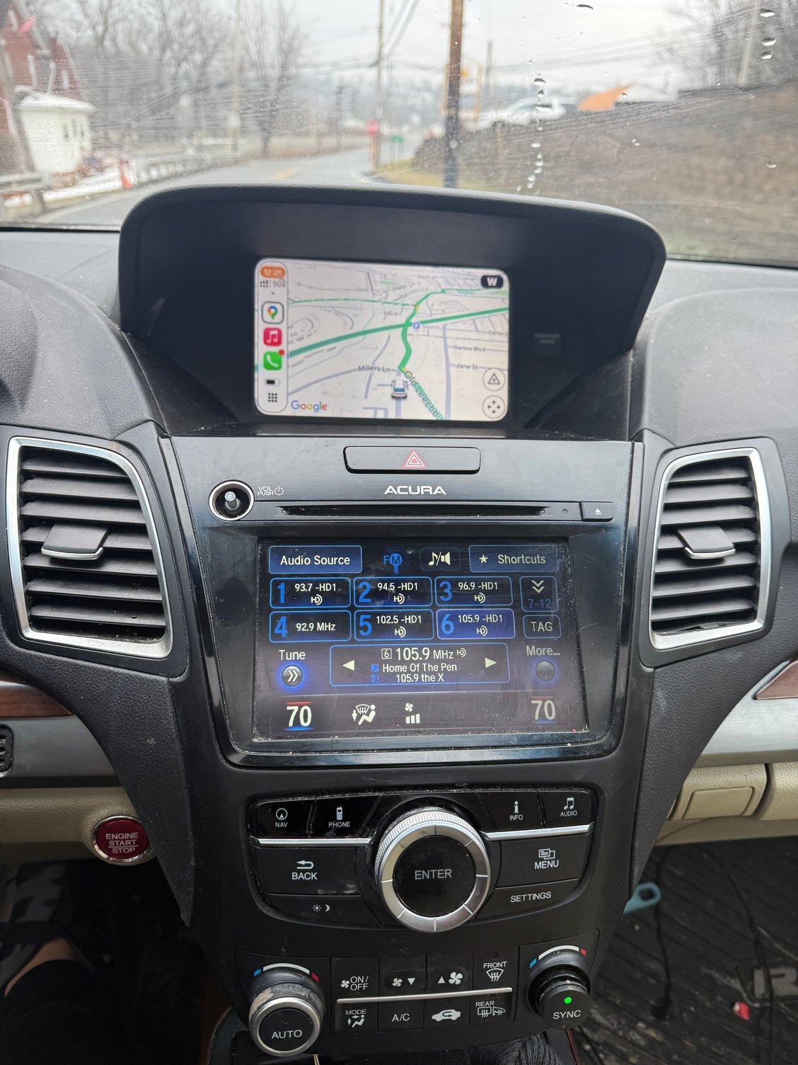

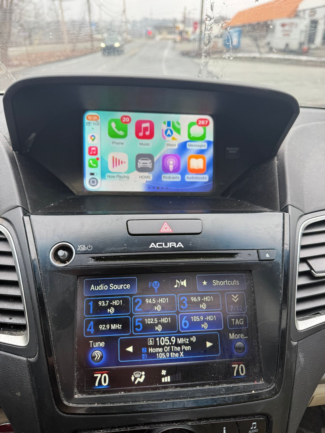

So I spent the day at the custom shop for a new backup camera installation because my Acura camera is horrendous. I was there all day because they couldn’t integrate the new high quality camera with my CarPlay module which is by Navtool. I’d had it installed in 2022 but this stereo place is saying it’s much older than 2022 and they can’t get the camera to work with it and Navtool support did not come to the phone at all over 7 hours that I was there. I am actually going to upgrade my CarPlay with this shop to a wireless model (not a Navtool product) and get the new camera that they support and warranty for 3 years. It’s ridiculous that when I had CarPlay installed I thought I was getting a new unit but apparently the original shop gave me one they had laying around that was obsolete already. It’s obviously not within any warranty and I never even got paperwork with it anyway. I’m just going to bite the bullet and do this because my car only has 70k miles, is paid for, and in otherwise great shape. I looked at newer (CPO) cars and I just don’t see the need to spend that money when doing this will make my car equivalent.

Just finished
Just finished my install. Thanks for your video. That helped tremendously. There was no slack on the factory wiring. I could barely pull it out enough to get my hand in to unplug the wires.

Mine is a 2016. Had it since it was new. My wife drove it the last 5 years...hard miles...as you can see. I installed an Aliexpress version of Navtool. Seems to work identical and install was the same. It was 338 shipped.
