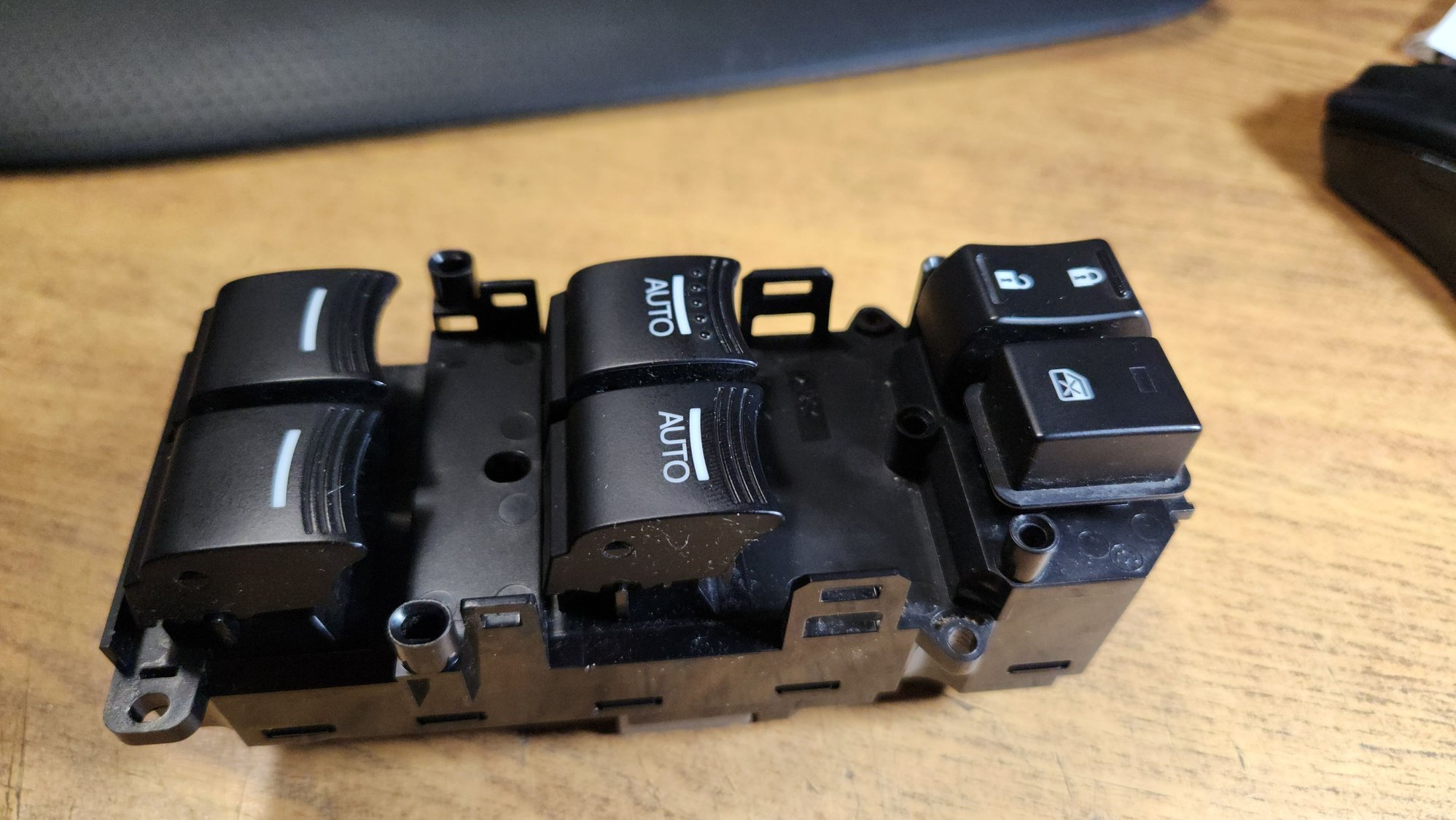

Well, this ain't no simple switch!. The mechanics are, but that's about it, the rest is like a darn micro computer on an armrest!.. No easy way to diagnose it with my rather limited electronics knowledge. The mechanics seem to be OK, no corrosion or damage at the contacts and the switch itself works correctly when pushed in or out, so there must be some electronics issue and it looks like I would have to either replace the PCB (or more likely the whole window/door lock assembly) and cross my fingers that the problem will be gone. The other option is to somehow find out how I can bypass that switch as I never need to lock the windows when I drive. Anyone have any ideas on bypassing that switch?

The only thing you can cheat with this system is the ability to use the rear switches, so you'll need a new master switch. But I'd try bending the mustache.

You could also try getting a replacement window switch and see if that's the issue. I'd use Amazon or someone else who would let you return it with no hassle if it ends up not fixing anything.
Hmmm, I should definitely try that before giving-up and buy a new master switch

Unfortunately bending the "mustache" didn't help.
