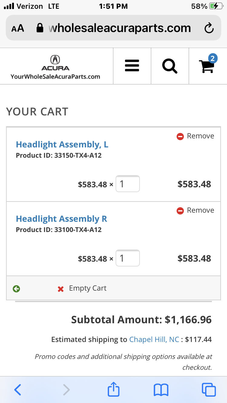

I decided to purchase the revised OEM light assembly so hope it turns out to be the correct decision. That being said I found them online for $588 each and will install them myself. Compared to the 2k my dealer quoted it will be a fairly substantial savings. Now I just hope that they don’t degrade like the last ones did but only time will tell. Thanks for everyone’s help

Thanks for sharing your findings as for how much the replacements cost searching online. Just be sure you actually receive the newest part number that end in A12. I've seen some places still list the ones that end in A11. It's likely that the ones that still list their part as the ones that end in A11 will actually ship the A12 instead.. But we don't advise anyone to assume.

they are supposed to be the revised version. I have attached a picture for anyone that may be interested in the future. Also in a couple weeks when I come in I’ll post back on the outcome.

Well, the new part numbers are in fact listed. So you should be good to go. Thanks for sharing.
