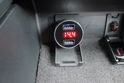

So what is it charging at? On my 2017 RDX it is always at 14.4V which is just right for a conventional battery.

The humidity is not the issue but the temperature is. If you are at say 100F, then 14.4V is overcharging the battery. Is that still the original alternator, or has it been replaced with an aftermarket unit. The hotter it is, charge voltage should be reduced and normally the voltage regulator with negative temperature compensation or a temperature probe to the charge system takes care of that.
You should get what I have, plug it in and see what the charging system is doing when it is hot. I have had 16 and 14 years out of factory installed conventional batteries.
