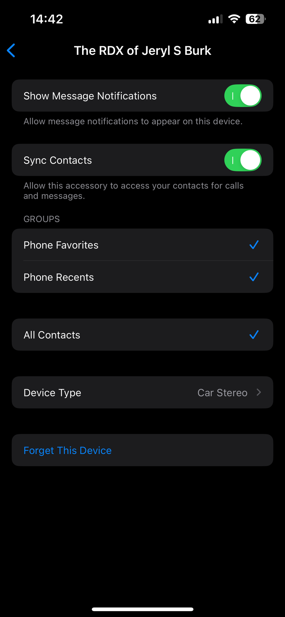

Old Nov 16, 2024 | 02:47 PM
jerylsburk's Avatar
Joined: Feb 2024
Posts: 11
Originally Posted by johnjrval424
I just purchased/leased a 2017 RDX with tech package. I have an LG V10. I cannot get the text messaging feature to work. Everything else is fine but no text message pop-ups at all. Two salespersons at the dealership who were supposedly trained in this package couldn't figure it out. A tech at Acura tech support also couldn't figure it out after an hour on the phone.
By comparison, I also leased a 2016 Toyota Highlander and the text message function works perfectly. So, I know it is an Acura problem.
Has anyone else had this issue?
it happens from time to time for me and it’s almost always is either a reboot or the phone or taking the phone on my iPhone 13 and I was years later from when you originally posted this but there’s a thing at the very top it says show notifications and now it says show message notifications that needs to be toggled on if you had to delete your phone from there and reinstall it which I’ve had to do a couple times because of can’t remember the reason why but I had to do something like restart it while it was still connected or something and then had to reconnect everything all over again but that pot toggles off. I hope this helps. Hopefully they fix that so it doesn’t toggle off but the developers and Apple can do whatever they want to. I don’t know what it is, but I’m guessing so what I’m talking about,
you can find the setting under the app settings: Settings > Bluetooth > HandsFreeLink (or HFL or whatever you renamed your car to) > tap the ”i” with a circle around it at the corner for information and it will bring up this screen:
