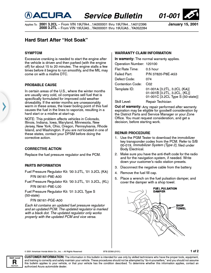

7. Car dies while driving.
8. Car does not start ramdomly.
9. Car cranks slower than normal... battery issue.
10. Starter could be defective.
11. TSB below.
