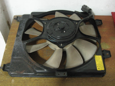

Originally Posted by aznboi2424
^I Agree.
There is a warning saying that the fan comes on without warning even when the engine is off.
They don't even put warning labels on radiator fans anymore but here's what one looks like.
