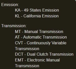

Originally Posted by jonah.r7
Also was told that since I'm in California, I need to have a California ECM, and it can't be a federal ECM or I won't pass smog in future, since California regulations are weird. Don't know how to figure out whether its a California one yet, maybe just based on exact part #?
Go to this Acura vendor and input the VIN for your car to get the most accurate ECU part # result:
Genuine OEM Acura Parts and Accessories Online - Acura Parts Warehouse
In the 'Part Fitment' area below there is an 'Emission&Transmission' informational "?", press on that and it will show what's depicted below:
It appears that the 2001 CL-S requires ECU 37820-PGE-A62, which is only reflected for the KA_49 States Emission, is listed, as far as I can see?
In putting your VIN should confirm wheather you need a 'KL' Cali ECU, if it's even available for your model year?

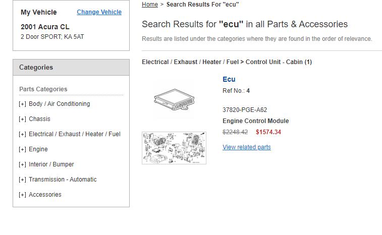

this is what comes up when I do a search

it looks like with my VIN entered the same ECU is coming up, is that the one I should look for used or should I try and find one thats more updated as fireball was saying?

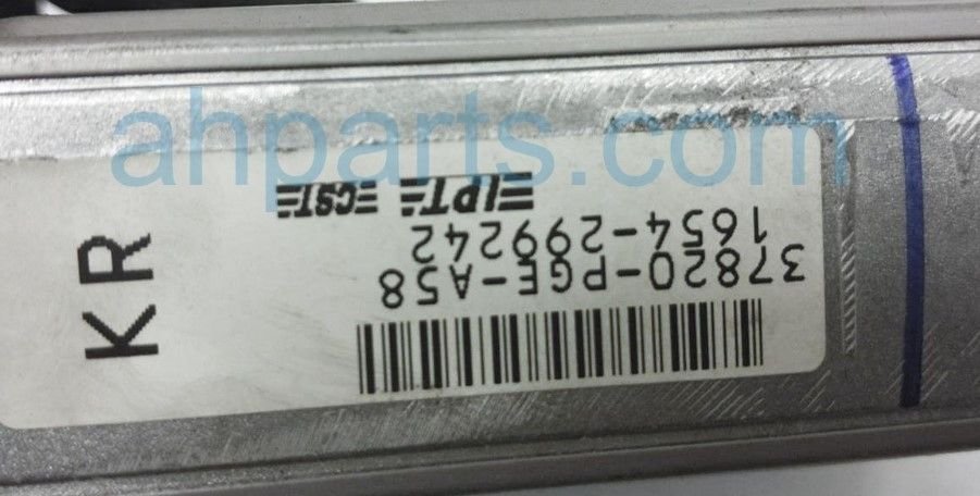

There is a $50 one in post #4.
However, it is a 37820-PGE-A58.
Maybe the 37820-PGE-A62 is the updated one?

Nvm label on box does say a58, so maybe 62 is the updated again I need to just find the label of mine first, I think either same or updated one should be fine as long as it works tbh.

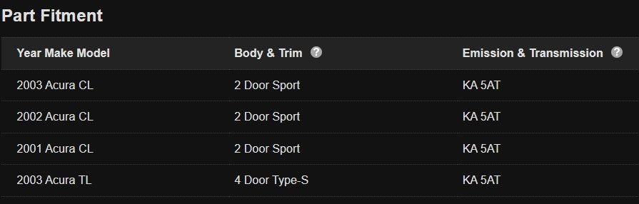

yes to which the same exact model or newer?
The one in may link for $50 is from a 2001 Red CL-S, as shown in the pictures on the website. It's a 37820-PGE-A58 ECU.
The latest 37820-PGE-A62 has the following fitments:
So, if you find a similarly priced 37820-PGE-A62 it should work, per the fitment table above.

No, it's an A58 in the pictures supplied on the webpage:

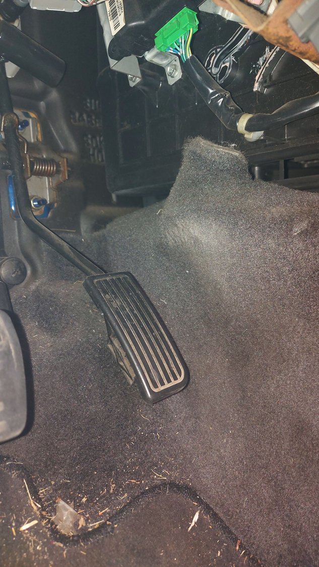

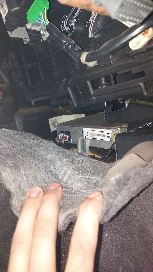

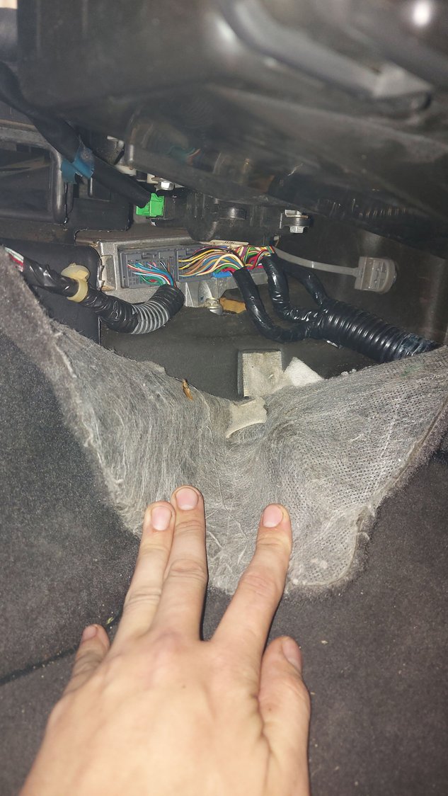

found it
this is what I found after pulling up the carpet on the front passenger side, does this mean I need a different ecu than thought before? Is this even the right sticker? I’m confused on where to go from here.
Old Jun 29, 2022 | 12:00 AM
jonah.r7's Avatar
Joined: Jun 2022
Posts: 73

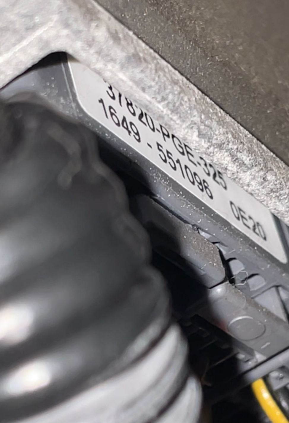

Likes: 10

when I input my VIN on Auto Parts Warehouse it pops up with an A62, and then the other website said the A58 was from an almost exact replica from California admissions, does that mean I have one with an ECM out of California already, or is it a different version? Just confused a little.
Old Jun 29, 2022 | 12:20 AM
Thefireball's Avatar
I am dumb
Joined: Oct 2018
Posts: 788
Likes: 208
From: Nashville, TN
37820-PGE-325 & 37820-PGE-A62 will both work.
I don't know which ECU is the ULEV version, but I'm assuming it's the A58? As long as it's meant for the Type S, it will work. If yours is supposed to be an A58, then it looks like some one's already swapped it out.
Like I posted before, the main difference is the cold start up.
Old Jun 29, 2022 | 12:24 AM
jonah.r7's Avatar
Joined: Jun 2022
Posts: 73
Likes: 10
Ok so it looks like I don't even have a California one to start with, so then it shouldn't be any difference so I can still get the California one linked by zeta earlier and it should be fine?
Old Jun 29, 2022 | 01:08 AM
I am dumb
Joined: Oct 2018
Posts: 788
Likes: 208
From: Nashville, TN
I would assume so, yes. I believe the A62 is the updated version to help with the transmission. If I remember correctly, they changed the shifting to be a tad slower. Other than the cold start and that, they will all work.
The base model ECUs are different and will not run your car correctly, and those are the ones you need to avoid.

Old Jun 29, 2022 | 03:09 AM
jonah.r7's Avatar
Joined: Jun 2022
Posts: 73
Likes: 10
images of car
Old Jun 29, 2022 | 02:55 PM
I am dumb
Joined: Oct 2018
Posts: 788
Likes: 208
From: Nashville, TN
I always love seeing a CL. Puts a smile on my face when I see one out in the wild. They'll haul ass when they're fully modified. I pull on NA V8s all the time, and most are not stock.
Well I hope you can get your ECU fixed ASAP so you can get the ball rolling on fixing it, then modifying.
