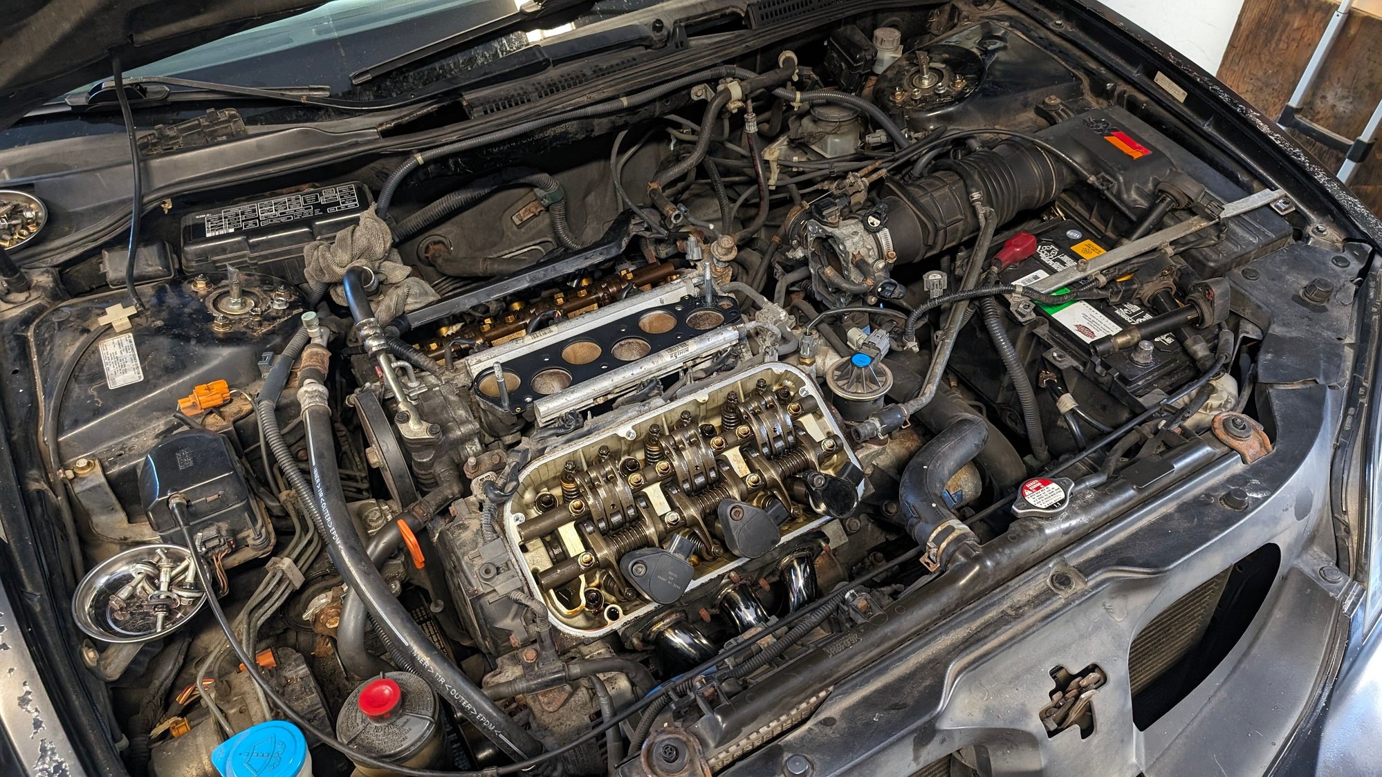

I'll take a look tomorrow. Pretty standard thickness and I've noticed no increase in loudness.
All and all it's a good fitting product
I've not really felt any noticable gains other than running smoother. I did clean up the intake and used all new gaskets

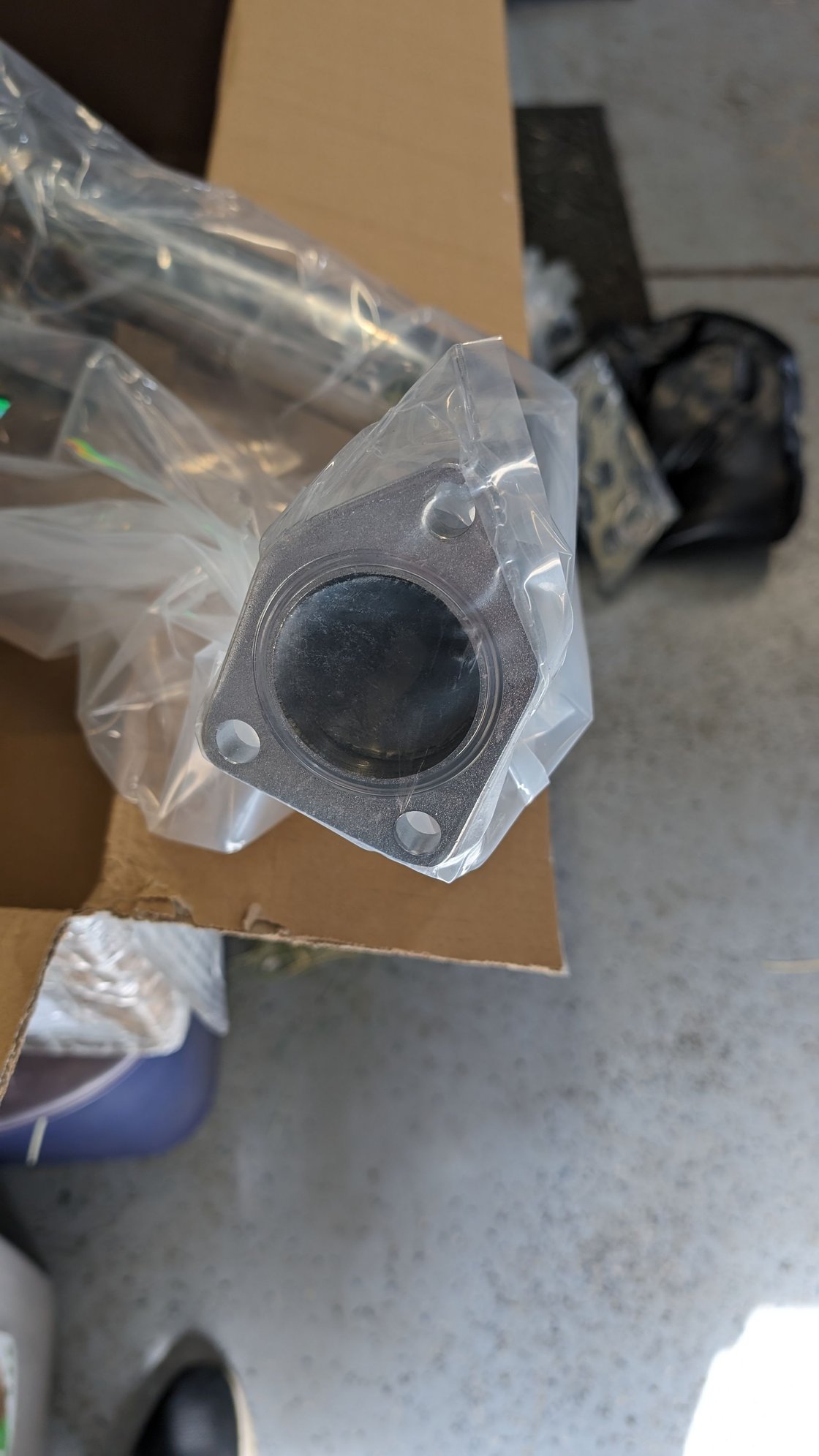

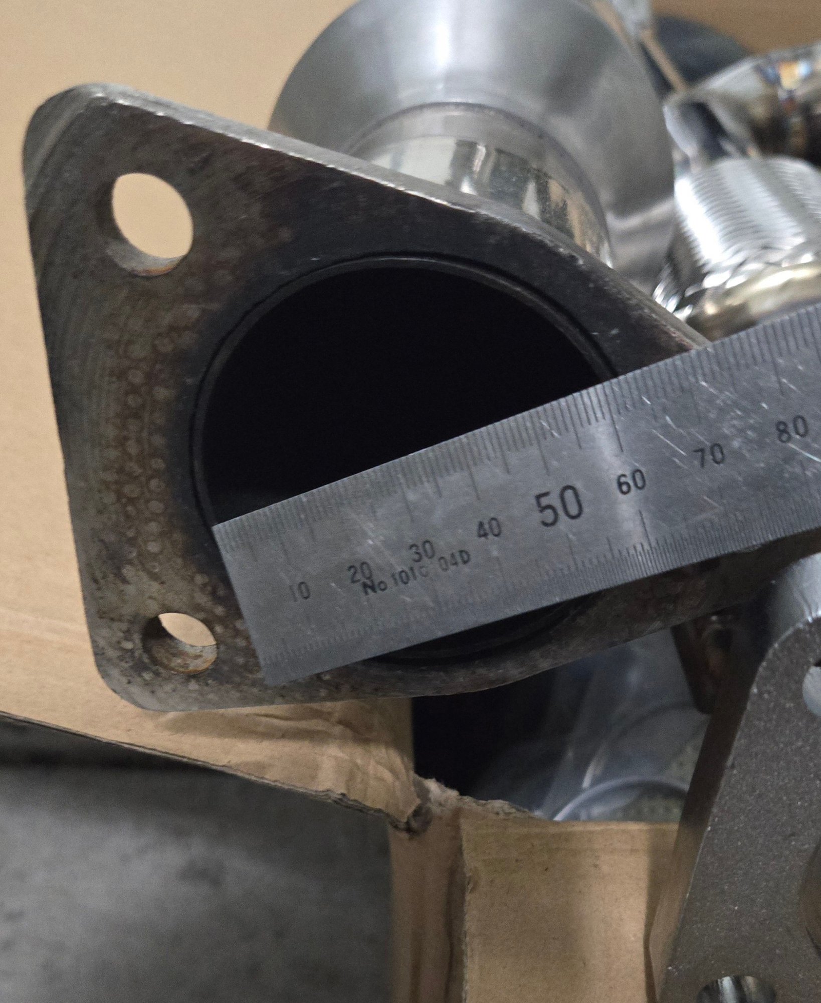

So, just received my order of XS Power's Acura / Accord V6 Header. Unfortunately, the piping size is not as advertised.
The website claims 2.5" collector. However, in actuality it measures at 2"/50mm. For comparison, a used 2.36"/60mm flange is clearly larger:
XS power 2.0" / 50mm I.D
Used 2.36" / 60mm I.D. flange
Being that stock the j pipe also has a 50mm collector, this likely explains why no noticebable gains were felt by the O.P. That said I have contacted XS, who btw has these mfg and shipped direct from China.

Alright, after contacting XS, about the size difference their response is:
"We do not false advertise. You are thinking 2.5" COLLECTOR means OUTLET. IT DOES NOT MEAN THAT. The outlet is NOT THE COLLECTOR. These headers are the best AV6 headers out there."
I will omit my smart a** response to that last part.
Continuing on... Unfortunately my project is limited on space, so I need a header set with factory style fitment. So, long story short I disputed the transaction in paypal. In which I requested a partial refund to facilitate replacement of the 2" outlet with a properly sized flange. The seller replied and wants me to ship the headers back (at my own expense) for which I would only receive a refund amount of $80. Obviously, this is an absurd offer which was immediately rejected.
That said, my only option seems to be cutting off the restrictive 2" outlet and replacing with a properly sized flange at my own expense. Lesson learned don't be misled into buying cheap headers without knowing all the specs upfront.
