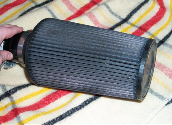

Old Aug 9, 2002 | 11:20 PM
Shawn S's Avatar
Joined: Oct 2000
Posts: 20,014
From: Hellertown, Pa. USA
Here is after about 12,000 miles when I used the K&N cleaning/oiling kit.
BEFORE and AFTER.
