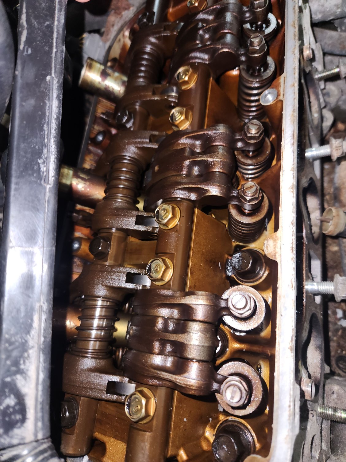

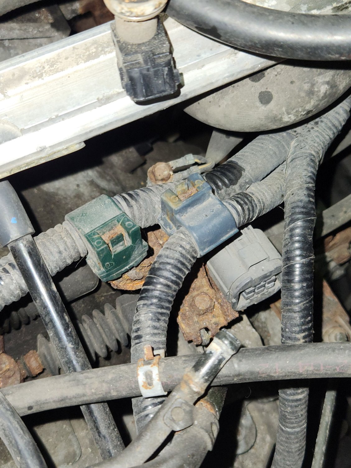

Originally Posted by Nick_G
I did say it was a pos in the title haha. It ran OK tho, had intermittent electrical issues such as it randomly shutting off but did something that made that a little better cant remember what but would still do it when wet. Its had quite some time of sitting around, drove it to the shop and twice it lost all electronics for a sec but never shut off , I've never had that happen before.
Yeah, that definitely looks like it could use some work. Rear heads are always going to be dirtier since they're located in the back and are going to get hotter. Fronts will be cleaner. The top plate for the intake manifold is just built up carbon from the EGR valve. Just get a wire brush & clean out the top plate & the EGR path in the manifold.
You could probably just take the fuel pressure regulator off and take a wire brush or wire wheel to it and it'd be fine. As long as it works, no need to replace it. But it wouldn't be hard to just go down to a junkyard and pocket one.
The oil filter housing looks covered in oil. I wouldn't immediately say it needs a new gasket. Maybe it does, but I would check to make sure the valve cover gaskets are good first. It's not uncommon for them to go bad, and then start leaking oil; typically at the corners. Check to see if it's hard/brittle and breaks easily or if it has cracks. Even still, removing the oil filter housing is easy. Just 3 bolts.
Fuel injectors, yeah, definitely replace those. Or at least clean them up and replace the plastic tips.

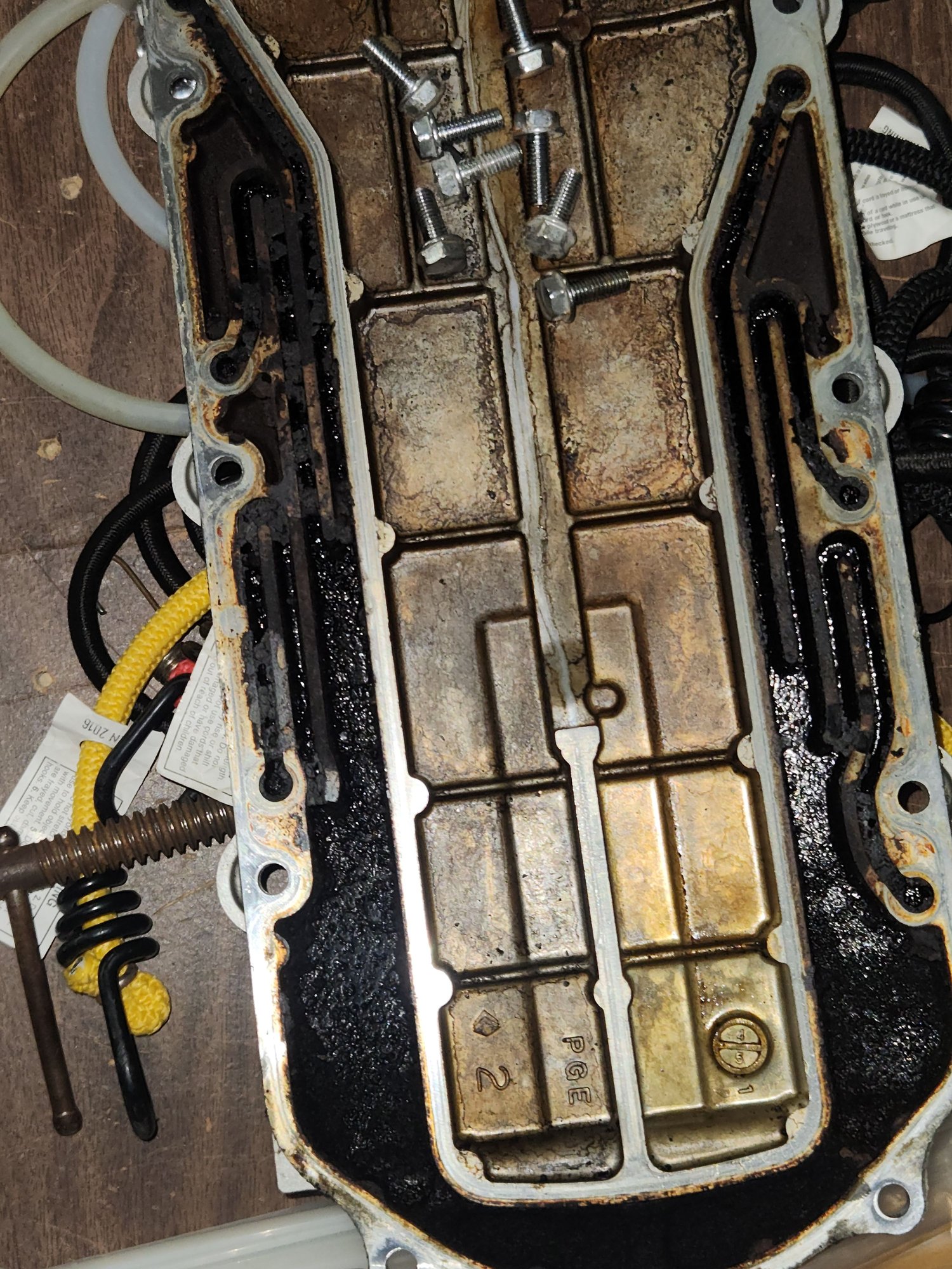

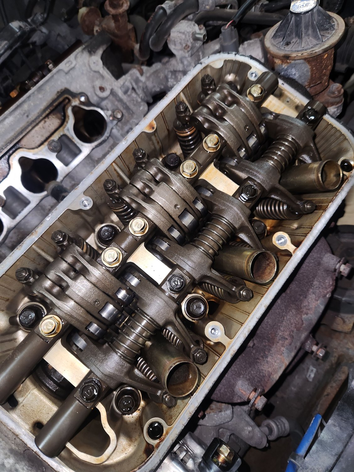

OK, idk about valve cover gasket for oil on the filter housing it doesn't seem to have come from that, the front I can see where it would be much more likely the way there is some build up around the thermostat. The fuel regulator I really don't know if it's bad, I was just making assumptions by how shitty it looked and had fuel lines done in the past, everything is rusty as you can tell lol. Now I guess my question is should I just try to clean it up as it is now and not take anything else apart before I'm in over my head? Should the heads be cleaned? Maybe a little obvious but I've never had a car apart this much all on my own. If leaving heads on how should I go about cleaning the dust and shit that's gone on top of the valves, little air and vacuum?
Oil filter housing gasket doesn't tend to fail, or else you'd have a bigger problem on your hands. Consider the fact that it's dealing with oil pressure, combine that with a failing gasket, it'd be shooting oil out, a lot of it, quickly. I say just give it a good cleaning.
If the car starts & runs, yeah, the pressure regulator is more than fine. Wouldn't hurt to do a fuel pressure test if you have a gauge though. So I'd say that scrub it with a wire brush, or a wire wheel, polish it with a microfiber towel, then maybe give it a quick touch up with paint or clear coat to prevent it from rusting again. The painting is optional though, but it'll rust again with out it more than likely.
Heads don't really need to be cleaned; no. I guess you could take the rocker assembly off and get at any clumps of carbon build up, but then you'd have to go through the pain of a valve adjustment. It's not hard, just tedious, especially on the rear head. Maybe just throw a little bit of seafoam into the oil, drive it for a little bit, then change the oil. But over all, the heads look clean & fine. I'd leave them be.
I would highly recommend not to remove the heads. Only reason you would do that is if there is something seriously wrong with the motor, or if you plan on doing upgrades to it. If you take the heads off, you're going to be looking at doing some bigger work. You'll have to check the deck for flatness, then while you're there, you might as well check the valves. That means removing the valve, taking measurements of the valves & valve seats, etc. You can either do some of the work yourself, or have a machine shop do everything for you. Just an FYI, a machine shop isn't cheap. It was $300 for each head to be completely rebuilt for me, so $600 and some change total. Not to mention, you'll have to reinstall the heads, and hope you did everything right, including the timing belt.
TL;DR: leave the heads on or you'll have a lot more work to do, and less money.
As for cleaning out the tops of the valves in the port, if you have an air compressor, just blow it out. If it's metal, get a magnet in there. Trust me, getting metal in your cylinders is bad. I have a whole J35 swap thread where I killed two motors because there was metal in my intake manifold from my original J32 motor getting a hole banged through the piston. Sucks, but I learned a lot. But if it's plastic, and it gets into your cylinders, you'll probably be fine. It's not that big of a deal. It'll just burn up quickly when driving.
As for your electrical issue, I'm curious as to what was going on with that. That sounds like a bigger issue than what you're dealing with now. Electrical sucks, because it's hard to figure out where the issue is.

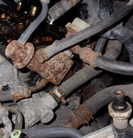

The effect of salt.
What it should look like, less the salt & pressure regulator assy.

Thank you for the info, very helpful. Yeah I'm not sure what the build up on the filter housing is then. Definitely sounds like a lot more work than I imagined as far as heads and timing belt go, I figured id be able to just pull them off and send them out and throw them back on, lol. I'll have to just clean everything up and order a couple things and put it back together and move on to the bigger issues of transmission and power steering, I'll let the next door shop handle those. As far as electrical, I'm curious as well. I remember researching back when I was driving it and concluded it was grounding issues , I think i might have just replaced one negative battery cable or something and made it a little better but after taking this shit apart I've seen some more grounds that are either rusty or worn, two I'm thinking of specifically, one I'm not even sure it's a ground but it sure seemed like it, I think it was on top of the alternator. That one I figured could just clean up with steel brush. Another I seen under the battery is the different type of cable that is, idk, exposed cable? Here is a picture of the one under the battery, clearly seen better days.

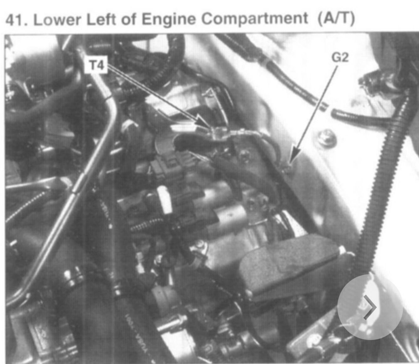

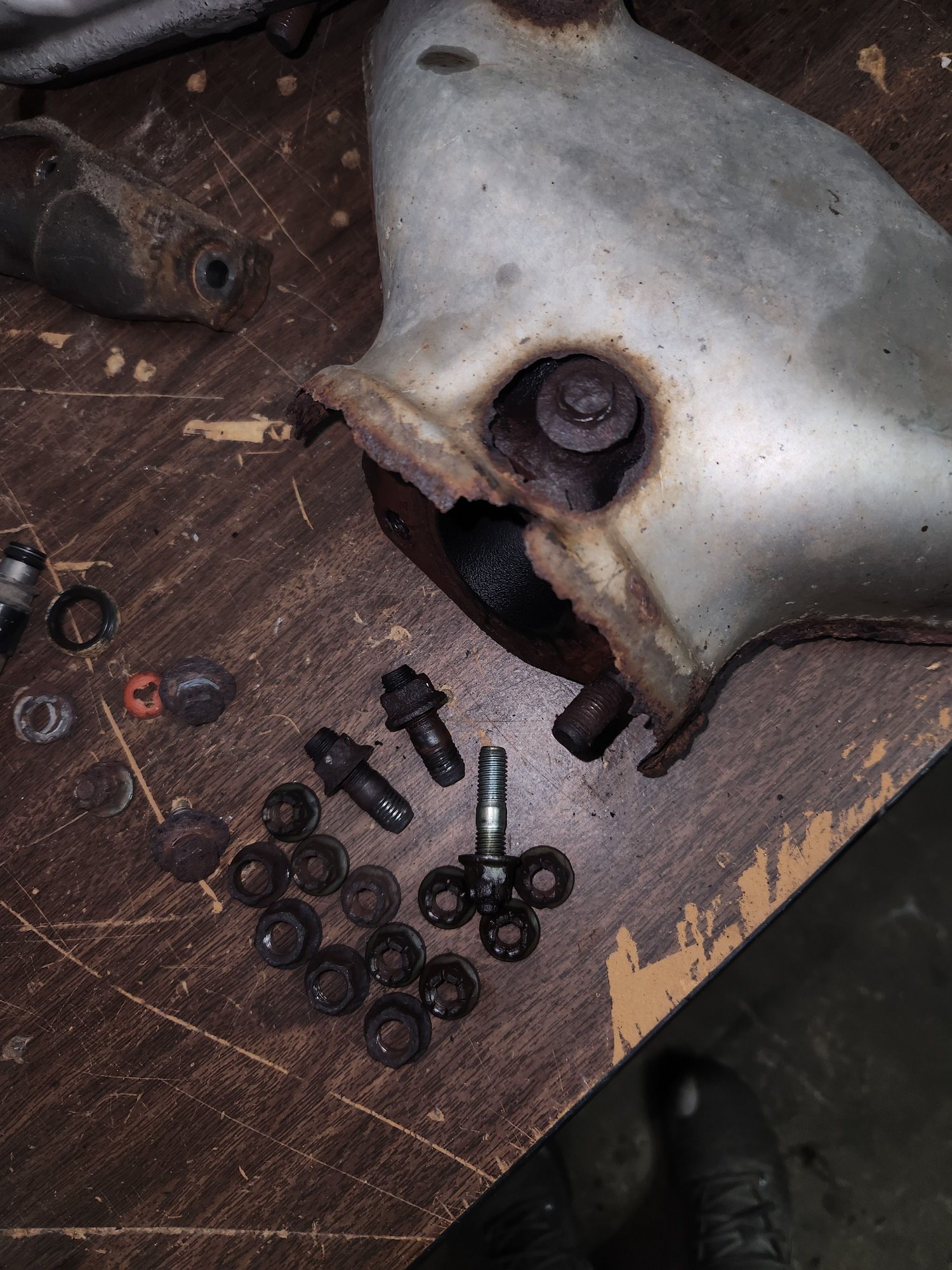

These are grounding points correct? They were stuck on but carefully pry them of and give a nice brushing they are much better.
The first pic appears to be the battery cable stay bracket. Not a ground point.
The second pic appears to be the bracket which connects to Gnd 2 (G2)

I think you're right I seen the second wasn't a ground and figured at the battery it was the same I couldn't really tell with the light thought it was kinda like on top of the alternator....which is a ground spot right? I have pic above already of that. Also I was wondering about the cam position sensors and duralast coilpacks...I had engine light on and maintenance req. Lights on the whole time I've had the car and started to flash towards the end of me driving it and had p1399 code among others but it always ran strong just would randomly die that's kinda when I stopped driving it. I'm thinking the misfiring was the injectors but in reading a little could be my questionable coil packs or cam sensors? I seen they don't make one of sensors anymore... I just really don't want to take shit apart again after I get it all back together. Coil packs I seen could just unplug with car running to see if bad, and those are easier to do anyway. Still not exactly sure what was making it die randomly and drove it to the shop (lol), never did this before but twice for second or two it lost literally all electronics but was still running...thing just doesn't want to die biggest mistake I ever made was selling my first one

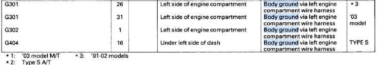

Posts: 6,911
Likes: 2,212
Yeah I'm a little worried about all the grounds lol where are all the ones I can't see?

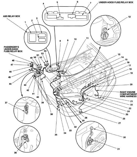

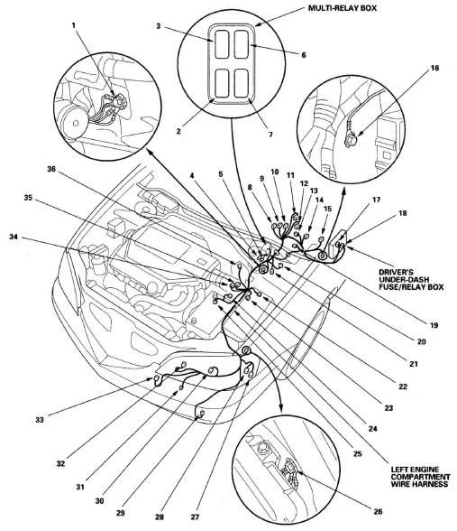

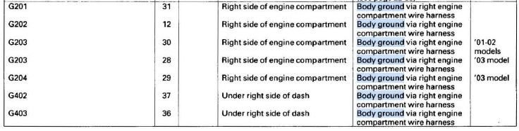

Right side:
Left Side:
If possible, take pictures of their condition when found.
