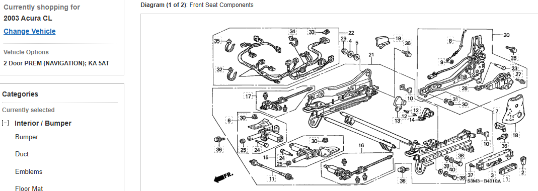

Maybe you can give me some insight. The driver's side seat does not go back and forward, does not adjust height, and the recline button only clicks. I first thought it was the slide motor but then because three of the 4 adjustments are not working, thought something else - so checked the fuses and all are ok. Maybe a coincidence or just haven't noticed all three adjustments not working. The only one that does work is the movement of the bottom seat tilting upwards and downwards at an angle. I searched everywhere for motors but none available from Acura or salvage. Mechanic told me to get the bottom of any driver side seat that works and he'll install the complete metal frame with motors without the seat, using my seat. I looked at the diagrams but it appears there is wiring in the back of the seat too so not sure what is the best solution. Since it's my wife's car and I usually don't drive it, I thought the most simple solution is to somehow adjust the seat manually and leave it alone. But even manually is a problem. Any suggestions?

Have you / the mechanic ruled out a faulty #3 power seat switch assembly below?
If so, then it appears only the #6 RR. height motor; #26 left reclining motor assembly look to be available.
Front Seat Components - 2003 Acura CL 2 Door PREM (NAVIGATION) KA 5AT

With that said, I just looked at my driver side seat, in the full 'rear' position, from the passenger side and it appears one may be able to still get at the two rear plastic panels (red arrows) that cover the bolts for removal. Though, it's not going to be fun. The front two bolts (purple arrows) securing the seat will be easier to access.
Every 'A' you see, on the diagram below, indicates a seat mounting bolt.
No matter what, if there is any work to be done to fix this issue, the seat is going to have to be removed.
