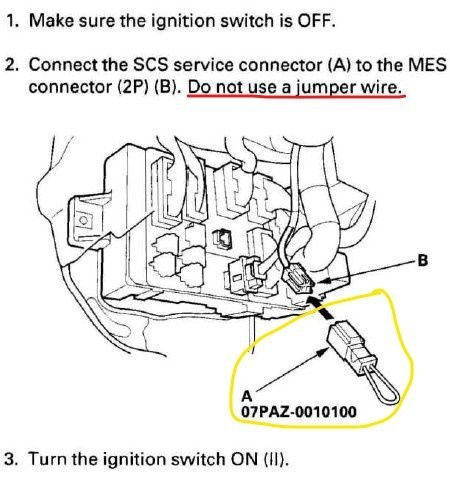

Sorry to hear. Shortly after purchasing my car in 2002, I would get a random SRS light that would come on. Took it to the dealer once, they said it could not be replicated, so no repair was done. When it appeared again, I researched it online and observed similar 'hack' remedies as you mention above.
Since I did not want to risk 'paperclipping' the wrong pins, I just paid the $10 or so and purchased the correct tool, circled in yellow, available via Acura / Honda vendors. I used it plenty of times when the drivers faulty buckle set triggered the light. I eventually got around to having Acura replace the buckle set for free under the lifetime warranty.
