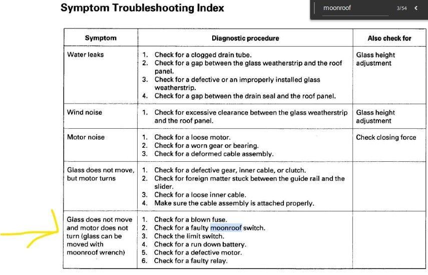

I don't know what to recommend other than what the Helms shows below, which I know you probably already referenced.
Good Luck.
Good Luck.
I haven't actually tried swapping out the switch itself, but I guess it's still worth a shot.
- Fuse is good.
- Limit switch, doubt it, and don't feel like peeling back the liner to find out.
- Not the battery
- Defective motor, doubt it. Doesn't whine or struggle at all. Even tried using my own strength to close and try to open for tilt. Nothing.
- Relays click
I also just discovered that the driver's power seat isn't working. Can't slide or tilt. The passenger's works though. Might be related?
