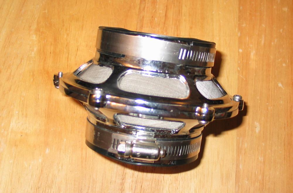

This one is definitely more “robust” then the cheap plastic AEM.

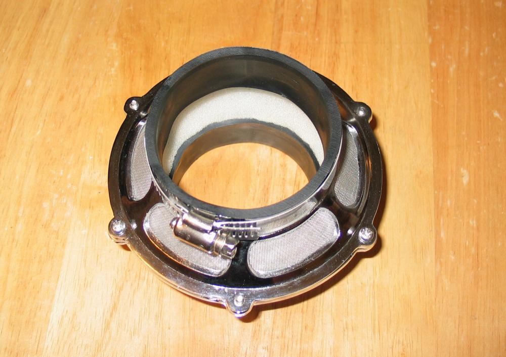

It's made of chrome plated METAL with a wire mesh and internal foam filter.

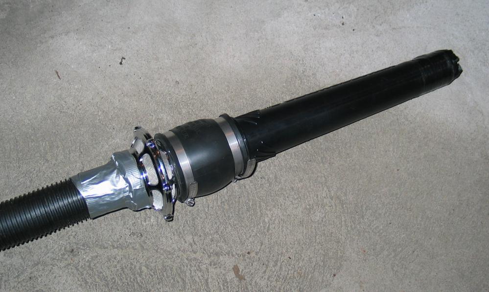

I’ll have the Shop-Vac, plastic pipe, duck tape and a bucket of water to see how this thing works.
I figured my AEM valve has been on this car for nearly 2-years and my 2001 for another 2-years and I was worrying about it failing.
Instead of getting another AEM I figured I would give this thing a try.
More pics and report to follow.
Shawn S

looking at the first one, i'd be afraid to put that on my car. the concern is the foam material that is inside of the "bypass valve" can get old and brittle and may disintegrate and be sucked into the engine.

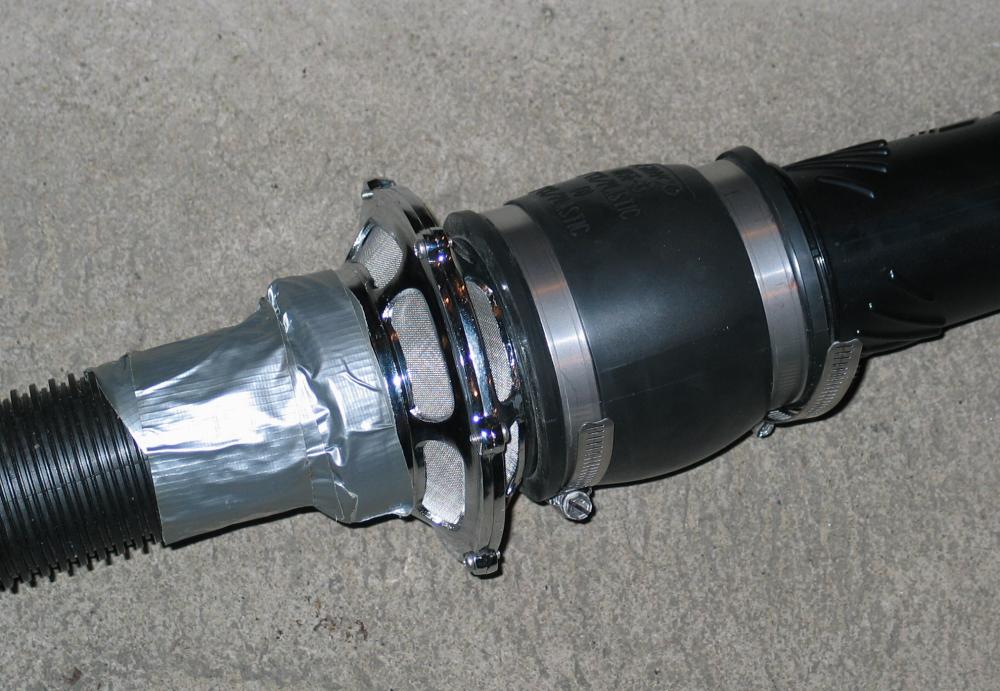

I see what you guys are saying about the new bypass ALWAYS letting in some air.
I thought this was discussed to death the last time we talked about it.
The flaps in the AEM are open whenever there is hard acceleration, so it’s not much different then the RTEC valve.
Anyway………
I did some unplanned running around today and I Zaino’d the wife’s RAV4 so I didn’t have time to install this sucker.

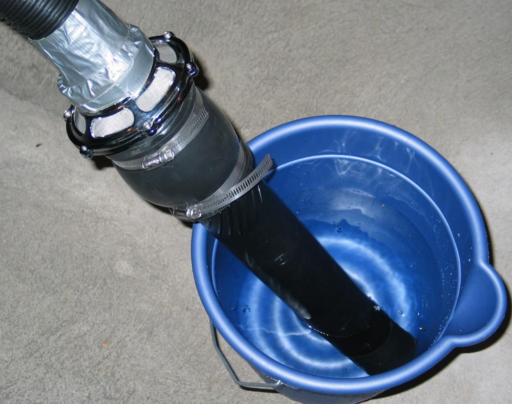

I did however do some tests to see if it functions as an actual bypass valve if the filter end becomes submerged in water.
While I’m not sure how closely the suction of a 30-gallon Shop-Vac duplicates an engine, it seemed to work just fine.
When the end of the pipe is open, I can’t feel much air being drawn through the RTEC.
When submerged in the water, there is NONE drawn up through the pipe.
Next weekend I’m gonna pull everything apart and clean my K&N filter and install this thing and see how it works.
