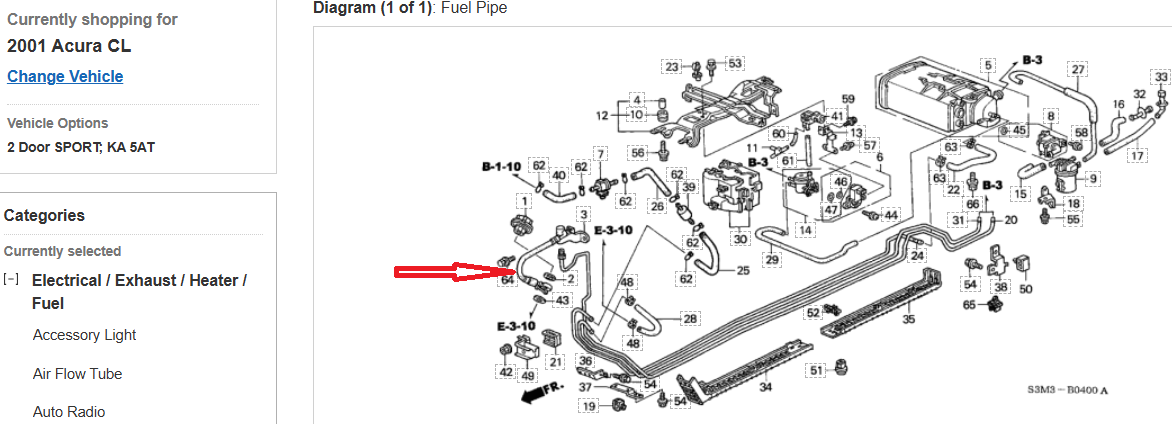

Which specific numbered item(s) are you trying to remove on the two diagrams below?
Fuel Injector - 2001 Acura CL 2 Door SPORT KA 5AT
Fuel Pipe - 2001 Acura CL 2 Door SPORT KA 5AT

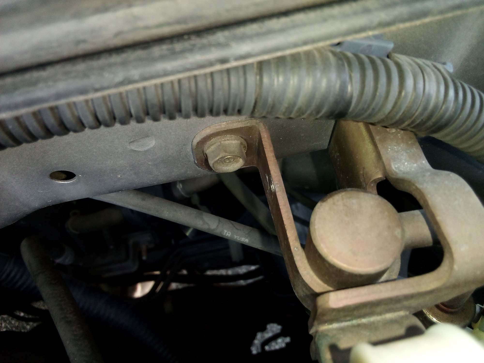

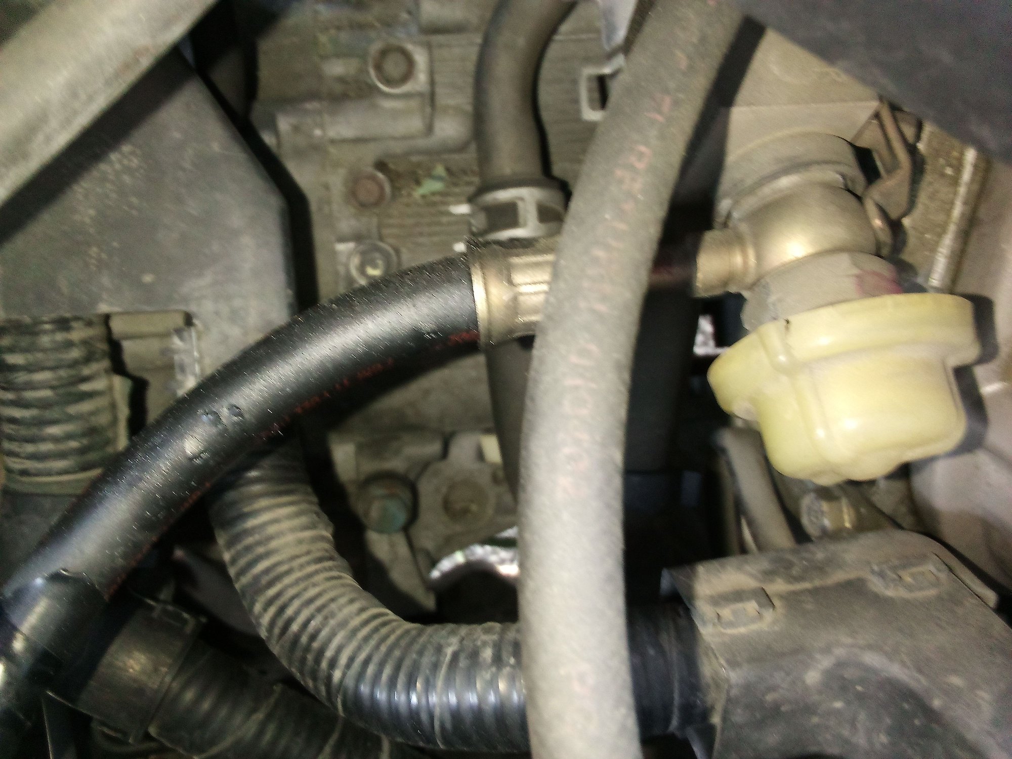

The second of your pics titled Fuel Pipe. After looking at the service manual, I think I’m calling it by the wrong name. Her are my pics, bottom and top of hose ends. You can see the fluid on the hose.

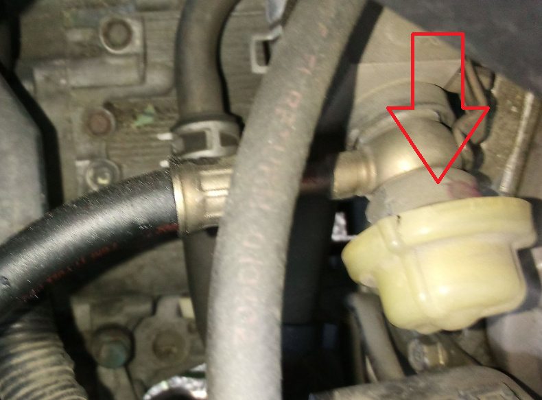

The #3 fuel feed hose A banjo end connection, under the fuel pulsation damper nut (red arrow), can be removed by loosening & removing the fuel pulsation damper & nut as reflected in steps 4,5 & 6 below.
You may want to have the #2 gasket and #43 washer on hand just in case as mentioned in the end 'Note'?
Disconnect the bracket from the fuel supply pipe at the bottom.
Then remove the firewall bracket bolts below.
