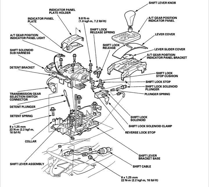

Does the floor shifter illuminate at night? If it "should" and mine does not - where to go to troubleshoot that bulb? Tips on disassembly?

Are you talking about the gate?
The 6-Speed doesn't, but I think the Auto does.

Yes sir - the floor "gate" which of course on a 2001 is an automatic. Looking down should the letters be illuminated - or is the expectation that the driver would watch the dash display to "know" which gear is being selected during hours of darkness?

Yep, it lights up. Check your fuses first.

Fuses are all good. Lights work in dash and the rear counsel. So- looks like I have to locate that bulb. Any suggestion or guidance out there? How the shift knob come off?

Did you happen to solve the problem? Im having the same problem with my 03 TL too. Thanks
