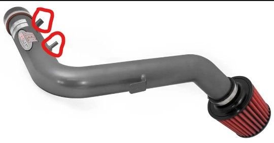

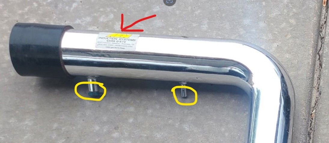

The red arrow shows it is an AEM, most likely an early version of the 21-509, and the yellow indicates the two ports connections needed for a CL-S6.

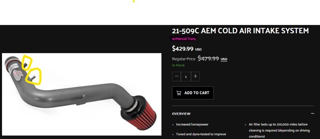

Furthermore, AEM's website shows the picture below for the 21-509 with two ports (yellow), 'w/Manual Trans', highlighted in magenta.

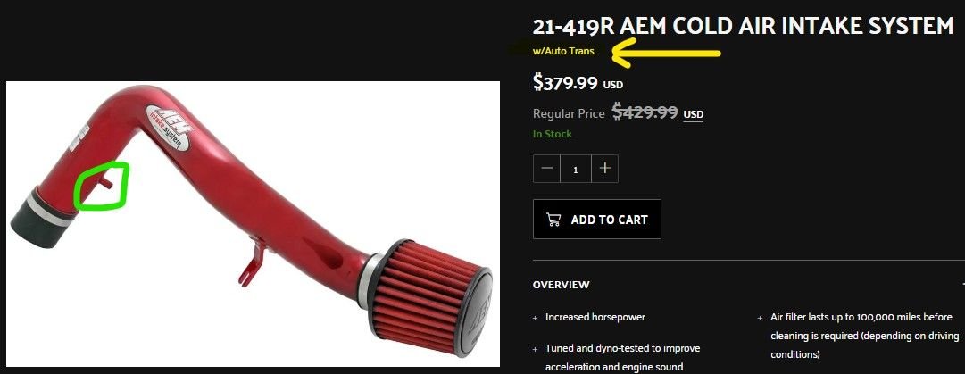

Finally, the AEM website indicates that CIA 21-419 below, with one port, is for the 'w/Auto Trans."; therefore, I would be more inclined to trust AEM's data versus Kingmotorsports website, make sense?
