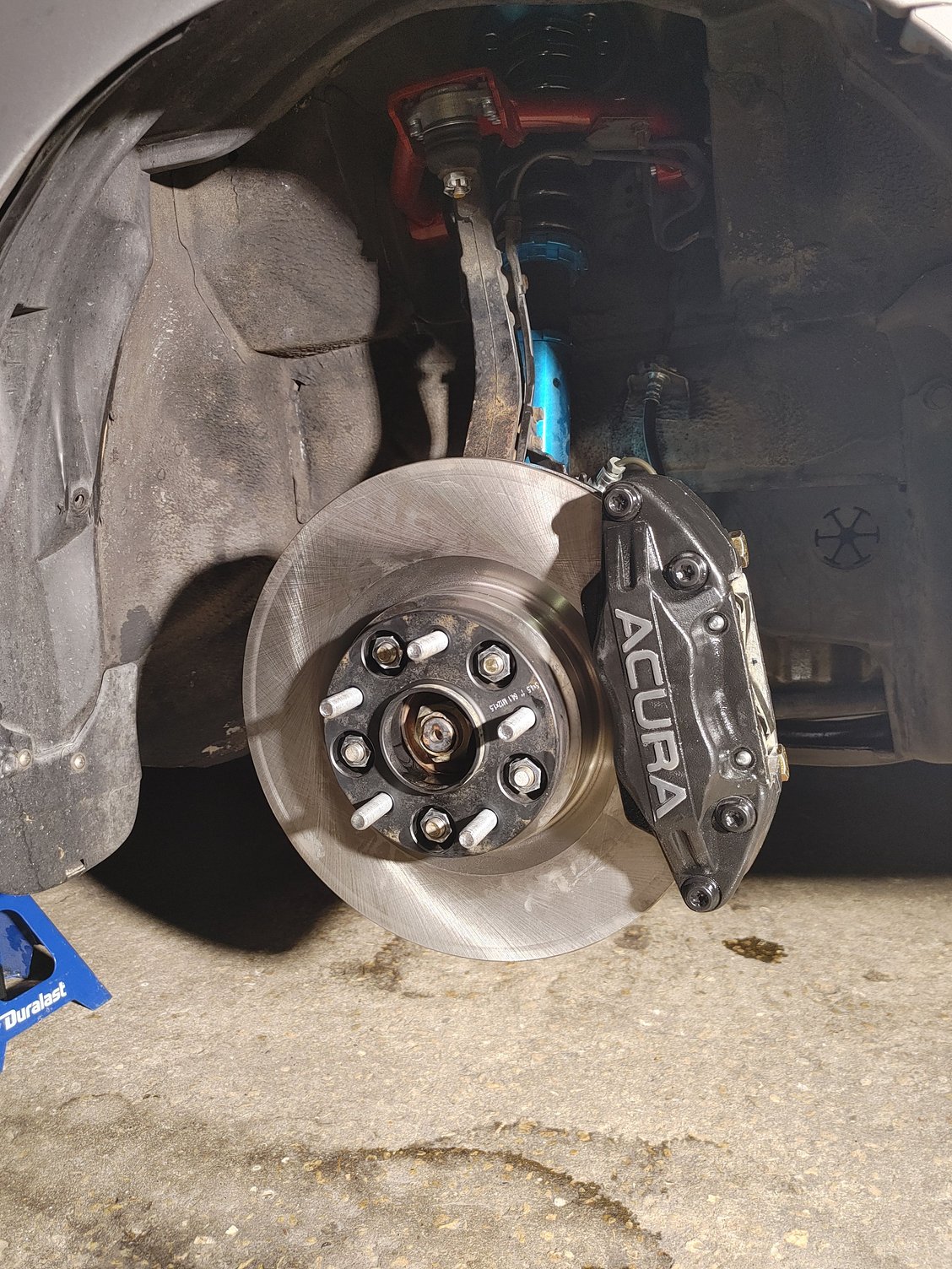

Keeping it short and sweet. Yesterday I installed RL Advics calipers on my 03 CLS. Had my buddy on the brake pedal while I opened the bleeders. Now I could have just been a little lazy, but I did not bleed the rear brakes. I went through almost a full quart of brake fluid over the course of 2 hours and 3 separate bleeds to try and let the air flow to the top of the calipers toward the brake bleeder, but I think air is trapped on one side of the 4 piston caliper, but there's only one bleeder. I ran out of time yesterday and the pedal was stiff enough to drive home safely, when i push the pedal to the floor, the brakes do lock the tires up, but the pedal feels soft, but the pads are definitely biting the rotors. I was able to do the bedding process for the pads I purchased with no problem. I'm just wondering if I'm being silly by not bleeding the rears also, if air is trapped inside of the calipers, or if the pedal is just soft for no good reason? I was doing the standard pump, pump, pump, pump, hold, bleed method.

do all 4 corners in this order:
Front Drivers side, rear driver side, rear passenger side, front passenger side

With that said, I just changed the 10 year old brake fluid in my CL-S6 recently. I gravity bled the two rear calipers first, (because they are the furthest away) then did the same for the two front legend calipers. It worked out well; however, it takes along time. In regards to your 'softer' feel with the advics, when I changed (around 10 years ago) to the two pot legends they felt softer at the pedal compared to the single pot OEM's, it may be as simple as that. Especially if you have no problem locking up the tires at this point .

For the RL calipers, I used 2005 Nissan 350Z Brembo rotors (324mm diameter) the only issue is making the rotor centered in the caliper and the correct diameter for the pads. This is a known working combination, so I'm just being safe.
