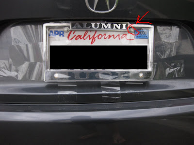

The red is where the affected area is. But the left nut is about to fall off also.

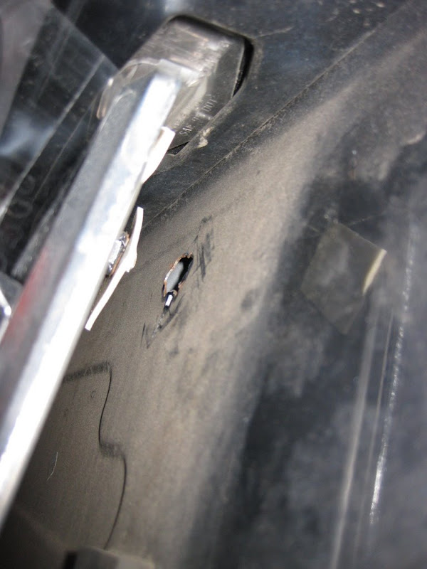

Here is the damaged area.
I'm thinking maybe I can drill a new hole and shift the license plate.. but it may look a bit awkward..

I would drill it out till you get a clean edge, then get some touch up paint and touch up the unpainted edges. Then I'd go to your local home improvement store and get a nut, bolt, washer, lock washer set up that fits through the plate and use that to keep it on. I'd also invest in a good washing, a clay kit, and some wax cause it looks like you could use it.

I'd try to round out the hole that's already there. Just make that one bigger. That way you don't have to relocate your plate which would look funny. If you don't want to drill into the car, you could get away with just cleaning up the edge that's already there with some sandpaper and touching up the inside area so it doesn't have any rust problems. Then just sandwich the hole between a couple of washers on your bolt and add a small spacer (probably just some more washers) to keep the plate in it's original position and not skewed and tighten everything up.
That is of course, unless someone else knows of a better way to do it.
