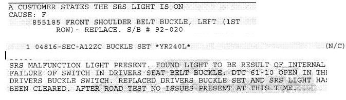

Hi: I had this problem where the SRS light would sometimes come on.
First thing to know is that for the 2004, there is a lifetime warranty! For later years, they changed it to 15 years/150k miles.
The OBDII showed "Fault 61-10 Open in the driver's seat belt buckle switch, Permanent DTC"
fyi-My mechanic said that the airbag will not deploy if the SRS light is on.
ACURA replaced it at no charge.
