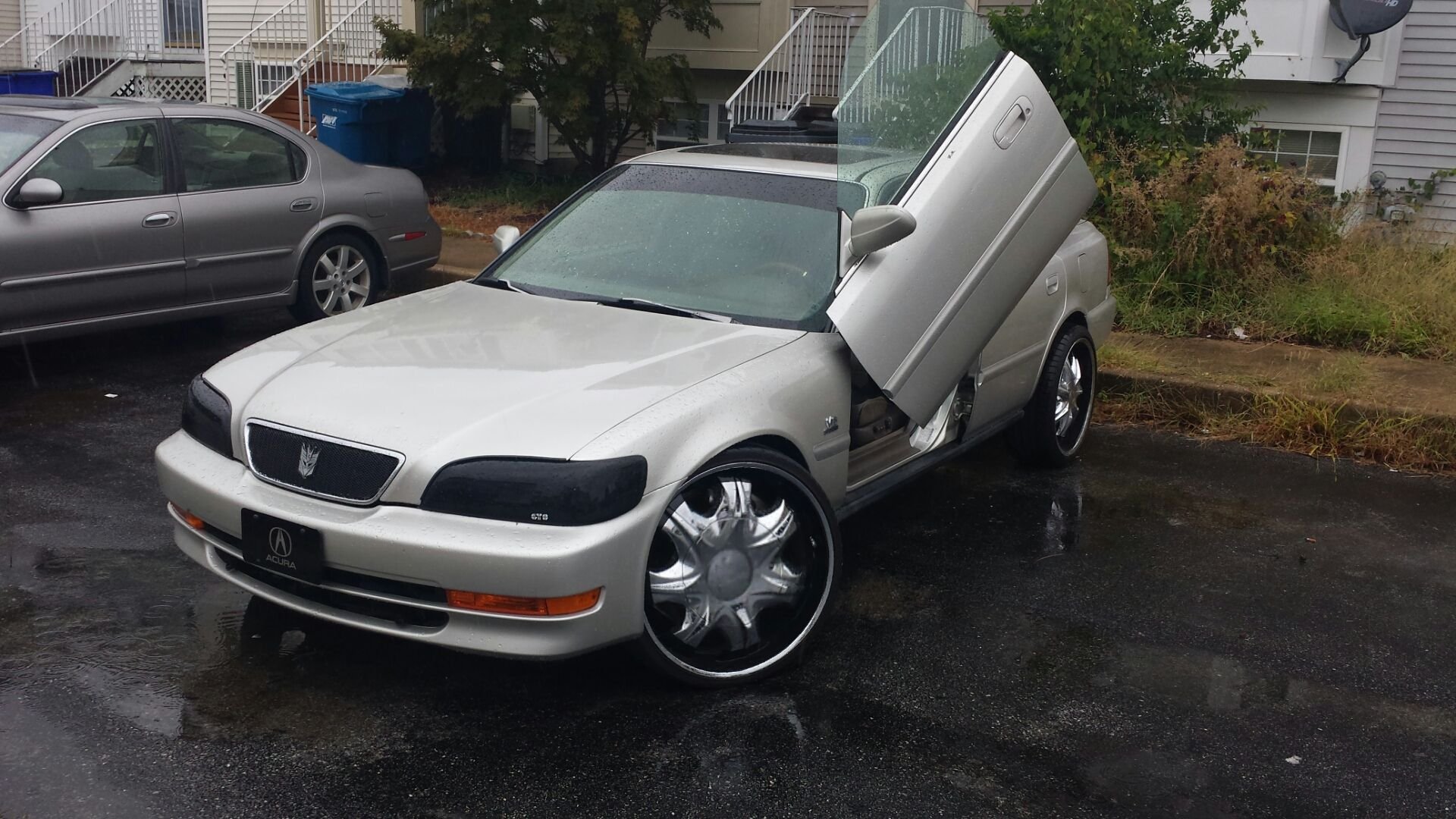

Have you ever seen the acura with the butterfly doors,
STuntin' is a habit, get like me!
Sorry I cant be of help, but growing up in that time period with butterfly doors, I kinda like the look on the Ack!
