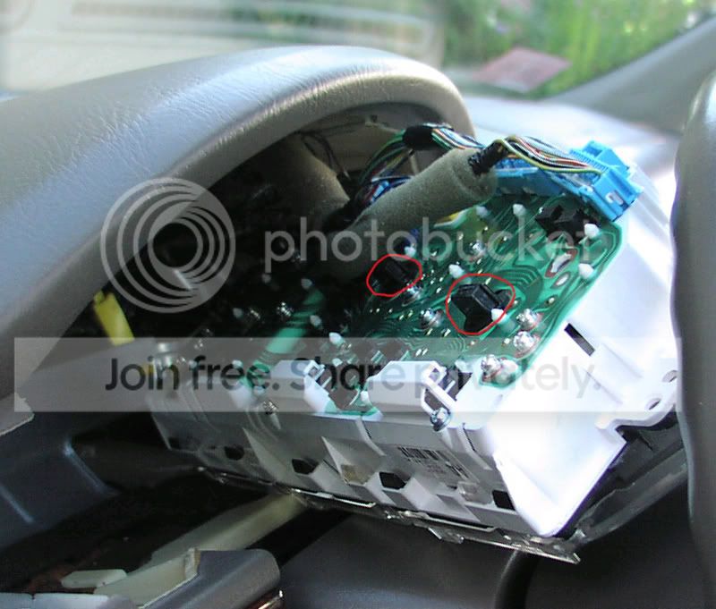

Old Feb 22, 2007 | 04:23 AM
daemonicus's Avatar
Posts: 951
From: Milwaukee, WI
here's a picture of the back of the cluster. the bulbs circled in red are the ones that need to be replaced. there should be 6 of them and all you do is turn them to one side and pull them out.

Old Feb 22, 2007 | 08:14 PM
TLBaller's Avatar
Joined: Apr 2001
Posts: 4,784
From: Houston
Daemonicus: save this picture for future reference! It will come in handy for new members.

how does it look when you're done, i like the new RL guages, its a second gen guy that did it i think, i know it has to be some place in houston that makes custom guages, wonder how much it costs!!!!
Old Feb 23, 2007 | 02:27 PM
jumpoff78's Avatar
Posts: 16
I want to do a LED conversion on my dash gauges, anyone know what LEDS i need to purchase?

You need (5) 168/194 bulbs.... get the wide-angle kind.

I visited the Super Bright LEDs... sooo any of the bulbs that are replacing 194 and 168 should work correct?

Fairly easy, just have to disconnect the HVAC controls and the clock, then gently pry out the vents on either side. 6 bolts and 3 connectors after that, your gauge cluster'll be in your hands.
how many or which screws did you take out to get the cluster out.
Old Dec 24, 2008 | 11:13 AM
Go90go's Avatar
大日本帝国
Joined: Apr 2006
Posts: 5,321
Likes: 36
From: Double Standard Land
4 four the outer trim/vents, 4 more for the gauge cluster itself.
