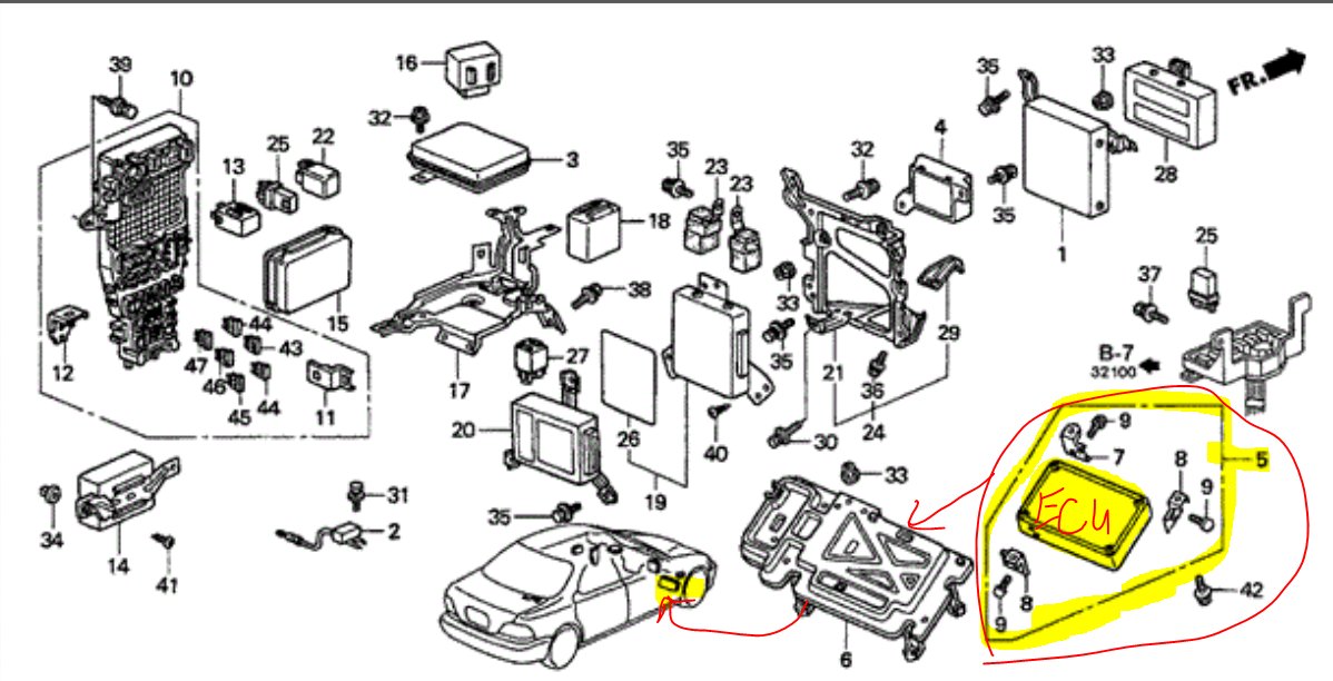

I couldn't find any refurbished ECU under $200 and didn't want to chance acquiring a used ECU from salvage yard. I decided to remove my ECU and check if a capacitor was bad or not. It was easy to remove once I found where it was located as I thought it was under the radio like newer cars but luckily found diagram showing under carpet on passenger foot area.
ECU diagram

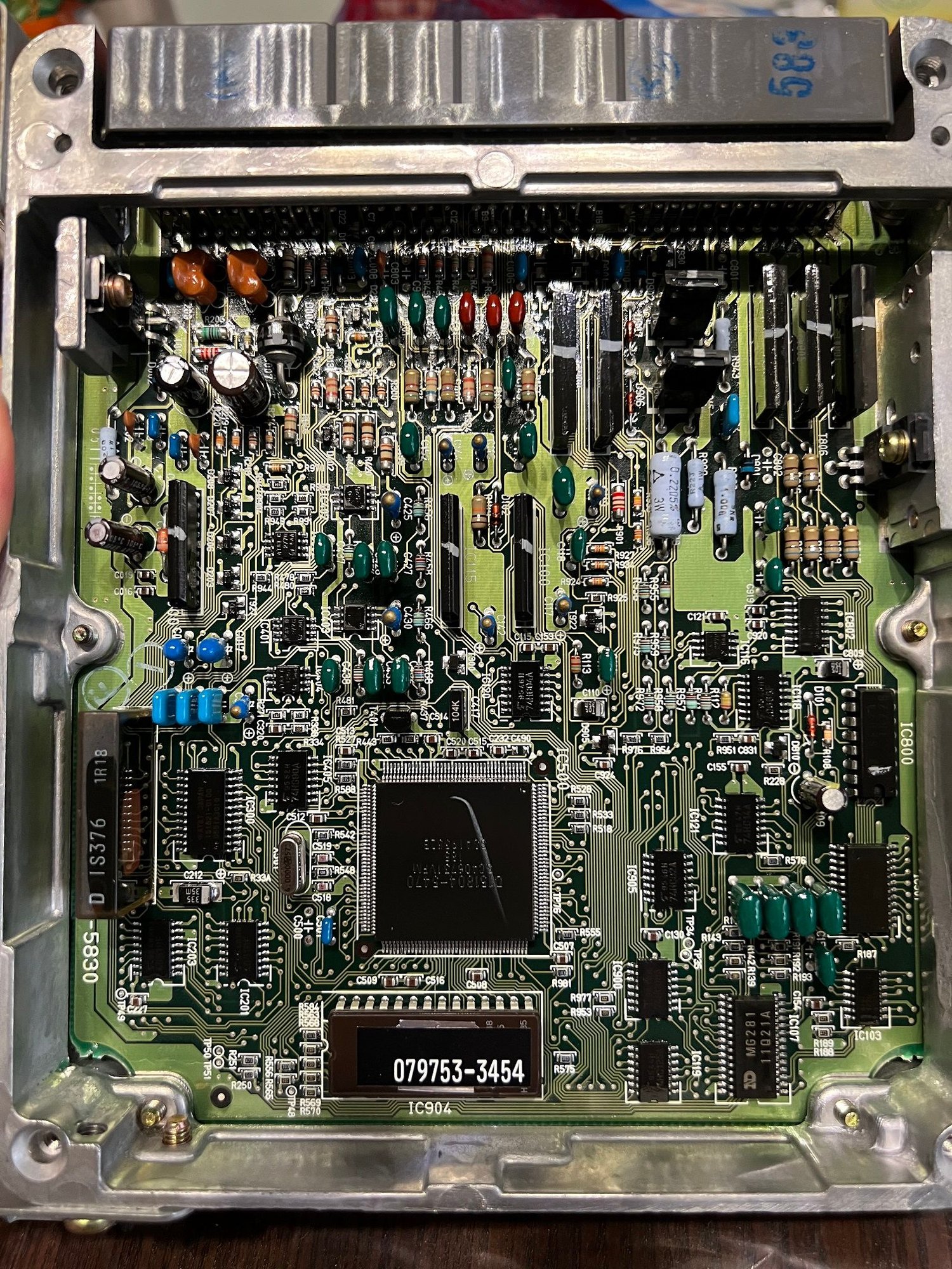

Never opened up an ECU before so included some pictures of the unit.
ECU unit
Front side of ECU board
Rear side of ECU board

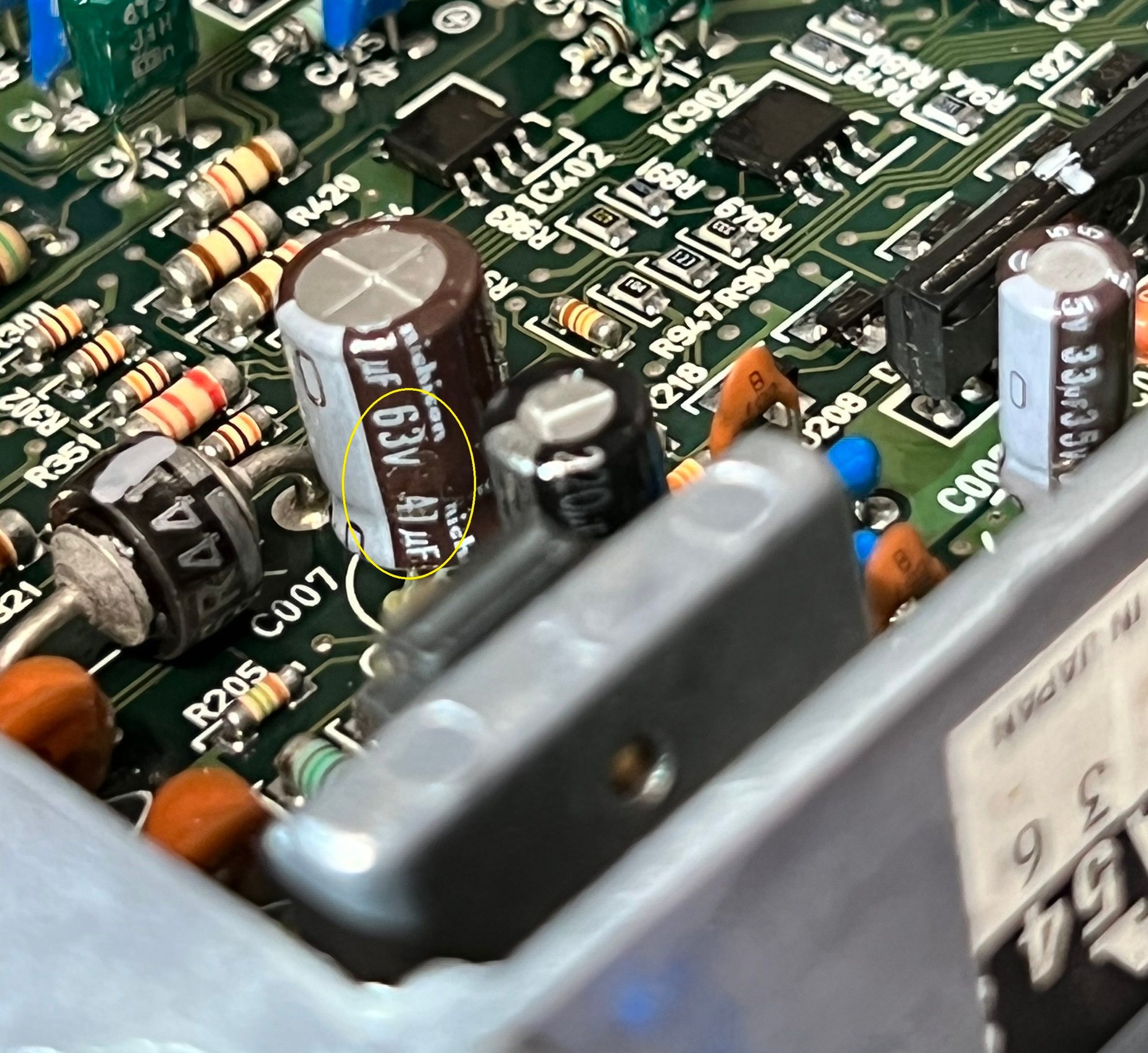

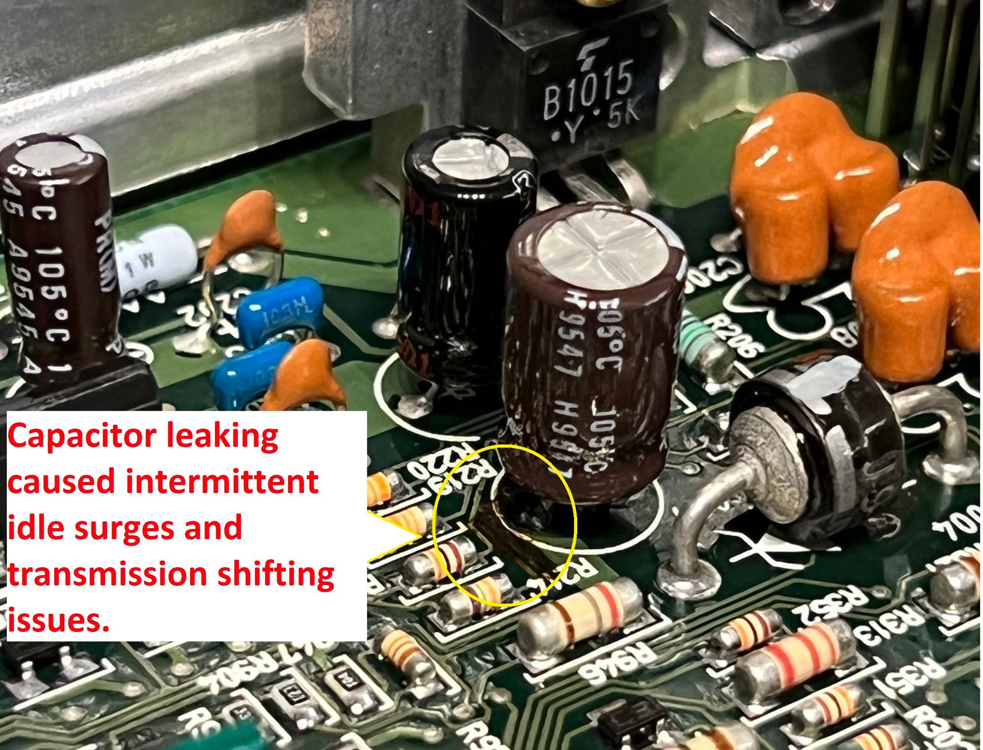

You can clearly see that one of the larger Capacitor was leaking onto the board. Luckily, the board wasn't damaged too much as I was able to use alcohol to clean up the leak area okay.
Leaking capacitor

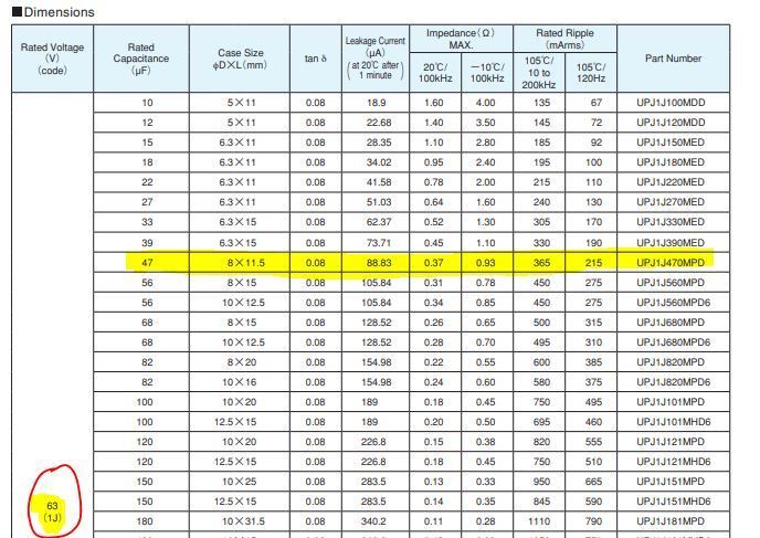

I couldn't find an exact match for the Nicochin capacitor so went with UPJ1J470MPD from Mouser with same 63V, 47uF, 105degC ratings.
De-soldered bad capacitor and cleaned up board some more to remove excess solder and used heat resistant tape to tape over traces to prevent further damage if new capacitor were to ever leak. Had to remember the negative side (white stripe) needed to match up to the negative sign on the board before soldering new replacement capacitor. Reinstalled repaired ECU, hooked up wires and fired up the engine crossing my fingers that it would fix it. Engine warmed up and then idled low as usual with no more surging. Let it run for 10mins before taking for test drive. No more hard shifting from transmission and it now shifts at usual lower RPMs. All is well now so saved me money from taking into shop to have it diagnosed with costly bill.
