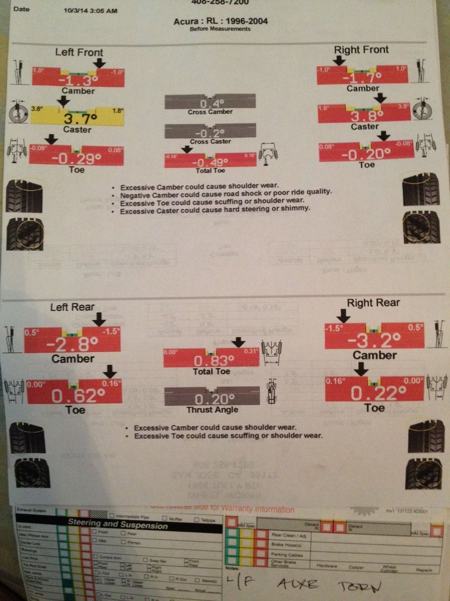

Do I really need a camber kit? I read some where on the web that you dont really need it. Anyway, I just had an alignment done and it pretty much out of spec. I'll try to post pictures.

Holy hell your toe is crazy lol!

Lol, did you look at the second picture? That's the one before an alignment was performed. In the first pic the toe is in green so I'm guessing its alright hahaa.

LOL yea I was looking at the second one. I'll reference one of my old alignment specs when I get home and compare the two. I've been changing my alignment setups and now I think I got it to where I want.
