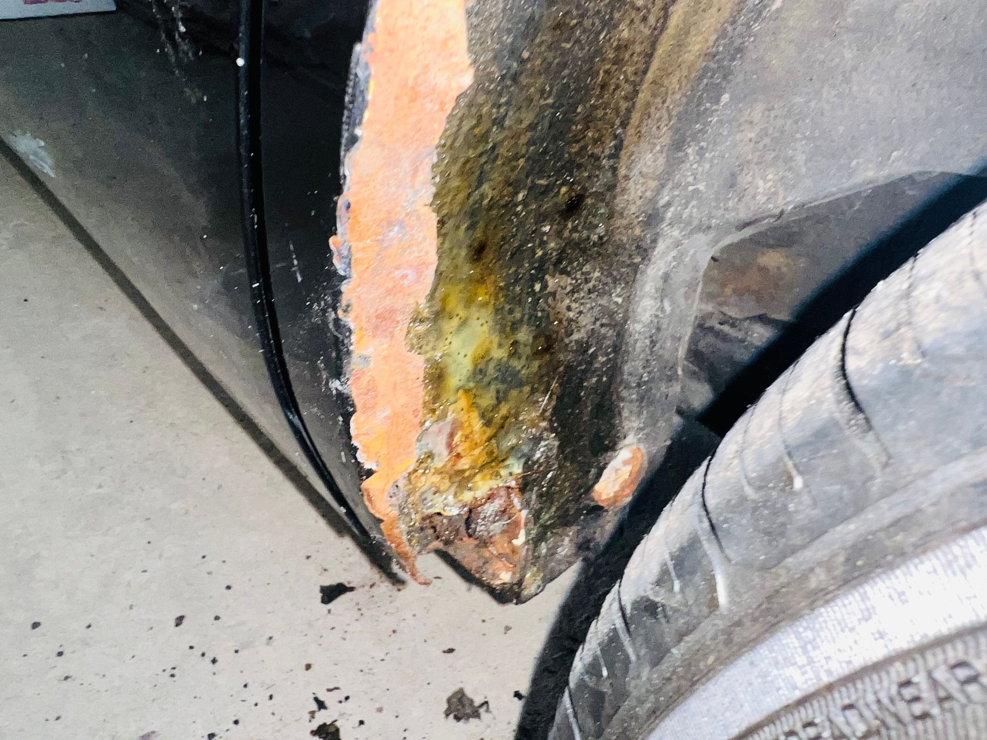

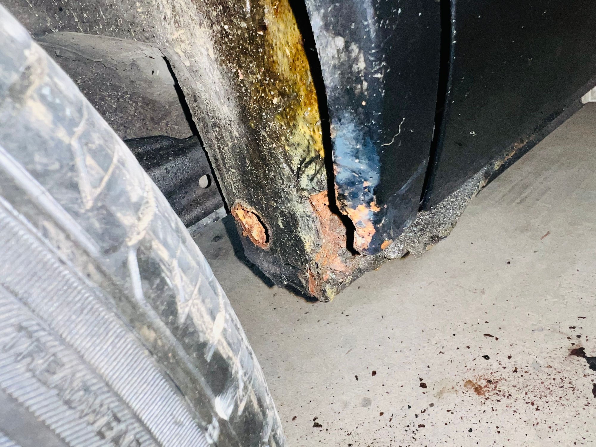

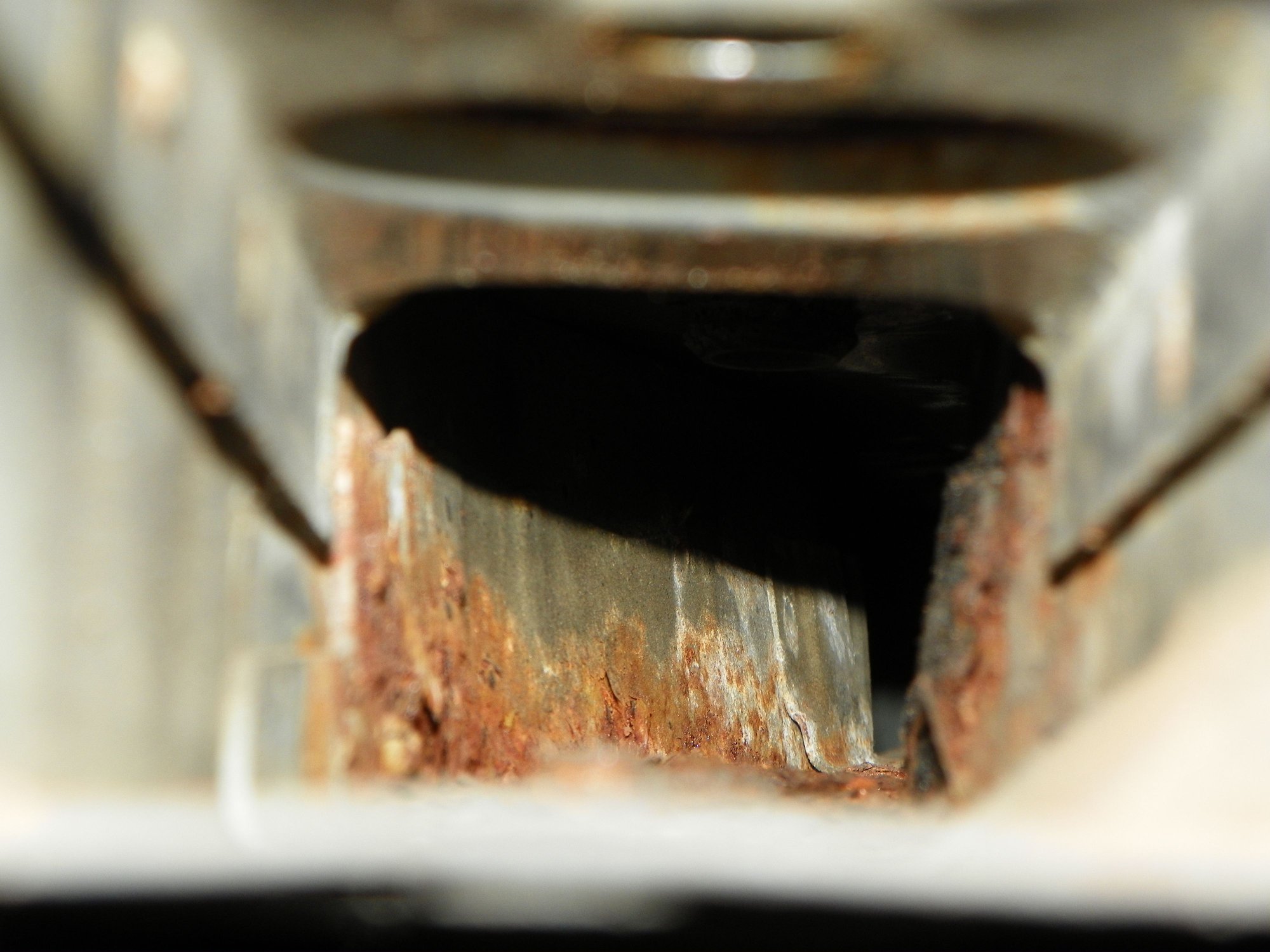

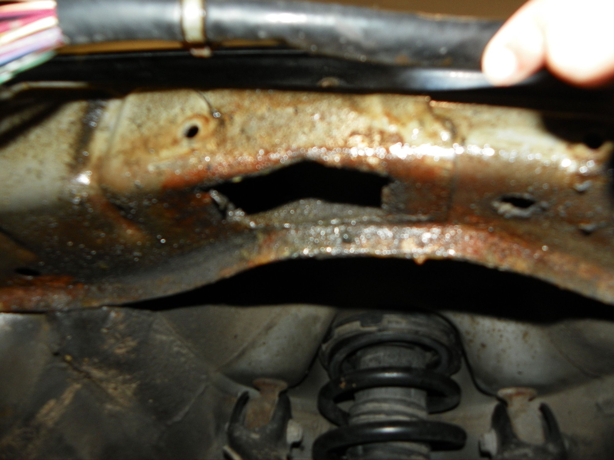

Attention KA9 owners. Check for rust above the front splash shields in the front wheel wells. For some reason, it seems they weren't galvanized from the factory and the splash shield has a hole designed into it that allows salt and all kinds of yuck to be sprayed all into it. As a result, these seem to be a rust-prone part that goes unchecked due to its weird location and poor access. Attached are low-quality pics. High quality pics will come later tonight.
Left side. Identical on other side.
Ditto.
Ditto.

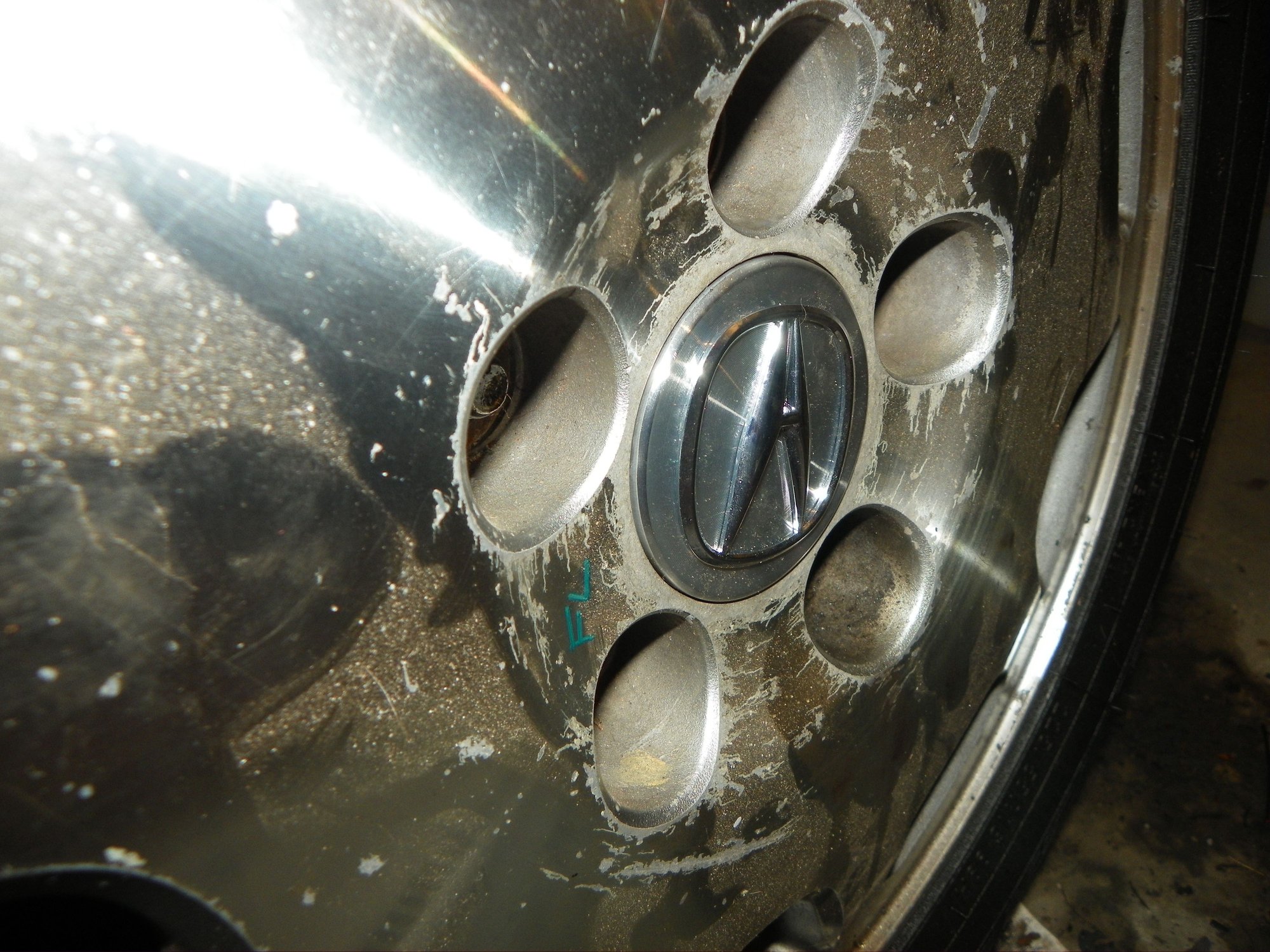

Here are the pics. The ILX's machined center caps fit perfectly and look nice. The emblems are also much easier to remove should the bare center cap need to be machined or waxed.
Left Side
Left Side
Right Side
Right Side
Used a drill with a wire brush attachment to clean some of the rust
ILX center caps. They look nice but dont sit flush like the originals.
ILX center caps. They look nice but don't sit flush like the originals.

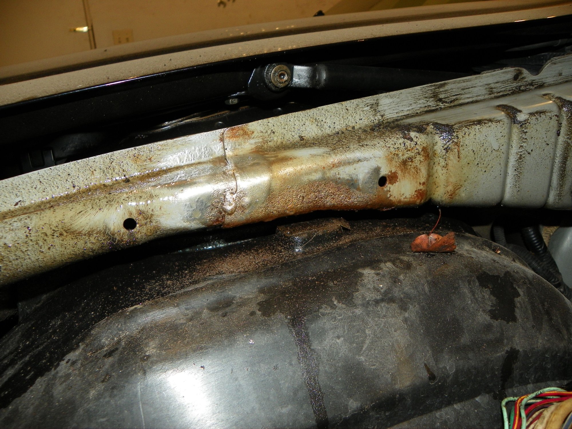

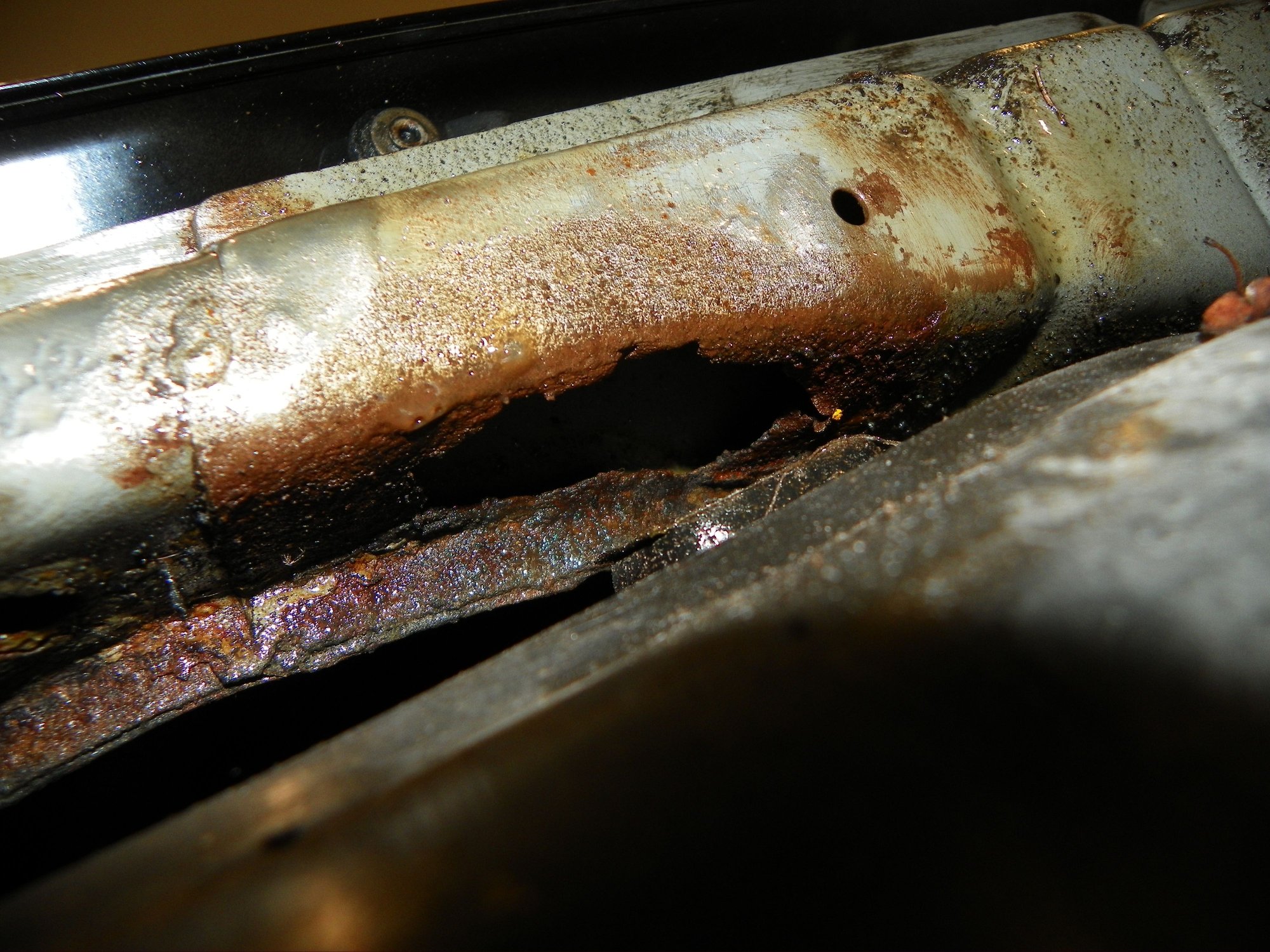

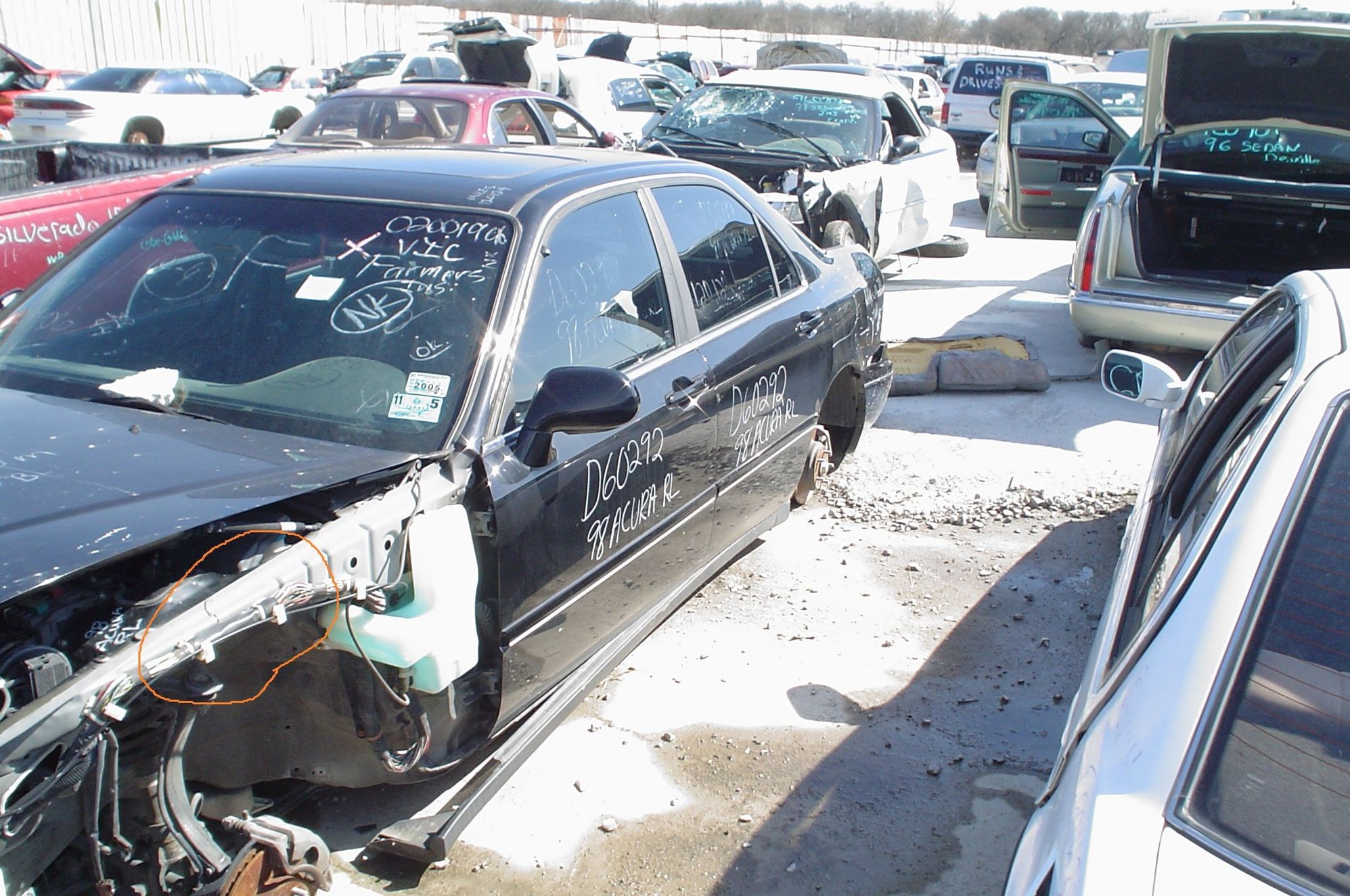

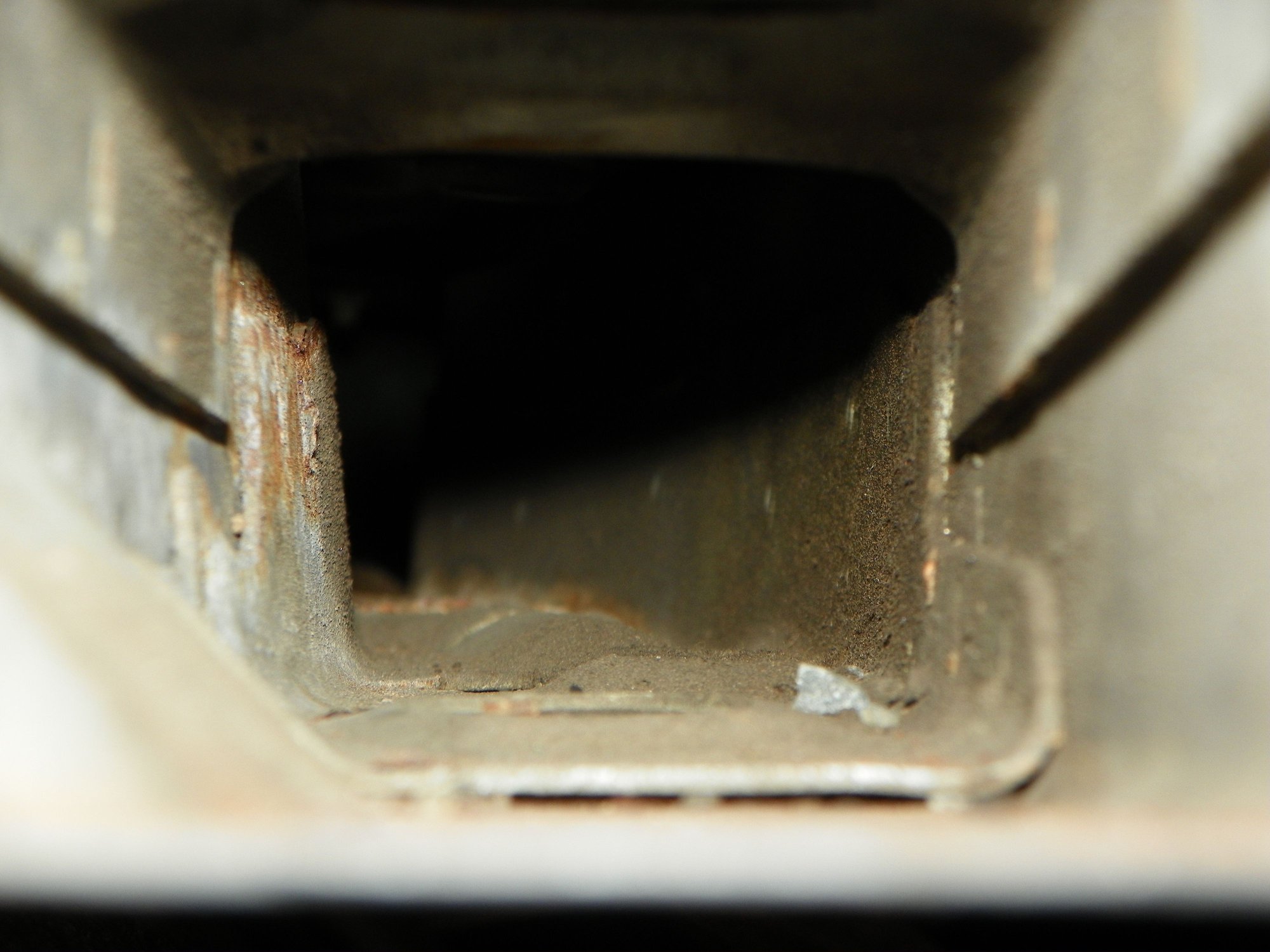

It is the crash structure under the front fender. For some reason, Honda didn't galvanize them and the splash shields conveniently have a hole right about where the 2 parts of that structure meet. If you take off the splash shields in the wheel wells, they are at 12:00.
Circled in orange
Circled in orange

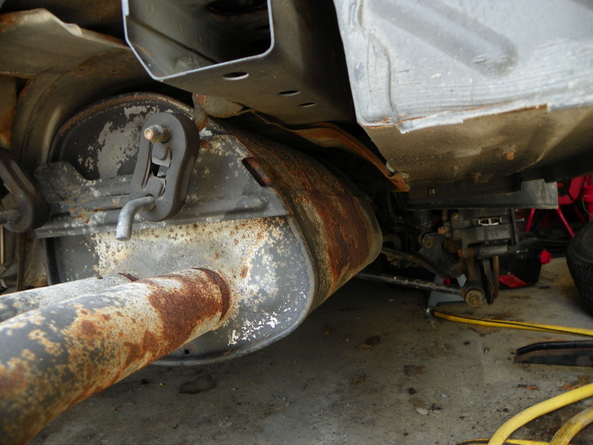

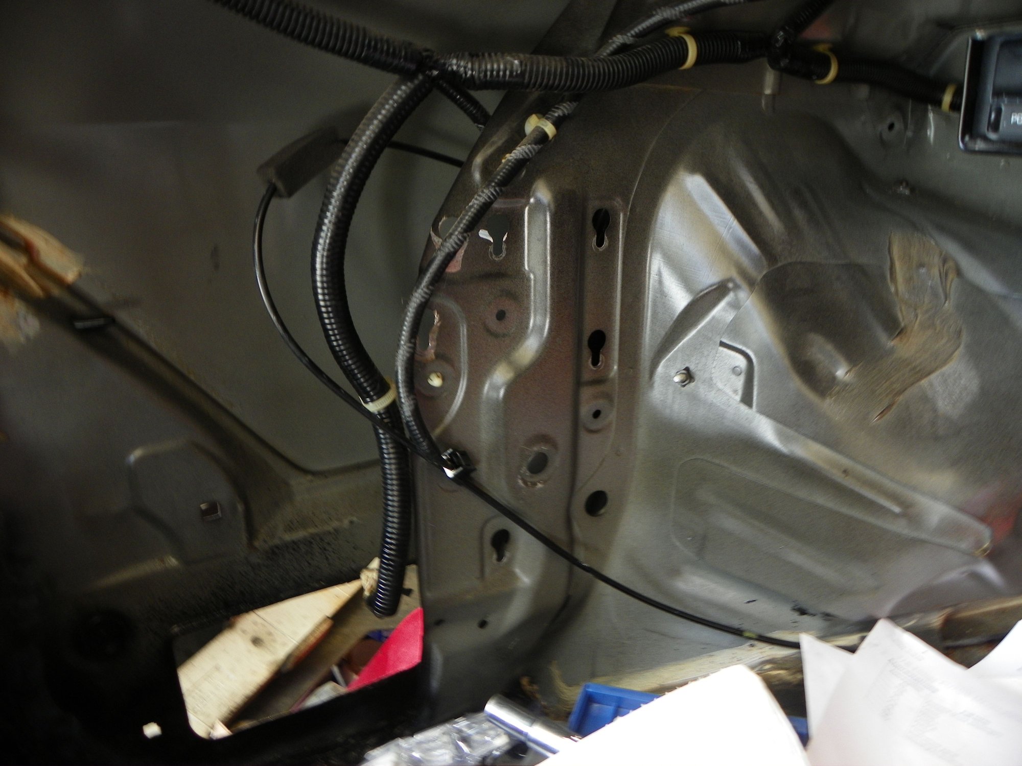

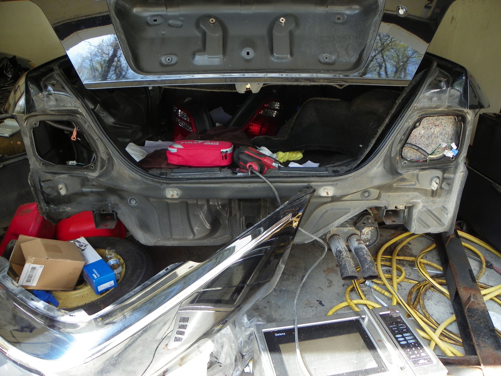

Been a minute. Did a few things. Mainly, I'm working on remaning the alternator, and continuing to strip the rear end.
NHBP is great.
NHBP is great.

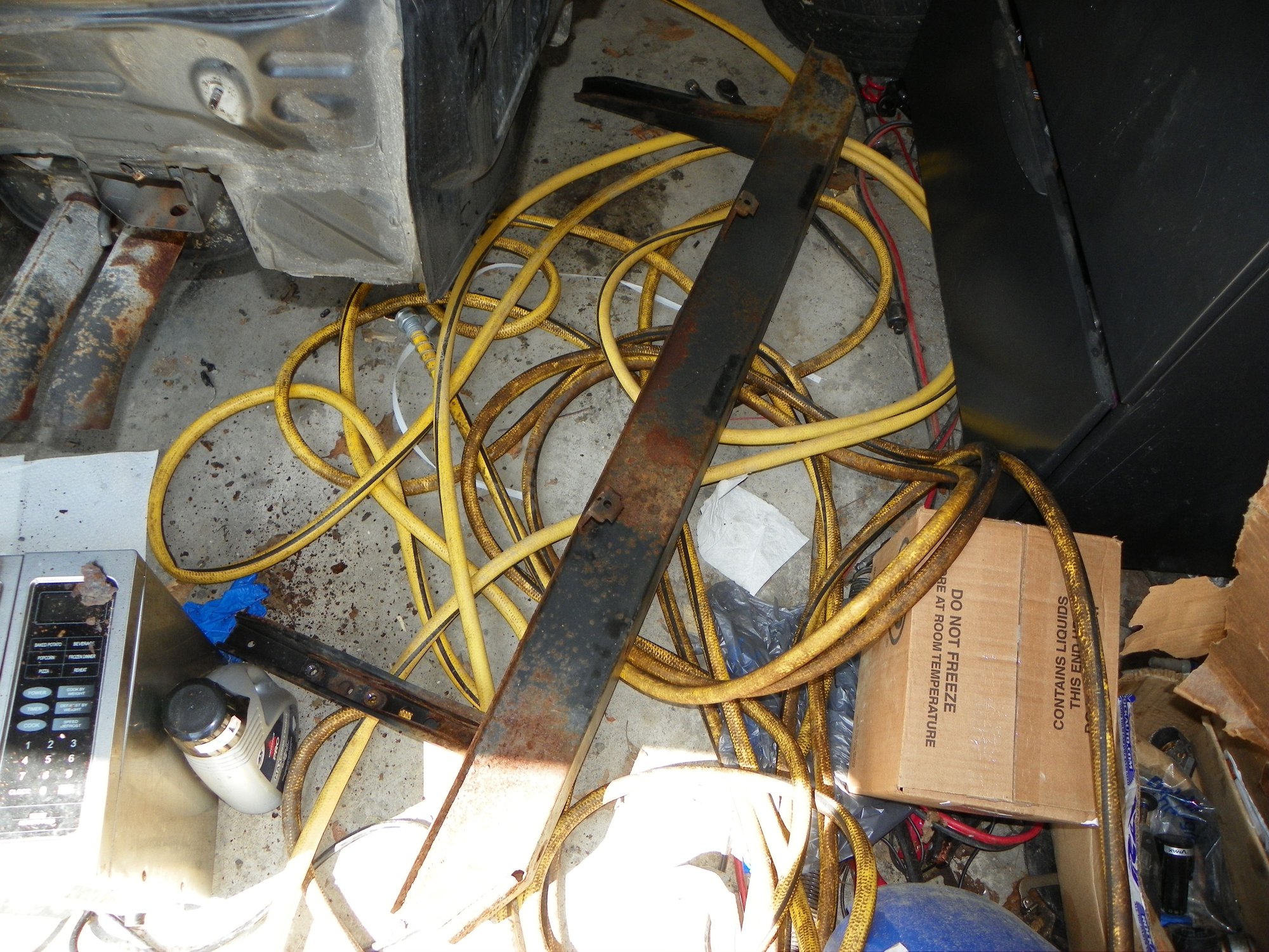

Crash bar removed. Plz ignore the mess. Gonna spend the afternoon cleaning it.
She has seen better days.

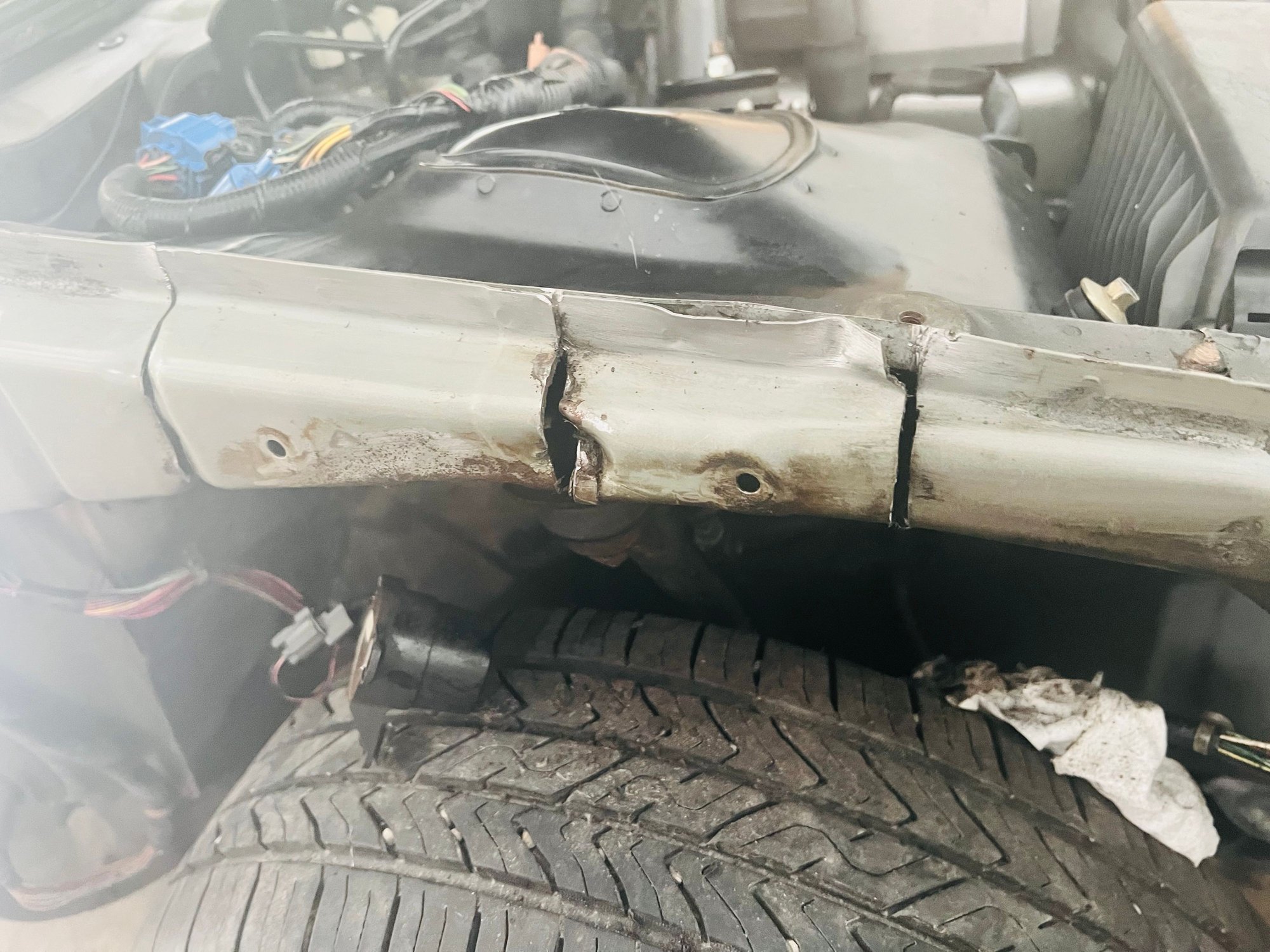

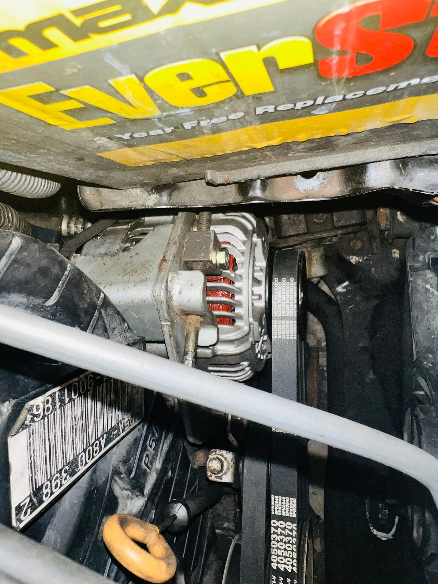

Life happened. Anyways, I replaced the alternator with a Ebay reman because almost every single part of the original was broken. Also, I found some new rust in unexpected places… Lovely. I started to cut into the front right crash structure. Some of it is mild and some of it is high strength steel.
Check behind the plug. Rust hides behind there.
Crash structure on right side.

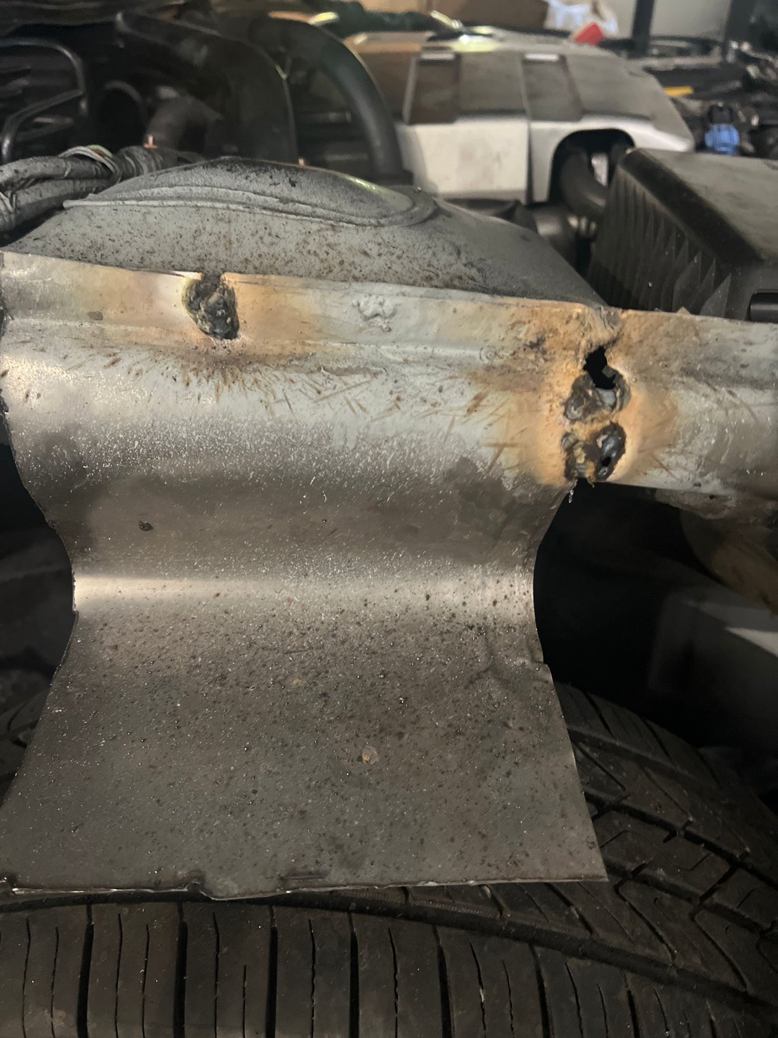

Life got busy. I’m using flux core to hold the piece to the body so that I can shape the part. Then once that is done, I’m gonna mig it off the car and then mig it on the car. I’m also gonna start to recap the amp and headunit.

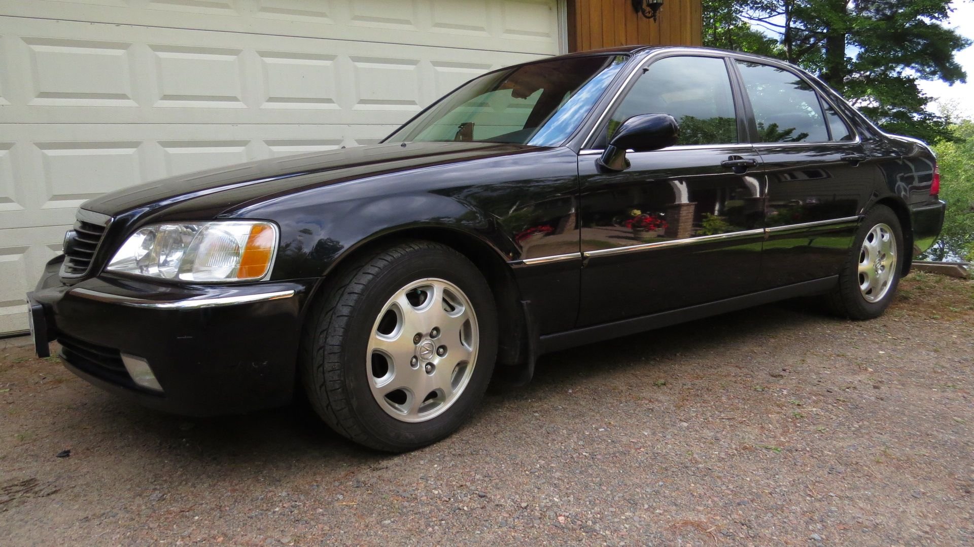

@1186KA9 Had to admire your perseverance and dedication to the restoration of your '04 RL. Happy to know that completion of project is near and you'll soon be cruising down the hiway w/a big smile on your face. Please post a picture of the final product.
The RL is such a great cruiser and I'm still using my '00 @ 175k miles. Its been relegated to sacrificial winter duties from 2019 to present as its garage queen status for said period had been taken over by a '16 Lexus NX.

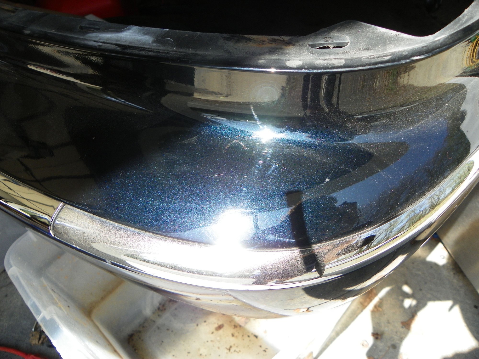

Picture taken in 2021.
