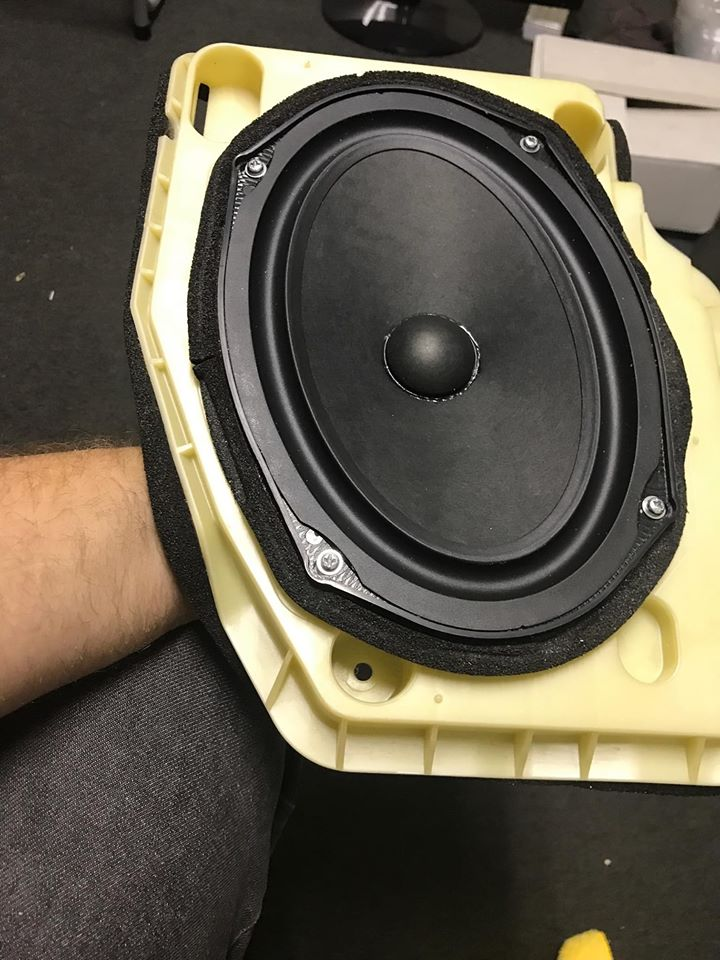

With the tape deck dead and the CD changer on its way out, I figured it was time to drop off the RL with my good friend Jamey Rawlings to get started on the audio upgrades in my RL.
First was to strip the center stack of the factory nav and radio to fit in a blank plate and custom mount an Alpine iLX-309 Halo 9 headunit
Get the doors stripped and cleaned of 20 years of build up for sound deadening
Focal Access 2 way components going up front
Focal Access 4" coaxials going in the rear doors in a custom baffle
Hybrid Audio 6x9" woofers going into the rear deck... again in custom baffles

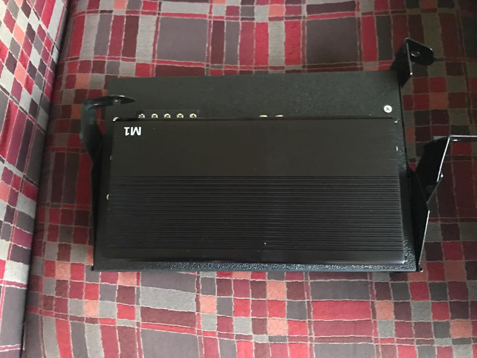

Tru Technology M1 and M4 custom mounted into the original Navi DVD drive bracket

Also, i'm used to a 4.1 system. how did you wire your speakers? i see you disconnected the tweets but you have 6 speakers with the doors and back deck. i'm assuming the M4 stands for 4 channel and i was surprised you did not use a six channel amp. They seem to be older units (looked at the website) so i'm assuming you had them kicking around.
Speaking of the amps, mounting in the Nav DVD tray was cool, i don't have NAV but if i happened to be lucky enough to nab one from a junkyard i imagine it would bolt right in to my car. Then it would be a matter of finding amps that also fit into it. It's an idea to play with.

I hear you on the dumbass Governor part. Not a whole lot better here in CA. We're pretty much on lockdown 2.0. Haven't been at work since mid-March. As far as the sub-box, no molds. This was pretty much a 1-off built in the car. So, the fronts are Focal Access US 6.5" components and they come with their own crossover network which takes up CH 1 and 2 on the M4. the rear doors are Focal Access 4" coaxle that take up CH 3 and 4 on the M4. The rear deck and the sub are powered off the M1. The Tru Technology amps are very underrated amps in terms of power on a spec sheet. If I were to have gone with a single 5 or 6 channel amp, I wouldn't have had the power I needed per channel (M4 is suppose to be a 105wx4 @ 4ohm, mine scopes out at 143w x 4 @ 4ohm, drastic difference). Most 5 or 6 ch amps on the market are pushing about 75w x 4 + 300w x 1. Focals LOVE power and just sound better when you can give it to them. But least to say, this is a "simple" setup, but difficult to get tuned right since the rear deck and sub are being powered by the same amp, but have about 3 feet of distance between them which makes time alignment difficult.
